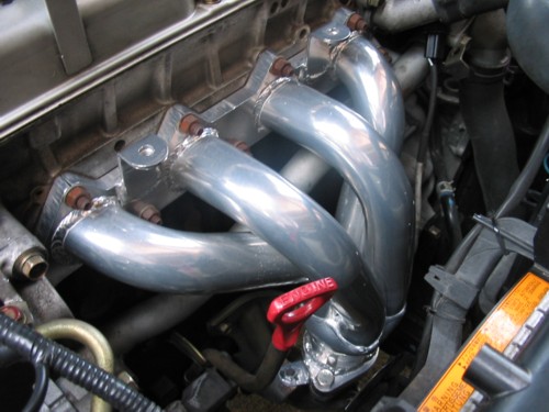

Old Jan 1, 2004 | 11:55 AM
pumpdog720's Avatar
Posts: 1,571
From: Daytona Beach, FL
Well I put it on today! It is louder like everyone has said around 4-6k RPM. It suonds good below that though with my exhaust and intake.
It does feel a little better in performance though! So that's good. I will take some sound clips later if anyone wants to hear some.
