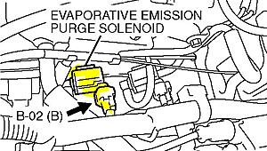

I'm actually talking about the one that's on the intake manifold.

Sorry bout that, it's MR507781. From the looks of it, there's only a few parts houses that have those, the rest are overseas.

Thanks for that. Looks like Dodge has the same part number for what seems like the same part. I just haven't found a picture of it to determine if it's the same part. Anyone know if the Mitsubishi and the Dodge part would be the same?

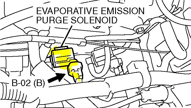

Originally Posted by 02modlanceroz
Is that the Mitsubishi or Dodge part?

http://www.partswebsite.com/courtesy.../MR507781.html
This is probably what you need
Old Jul 3, 2014 | 03:30 AM
RT78's Avatar
Joined: Mar 2014
Posts: 194
From: Upstate NY
Yep, that's it
