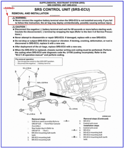

If i find a used moduel do you know if the dealership can program it to work in my car?
Old Aug 6, 2014 | 05:49 AM
viprez586's Avatar
Joined: Jul 2014
Posts: 67
From: New Berlin
They should be able to reprogram it. Here is the process for a 09 Lancer with the 4b12 engine. It should be the same for all engines.
