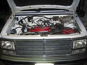

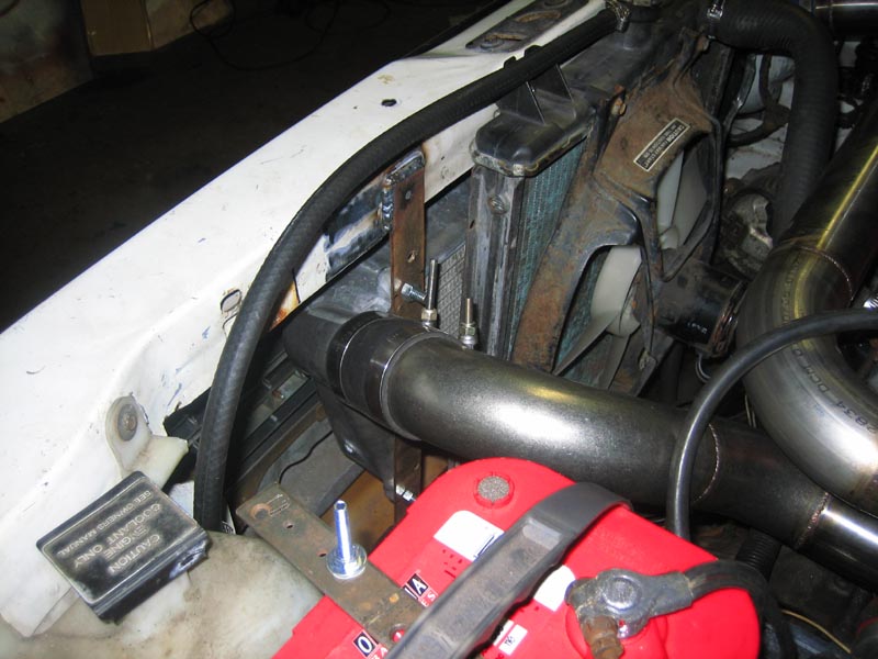

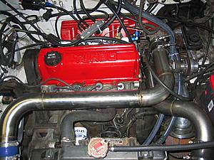

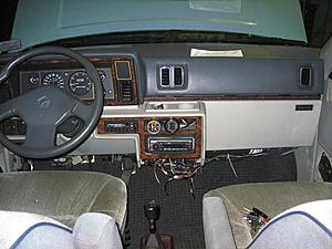

pics as promised
mods are
2.5L A555 w/ chromoly transplate revlok II clutch
TU fuel rail with +40's
3 bar map
FWD Stg 5 cal
Forged pistons
ARP everything
G-head
TU exhaust manifold
T3/T4 Turbonetics 50 trim with stage 2 turbine
.63a/r turbine housing
TU 3" swingvalve and downpipe
Accufab FPR
Walbro 255 fuel pump
Stainless steel intercooler piping
Small NPR intercooler
Forge BOV
Innovative wideband guage/controller
Turbo XS dual stage boost controller
180 degree thermostat
Balance shafts removed
A/C delete bracket
Daytona springs/struts in the front for a drop
still not at 100%...got some cleanin up to do.
