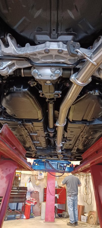

Dealing with rust on our Evo's can be counter-intuitive. I want to believe that there is a permanent solution that makes rusty metals never rust again. But no, as long as the metal is not alloyed to resist rust, there is no chemical or physical treatment that can permanently prevent it. Like Repair Geek said, the rust-preventive spray is like an engine oil. You can choose the best brand of engine oil, but if you don't change it periodically, the engine is not going to last.
As my Evo X has become a rusty old dog, I recently did some research and reading about car rust and how to suppress it. Here are a few bulletins that I would like to share:
▪ Do not try to prevent rust permanently. It is impossible. Instead, apply a proper rust-preventive spray every year or so.
▪ "Permanent" treatments like CrN PVD or Cerakote are only appropriate on metals that won't rust, like stainless steel or gun barrels. If they are applied to car frame, they will only trap moisture inside and cause rust underneath, which will be costly to fix.
▪ Lanolin based rust preventives help displace the existing moisture hidden behind rust.
▪ Avoid the rust preventives formulated to stay on for years after years. Those will harden when the solvent vaporizes, and stop creeping and actively displacing new moisture.
▪ Favor the rust preventives that do not harden and need to be renewed annually, like fluid film. They will creep and continuously displace new moisture, which is why that the Navy uses it on their F/A-18E/F Super Hornets:

I used POR-15 on the underside of Rust Bucket. My friend that has done paint and body work his whole life recommended that it would be the best option. It was extensive work to remove everything and prep out the undercarrage. But it has been over a year now and it is still looking good. No chipping, peeling, or flaking just an amazing powder coat like finish.
