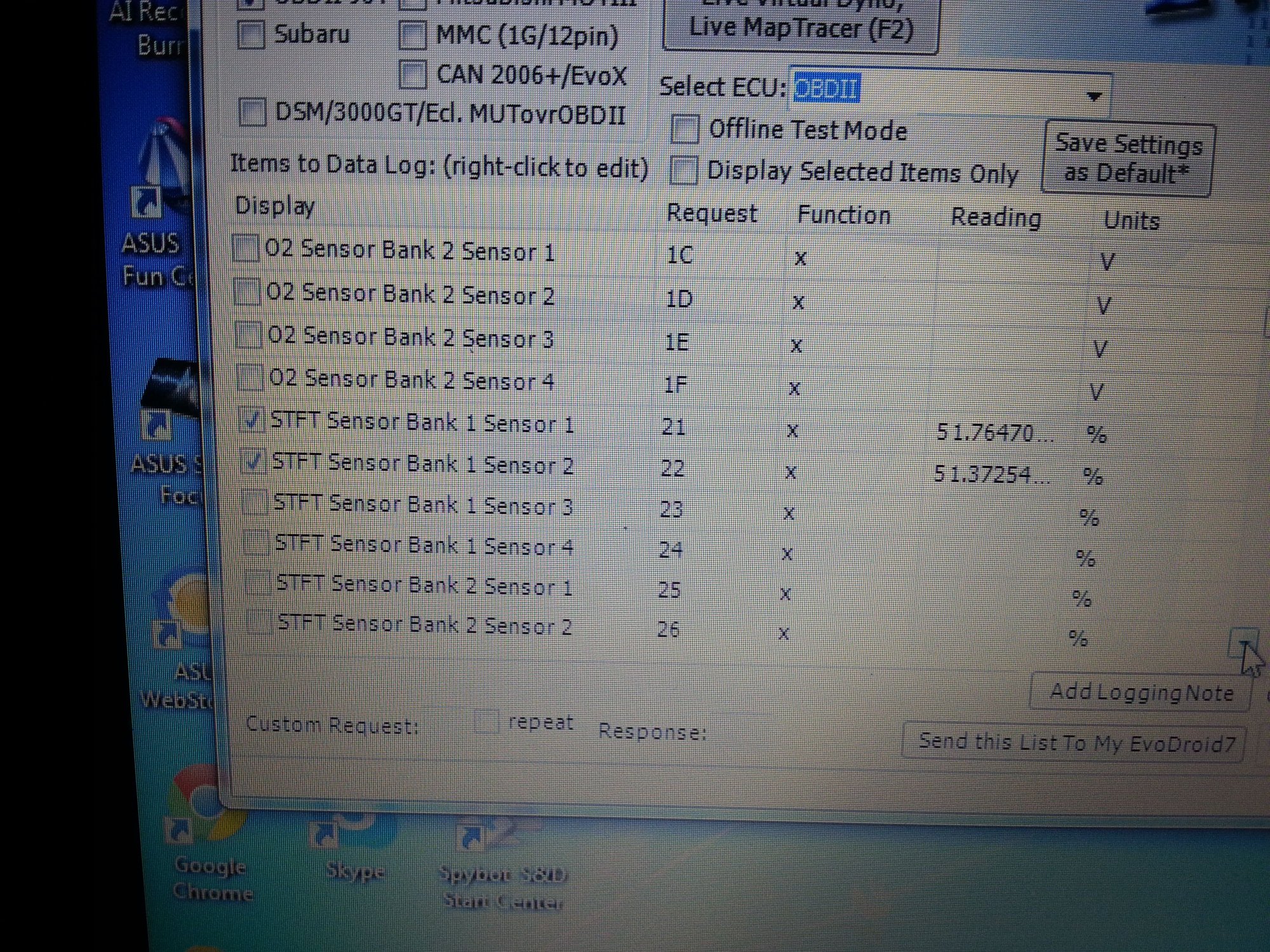

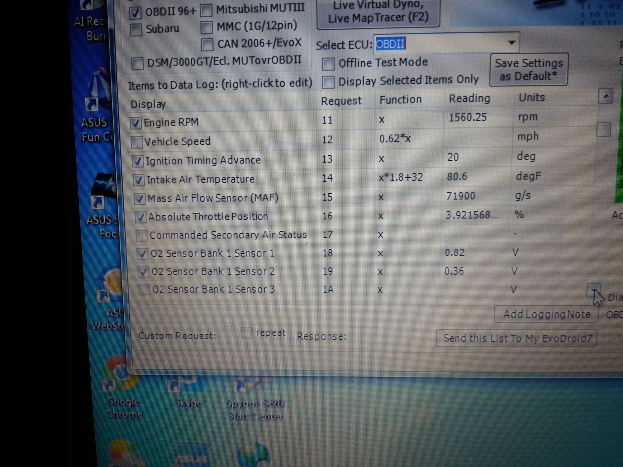

I loosened the throttle plate so it would idle its my only car right now. If I move the plate lower it wont idle at all. Heres my evo scan pics off my computer and yes it has a cam i have a guy trying to unlock the tune that was on it to see if he can figure something out but its been three weeks. I know its a little blury hopefully you can read it. If not i could message you my number and u could help me figure this crap out its annoying lol MG]http://cimg3.ibsrv.net/gimg/www.evolutionm.net-vbulletin/2000x1504/80-20150515_204635_55c1943f65c7c105ae98e6703cd64127b6 585656.jpg[/IMG]

should be able to use an unlocker to check the tune.
https://www.evolutionm.net/forums/ec...downloads.html
