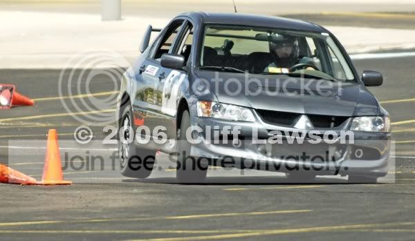

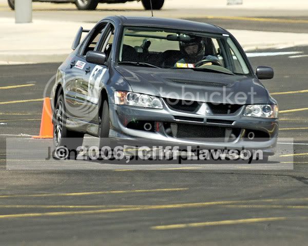

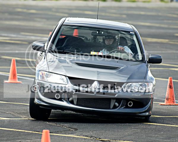

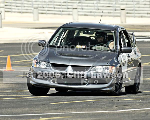

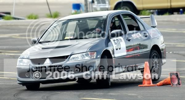

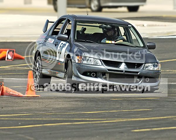

Here's some pics of my nasty body roll, haha:

Good lord man! do you ever get roll understeer from the car (it snap understeers when you lean it enough because you start to pick up the inside to middle of the outside front tire). I have felt this on stock suspended aligned evos with "R" compounds.
You need to take a lap in my car someday and we need to talk about you hand positions on the wheel
Nice job with your position in the standings and results

I'm not sure I've rolled enough to get roll understeer, but it's possible. I have some severe understeer at times when I don't drive properly.

I was thinking the EXACT same thing. That's funny. I stay at 9 and 3 under almost all conditions. And when I need lots of "turning" I feed the wheel around - no arm crossing. I try to paint happy little trees with my hands, no kung-fu flying arms!

I was taught not to crossover in an anti-terrorism driving course, but I'm not fast enough to feed the steering wheel in a really fast turn in auto-x.

It's tricky, but the key is looking far enough ahead to know what you need to do. That way if I know a hard corners is coming up I will shift my hands to a postition that will eliminate crossover hands from flyin'.
For Example: up coming hard left... instead of staying at 9 and 3 I will shift the left hand up to 12 and keep the right hand at 3. I'll start the turn in at 12 and 3 and by the time my left hand is down at 9 my right hand will have "feed" down to what is now 3, and was originally the 6 position on the wheel. And I'll keep "feeding" like this if it's a full 180 turn.

No, jid2, I understand you completely. The key is being in control enough with enough knowledge of the course to prepare the hand positions in advance. I wasn't doing that very well. The lack of brakes was also keeping my mind occupied a bit.
