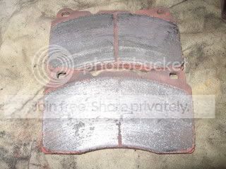

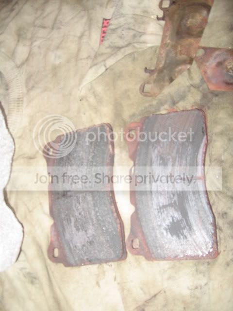

End of year Update:
Figured I'd update everyone on my PFC01's.
3 days on track now with them, including 1 day in the rain. Overall I'm really liking the pads. The on/off modulation issue I didn't like has gone away. I'm assuming it was mostly attributed to a new 7/16" pad and just my personal learning curve. I was able to heel/toe last time out continually and brake deep into corners with confidence repeatedly.
I might have gotten these too hot last time out though. I did not experience fade, but when I would go out for my later sessions, I had to pump the brake pedal back up to 'firm up' the pedal. Reminded me of the feeling you get after bleeding your brakes and you have to 'firm up' the pedal. Brake fluid level was spot on, so there were no leaks.
My calipers have darkened a bit, but not like I expected. Kinda sad really....lol.
My setup:
PFC01's all around, 255/40-17 RA1's, Motul. Stock rotors; no cooling ducts; no front undertray.
My setup:
Took off my PFC01's last night, and 6 total track days, the fronts look to be pretty much used up (pics below). I'm not sure if I could get any more out of them, probably not a full day or anything. I might keep the best 2 for backups.
Not surprisingly the rears look really good and I will be using next year.
