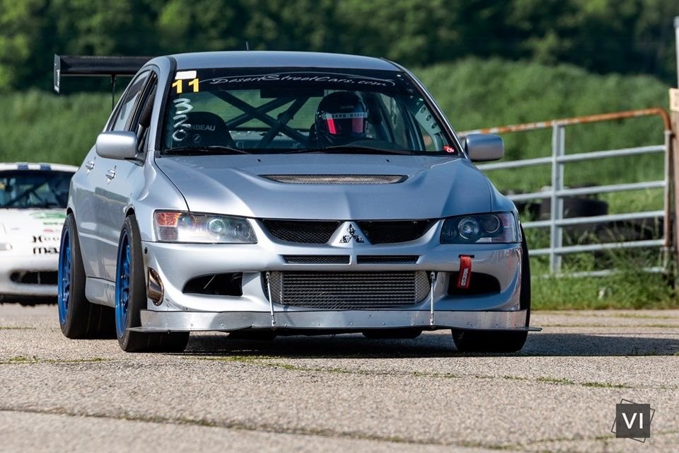

Originally Posted by GG06MR
Show and tell time
Bumper exit 🙂
