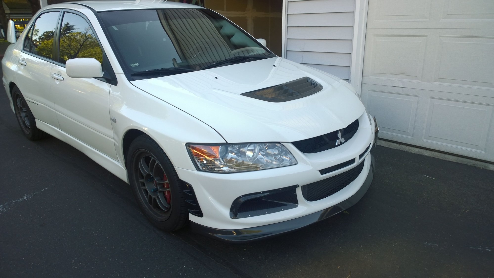

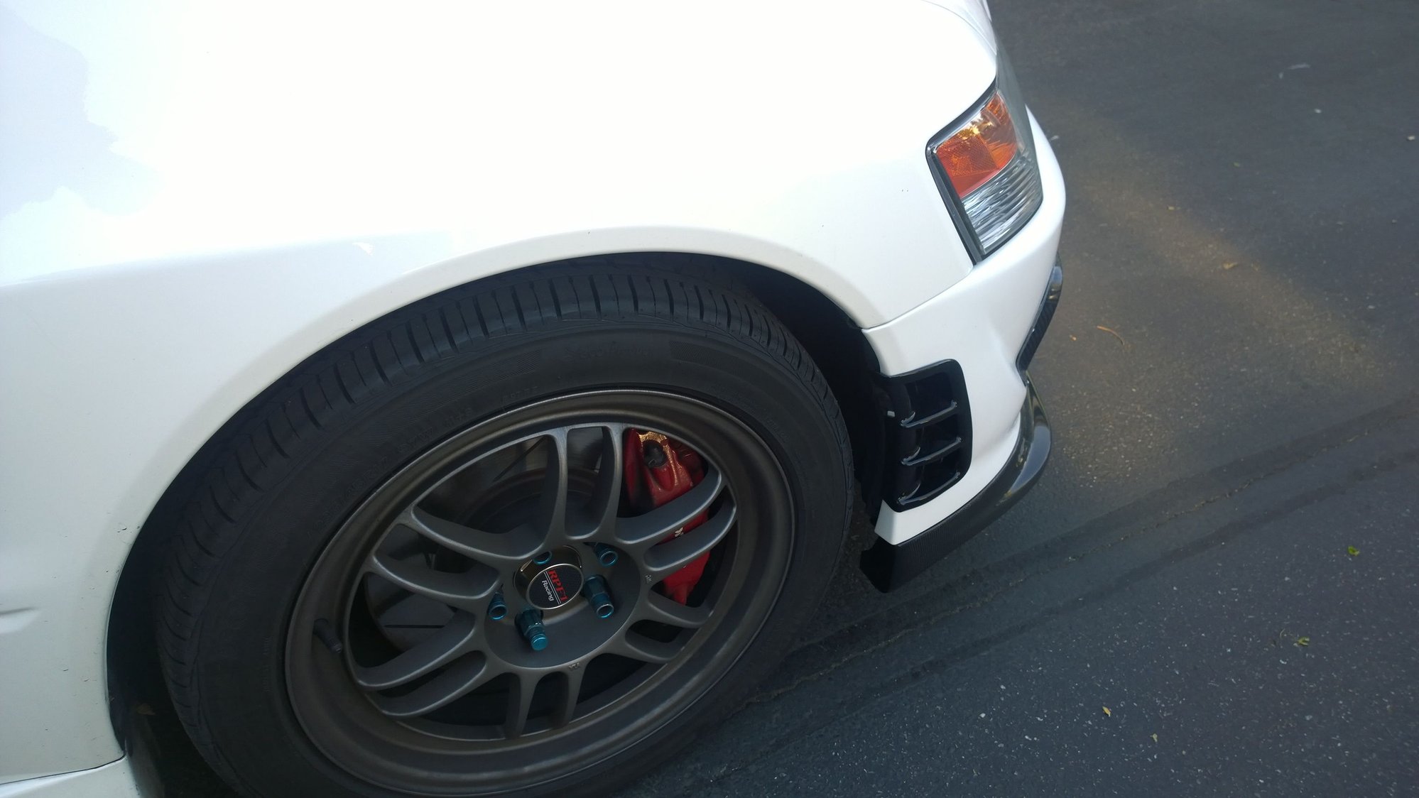

Originally Posted by codgi
As an update on the Evo IV oil cooler vent. Ordered it from here:
http://www.viamoto.co.uk/proddetail....art+-+MR603498.
With shipping to the west coast it was about $72USD. They have to order it from japan so said it would take about 10 days to get to them and then they would ship it to me. Ordered on Sept 28th, delivered today on the 13th of October. They were very good on communication and updates and it was carefully packed. Not sure when I will get it on the car since it's going on with a track only OEM VIII bumper so won't be for months at least.
And here it is all installed:
The VIII bumper is a bit different than the IV bumper (VI is flatter in these reason). So there was a little massaging that needs to be done. Funny enough to show how consistent Mitsubishi has been with their bumper attachments, the part is intended to dodge around a bolt on the VI....same bolt is present and dodged on the VIII.
However since none of my vids apparently caught my old oil temps I won't have a good before/after when I start tracking in a month's time. Hopefully if someone else does this they will have the data to prove/disprove it's usefulness.
