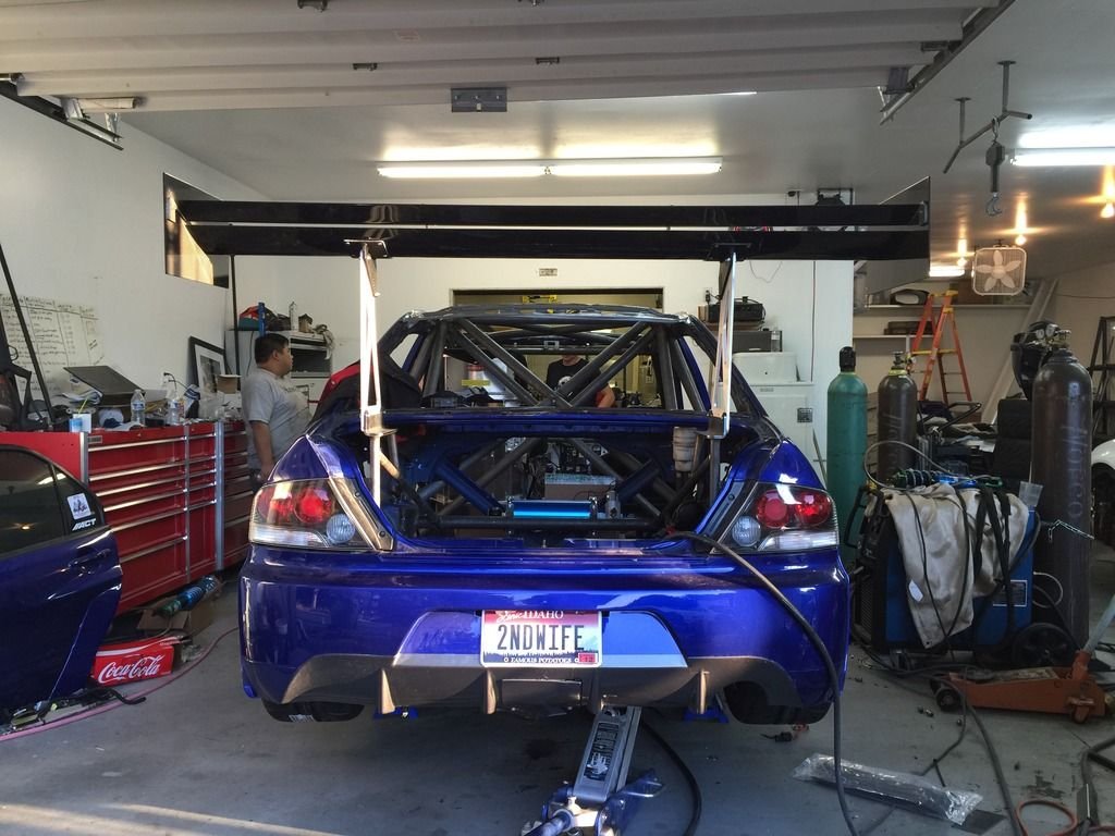

Nice job on new records and KOH!
Guessing you guys have a chassis mounted wing and have to remove it to remove the trunk?

[QUOTE=Meathooker;11653803
finally got the trunk mounted
[URL=http://s629.photobucket.com/user/meathooker/media/1EF82518-E7FA-4DCC-96F8-034C4386E142_zpsbg7i6hic.jpg.html]Name:  1EF82518-E7FA-4DCC-96F8-034C4386E142_zpsbg7i6hic.jpg
we cut the carbon trunk into 3 sections. the sides are permanently fixed and the center is removable. its screwed on for now but will get dzus fasteners in the future.

got our roof laid up. the surface finish has some imperfections but it'll work for now.
we put embeds for the hinges that seem to be decently rigid and a foam brace. it added to the stiffness quite a bit.
