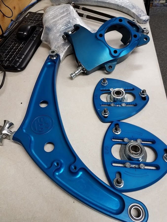

I'll have to make a separate post with this kit. really is a pretty good value. this is just the front. rears are still on the UPS truck.

Looks like a nice setup. What does it cost? Most of their Macstrut front kits seem to be around $1500 from Evasive.
Old Dec 21, 2016 | 09:05 AM
Checked out the Wisefab site & most of their control arm / hub kits look like approx $2600 per front / rear
Great to see them doing some AWD work as their website makes no Mitsu mention & have catered to the Drift segment, increasing Ackerman
Dang, those are purdy...

I asked Rob from racefab if he made any uprights. He only has arms/kits which add 30mm for bump steer but no uprights.

Wait, I just looked closer... Do I see the lower ball joint bolted on with 4 ~M6 screws? And further grooves cut around the annulus of the shaft? Please tell me its at least 41xx steel and not aluminum or stainless?
In all my FEA work on the uprights, the strength limit has always been the ball joints and tie rods. Making that part weaker is not a step in the right direction.
