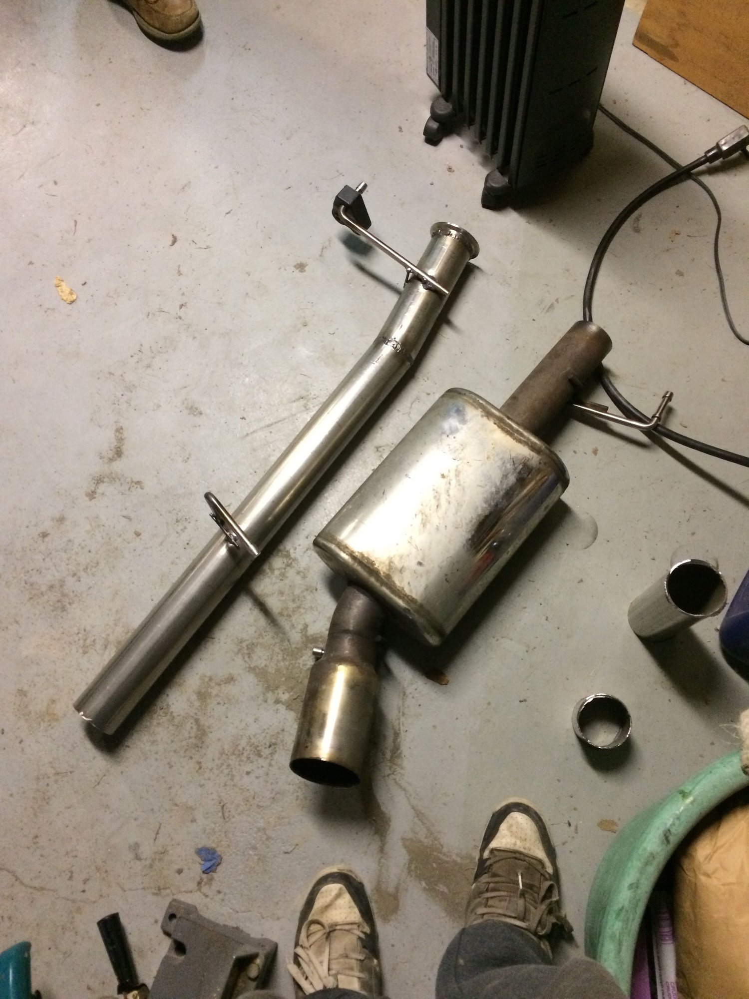

this was my first ever true fab project, pretty happy with how it came out, realistically my first time doing some serious welding too. now i have room for a nice diffuser finally, and dropped 6 pounds.
