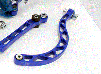

I follow RS motors & Andy on FB.
Contact them, because they already noted that was the reason they were able to fit the 315's
Have you seen the swoop to the rear trailing arms?
I imagine they said all sorts of things about one of their sponsor's parts.
The clearance to the suspension spring is closer than to my R/TErnie trailing arms. So, the big swoop doesn't do much unless you also offset the rear coilover (or run a short spring which will get you 6mm), cut the exhaust hanger on the passenger side and then, you are closer to the inside fender wall than to the trailing arm. This lines up with prior discussions I had with Eric, notably you will likely have to do something about the insides of the rear fender wall before you do anything with his trailing arm.
Is the coilover mount on the Wisefab rear LCA more inboard than the stock LCA?
Also, my point was more directed at the front where I stated that they likely can't turn the steering wheel too much.
