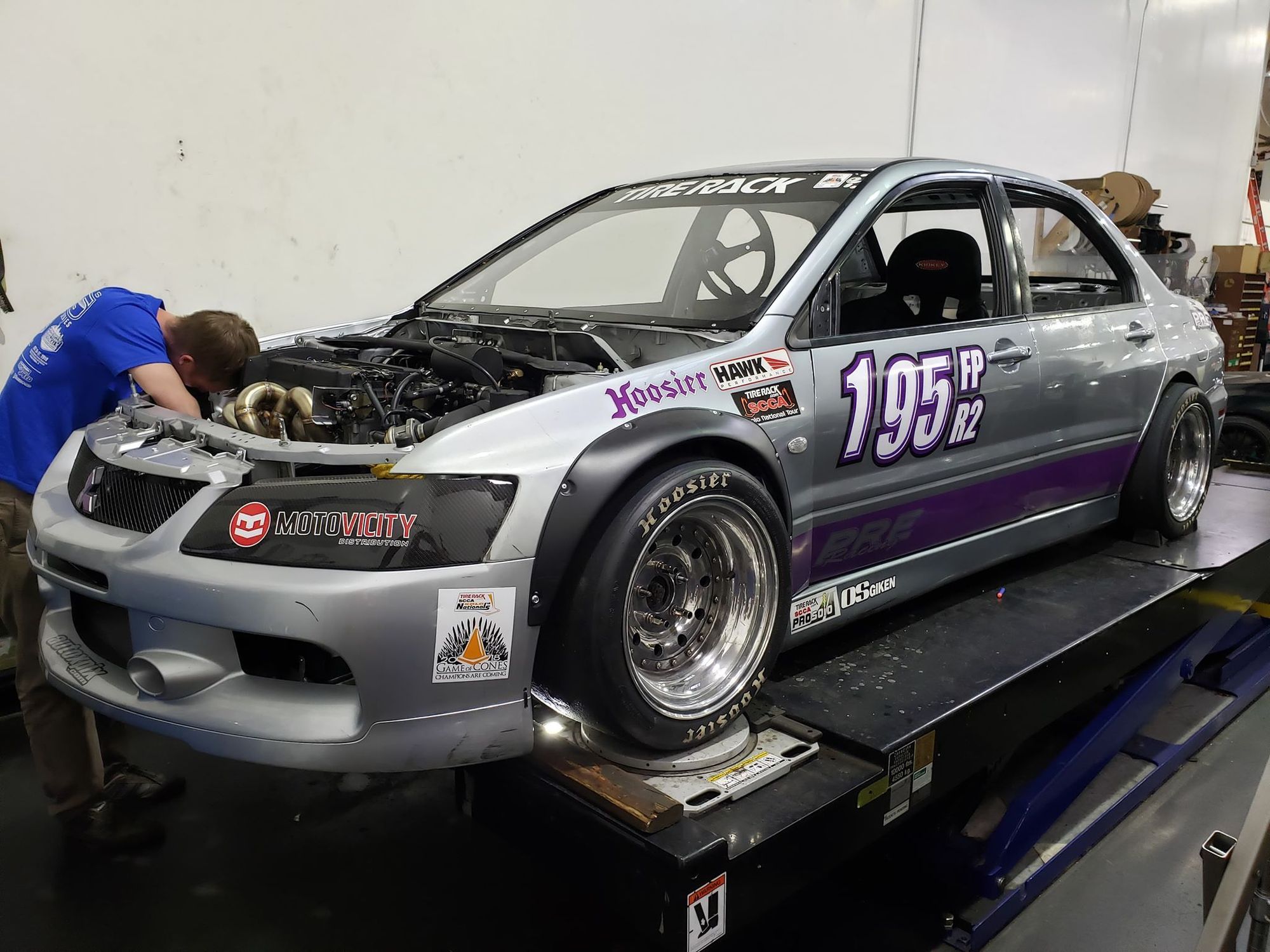

She is FINALLY ready for the track guys. I am not gonna write out a long explanation here. I am going to dump some pics, and if you guys have any questions. I will answer them!
