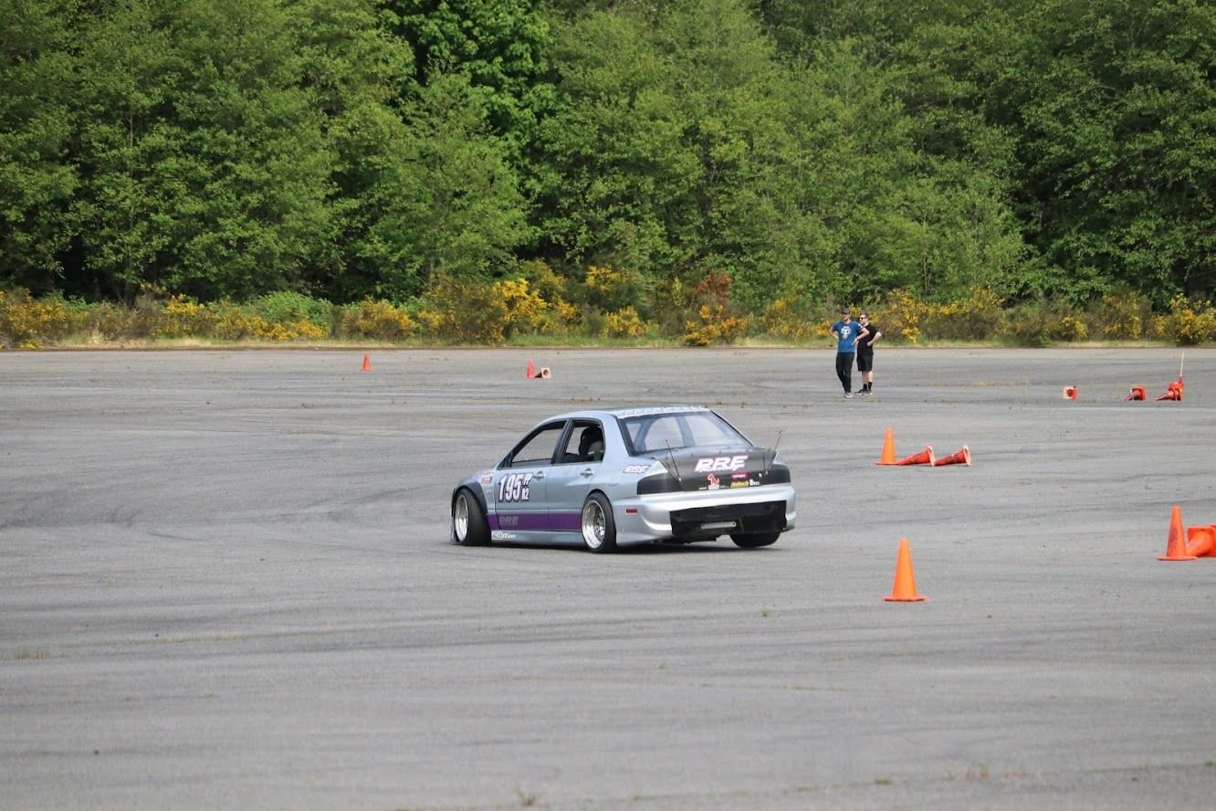

Proper evo ride height!

Slammed! Hellaflushyo!

Beautiful setup. Thanks for sharing!

Man, been a long time since I have been in here! Sorry about that guys.
We have a few upgrades planned for the car this year, but for the most part we feel the parts are there to make this thing win.
We are changing out the radiator for a larger unit. It just didn't quite cut the mustard when it can to 85*+ weather and dual drivers in a prosolo. We just got it mounted up this week, the mount is only 1lb, and we are hoping it is rigid enough to deal with the weight hanging there. We will be watching it closely for the first couple events to make sure there isn't anything bad going on.
We are also changing the rear brake calipers and rotors to try and **** the balance further rearward, those parts should be arriving anyday.
I will keep the updates coming as we get ready for the season!
Zack
