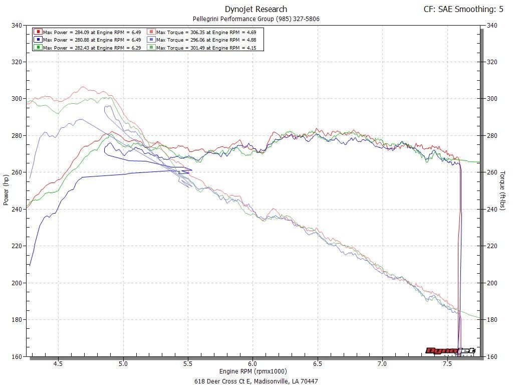

So I purchased Thai Diep's 2006 Evo RS out of the NASA Northeast region in December. It holds multiple NASA TT3 and TT4 track records. I plan to run it in TT4 this season, and I dynoed it and weight it this weekend. Here is my NASA TT Form:
284 max whp
3301 lb competition weight
+.1 weight
+.6 245/266mm DOT tires
+.2 4 Door Sedan
-.5 AWD TT4
12.04:1 weight : power ratio (TT4)
Here is my NASA TT4 dyno tune:

how much boost?
also curious - why the change over the s2k?

Looks like some nice boost control there to get the HP that flat.

They...may...call out the blue one because it's funky. Also the green one needs to hit rev limit like the other two since it doesn't "drop" for "1500 rpm". At least at nationals, your regional may not care but with the new upload system Greg may be browsing them randomly. And about time you got on here Did you print the tire tool yet for your 9.5's?

Originally Posted by kyoo
how much boost?
I wasn't in the car to monitor, and I had to lower the WGDC to get it to the 284 whp I was shooting for, so I don't honestly know. I wanted something that I could run TT4/TT3 in, and my S2k with a GTX3076R already struggles to stay under the 321 whp @ 3,000 lb setup I ran for TT3.
Yeah Thai had the car tuned pretty well it was really just making some WGDC changes to try and keep it as flat as possible.
Yeah the dyno RPM pickup was struggling to get through an entire run without a hick up. There were two or three bad RPM values in the blue plot, and the green plot had one phantom RPM value at 9000 RPM that was clearly not real. We ran it like 6 times just to get 3 somewhat useable plots. Their OBD port thing didn't connect to my car (not NASA dyno legal), and I don't trust doing RPM by gear ratio, so this was the best option we had. If Greg doesn't like it, he can pay to have it done again. This was at my local NASA region dyno day, and I drove 3.5 hours each way to get these plots done. It isn't my fault that the dyno had some RPM issues. I haven't printed the template yet. I spent yesterday removing the OEM front belts and readjusting the 6 points for me and my student trying to take some weight out. Up next is the airbag and a diet for me.

for national, i would just pay $100 to get it dyno there that week just to make sure your hp is not over their dyno, because that's the only dyno that counts for that weekend. i have always done that at Nat events. and i have always used max hp for avg since my hp curve is pretty flat, and not have to deal with all those print out and calculations.
