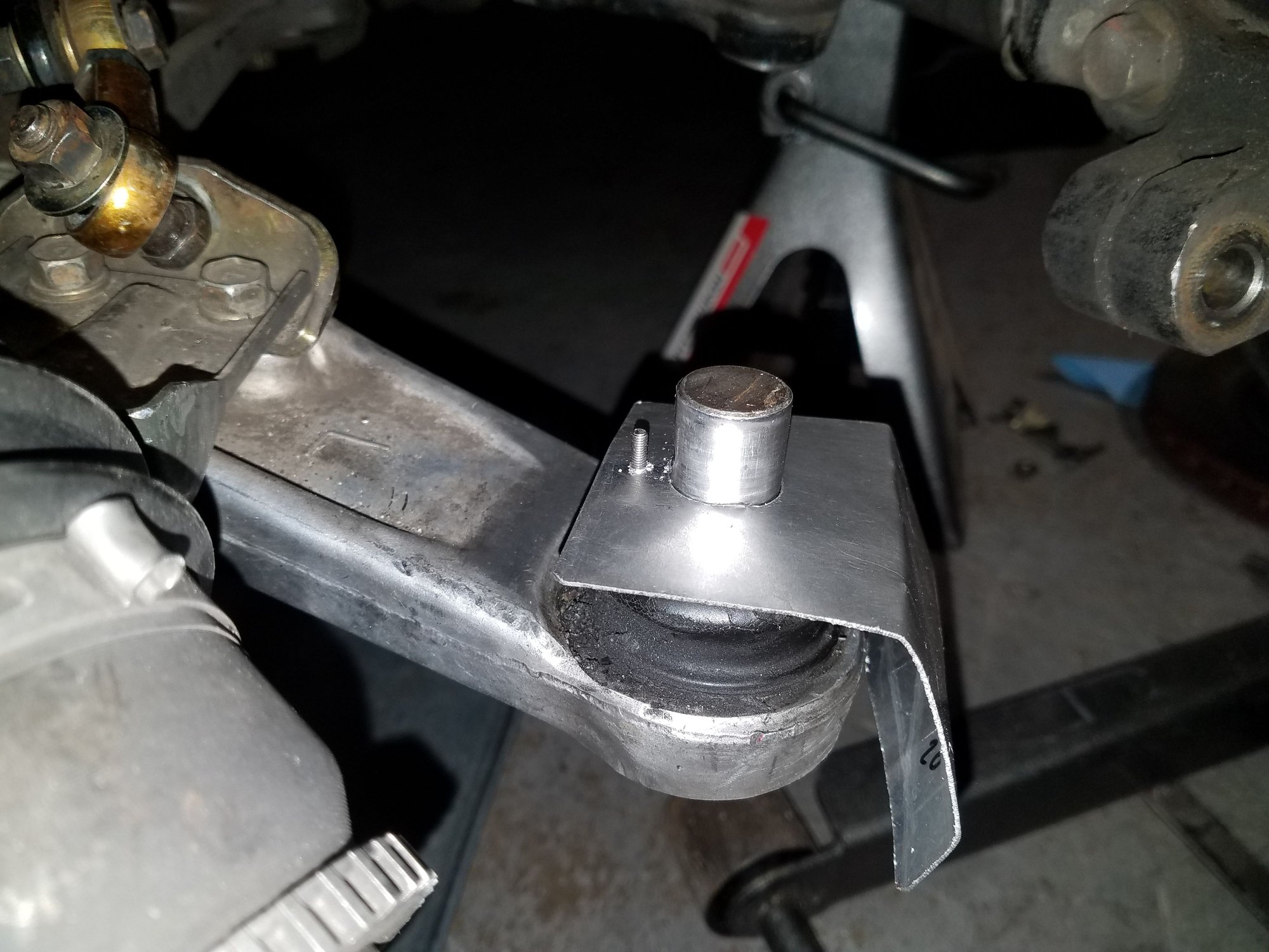

OP; I removed the dust covers and installed some home-made shields. I got the templates from a post on this forum. I then covered them in gold tape:
