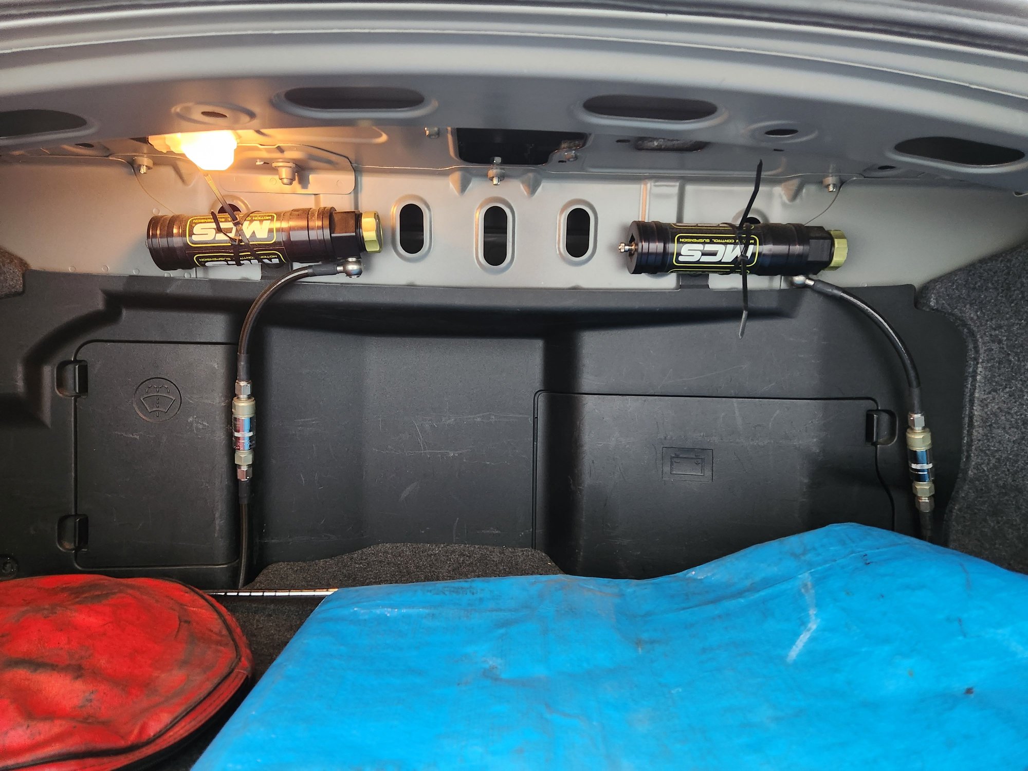

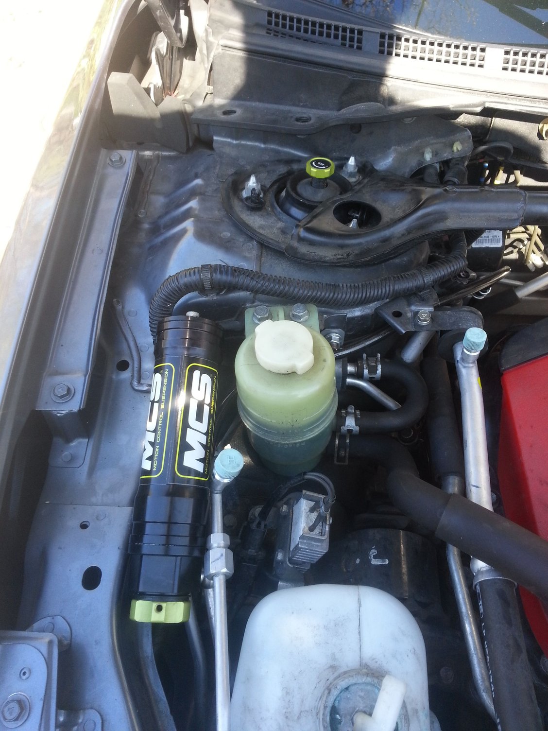

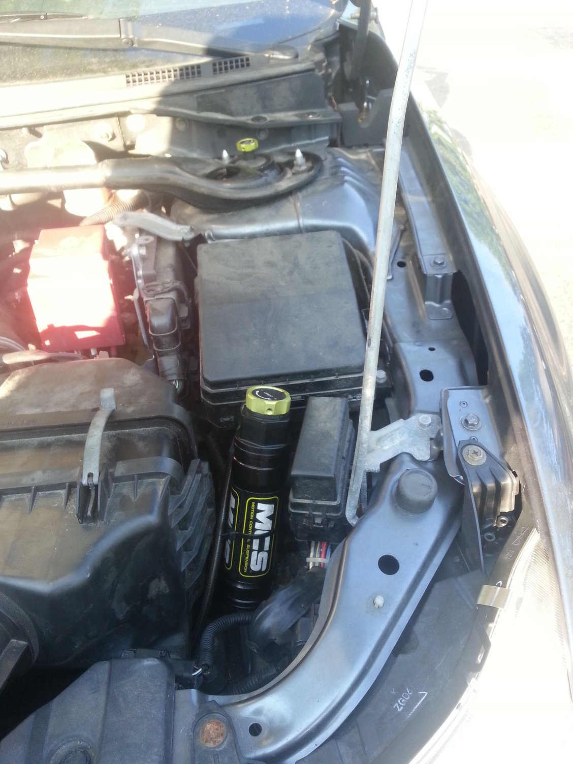

Here's where I mounted my rears.
As another person alluded, I need TY get my front reservoirs out of the engine bay and into fresh air. The engine bay heat is cooking these things....

Sorry I’m at a concert very tipsy. Where is your right rear mounted?

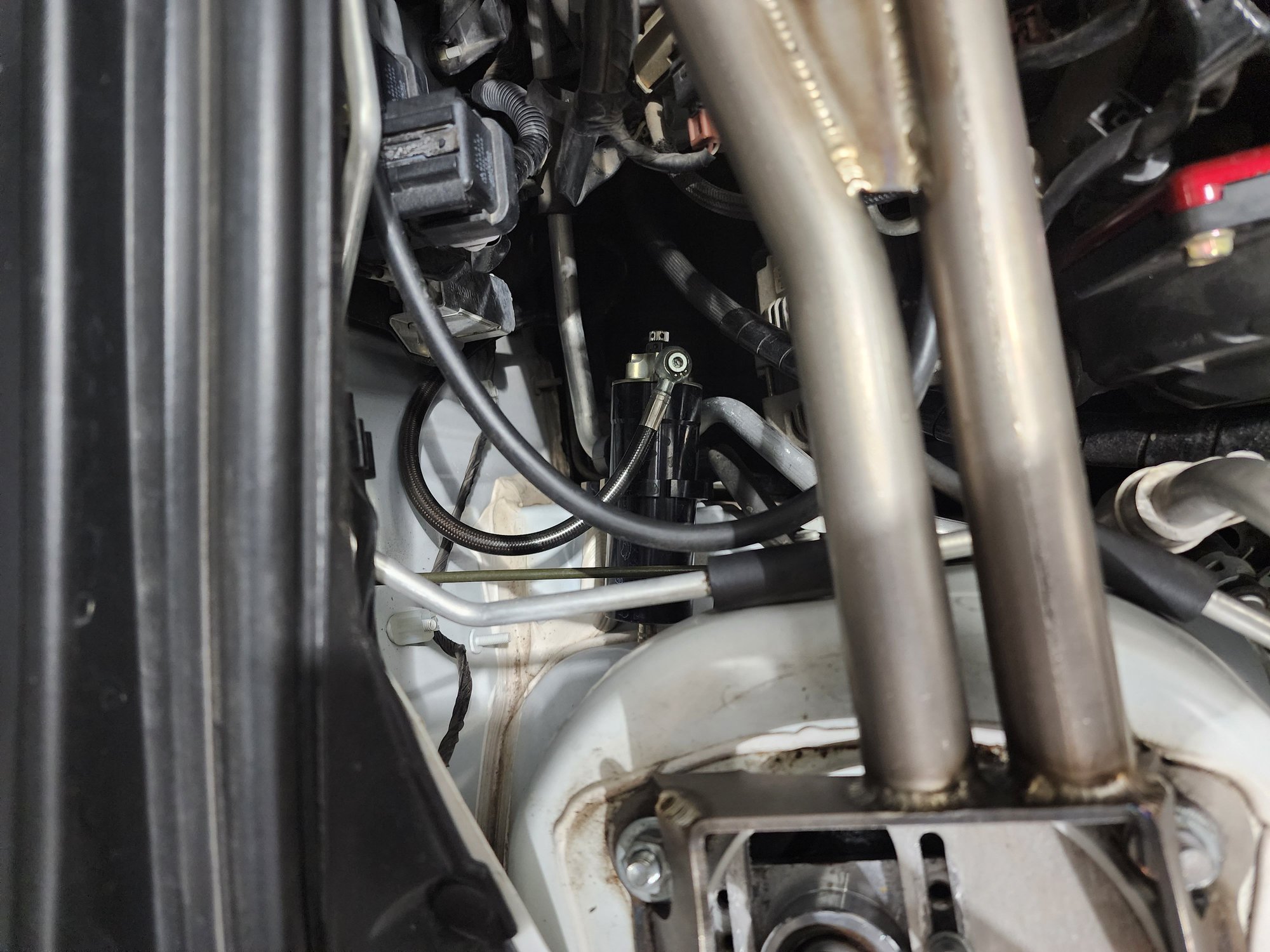

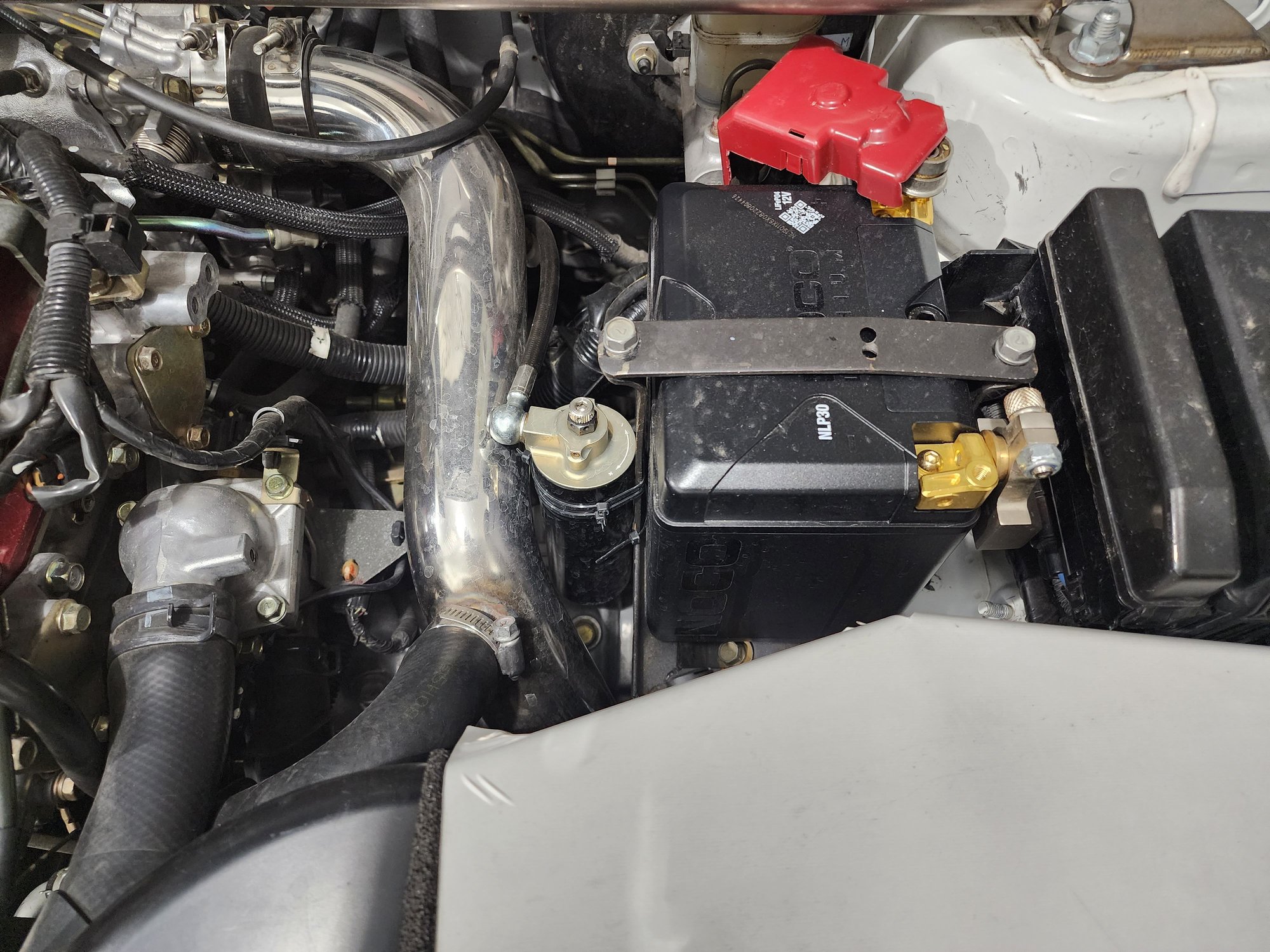

This is where mine are. As you can see, front rebound adjustment is right there and easy to do. For the rears, it has to be done through the battery and windshield wiper fluid container openings (this one is not fun)
Rears
Front left
Front right
Old Aug 16, 2023 | 05:33 PM
where would you place them, the fronts? I saw one post putting em by the radiator which is surprising
Old Aug 16, 2023 | 07:14 PM
  #176
LV///R's Avatar
iTrader: (36)
Posts: 1,593
Likes: 226
From: US

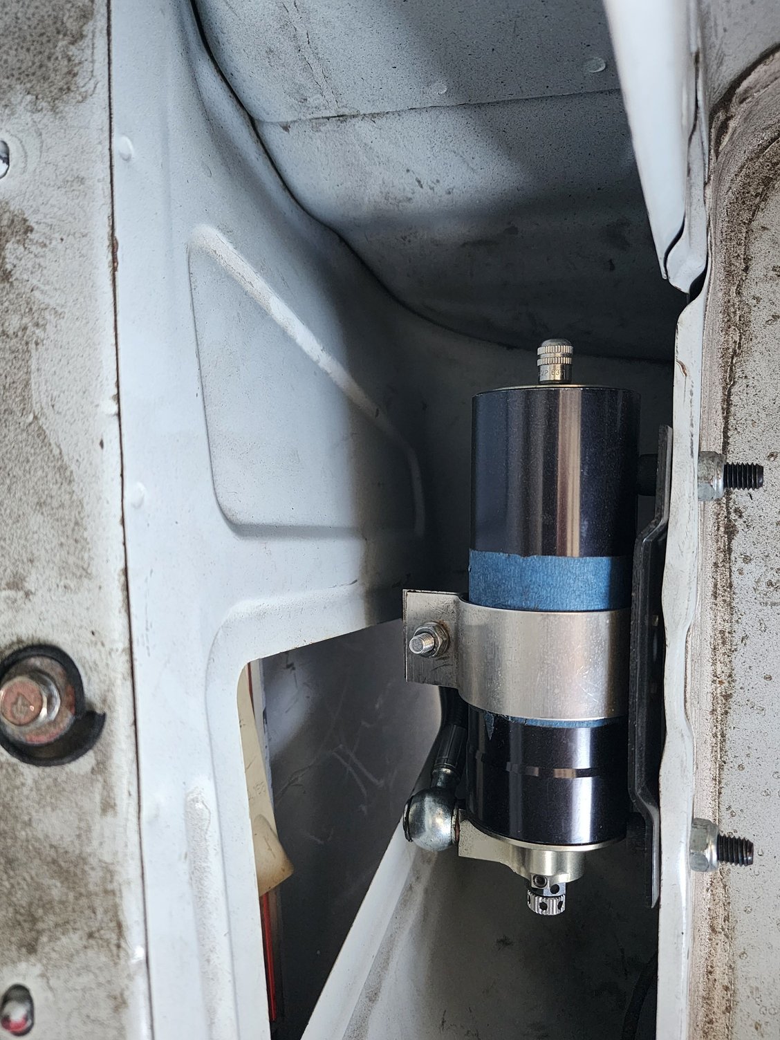

The rear corner is in the same spot, opposite corner!

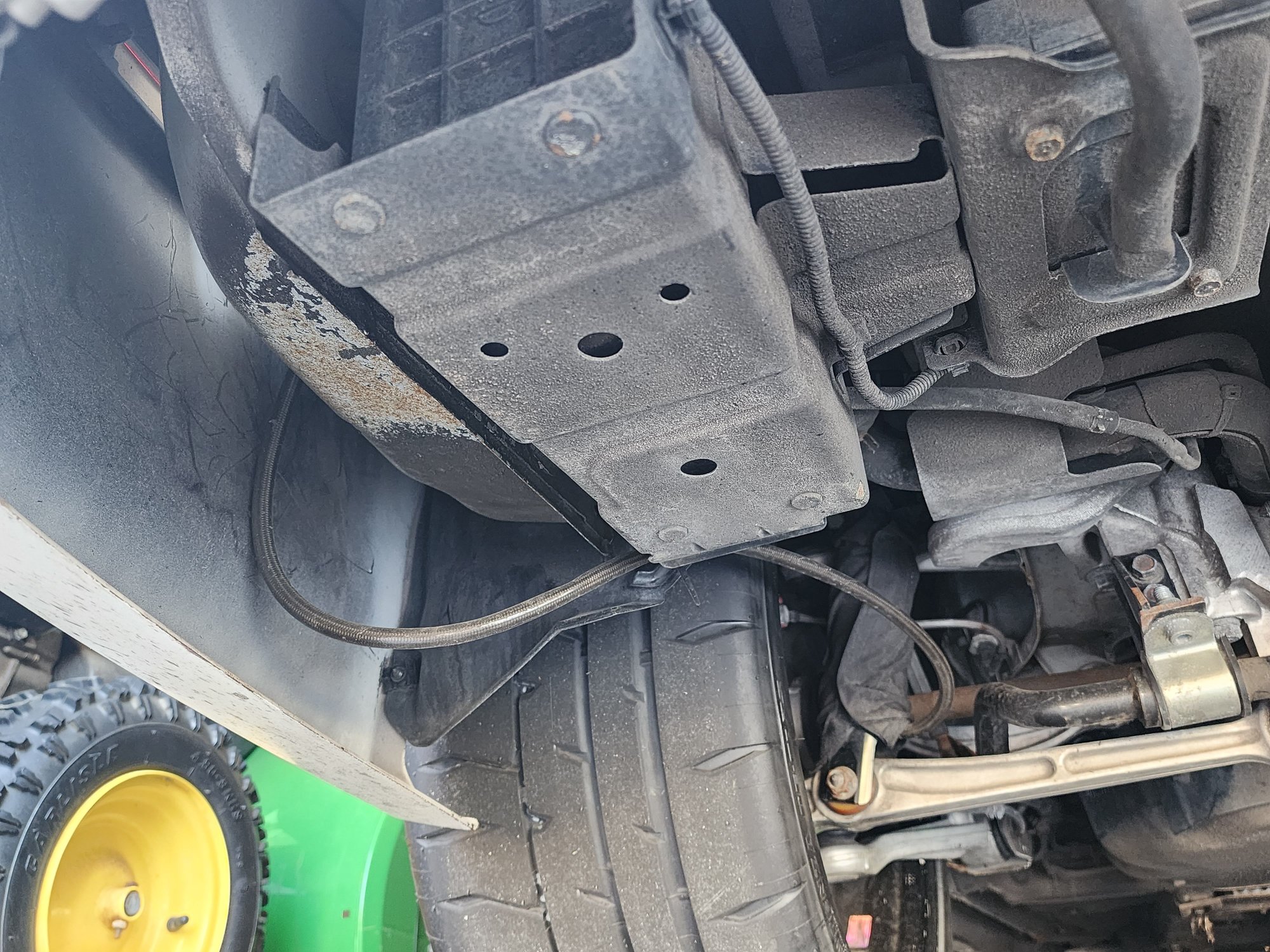

Here's the fronts. Will revisit locations hopefully before Nationals.
you seem to have plenty of space under the strut bar
Old Aug 17, 2023 | 05:21 AM
  #178
LV///R's Avatar
iTrader: (36)
Posts: 1,593
Likes: 226
From: US
I've had them there before, but the heat from the intake manifold absolutely roasts them as well. It's just not a good spot, IMO.
