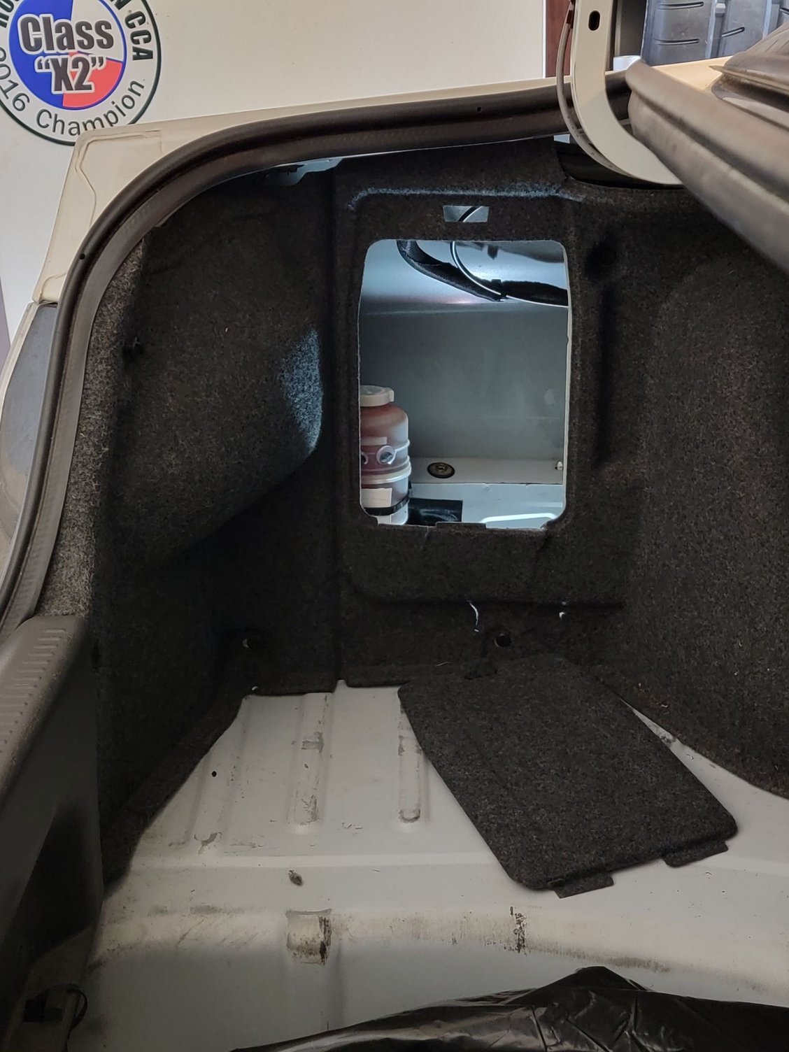

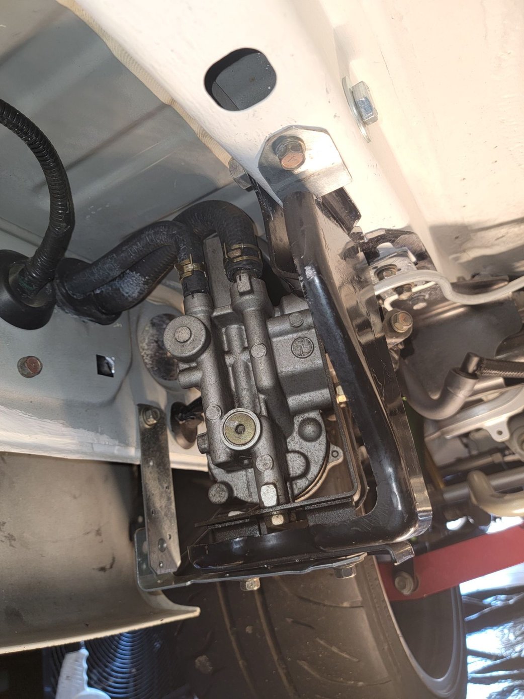

ACD relocation kinda done, still need to redo a section of the hard line. and testing
has stink venting and water drainage for clean ups
pre formed hoses
fired up the 3d printer (no not really). will figure out something else later. it reminds me of the waste management truck
extra tire clearance and air deflection to the intake
finally have room for a aftermarket air intake

I changed my mind about the battery in the trunk, the wire is too heavy and I need all the space back there
I would strongly suggest to put the pump in the trunk and not in the otherwise stock JDM location... It will last much longer.
We don't have snow/salt in Houston. I was thinking "wrapping" that black cap which I assume is where things get messed up. I believe I have your rebuild kit but I still havent used it.
I also need the trunk space for gear, fuel and a floor jack... things that flop around
ok, that is a fair point. I am not too worried about the pump part these days, but solenoids are a problem if they go..
usually my car is trailered and the evo remains fairly empty, but it's a bummer how the spacing ended up. maybe i should ask someone to fab up a plastic tub/block from the acd stuff that is now contained my my trunkwell
I'm stubborn and want an 'arrive & drive' set up. wave at trailer queens on the highway.
leave yours there if its not a street car IMO
I should just get a back up solenoid then
