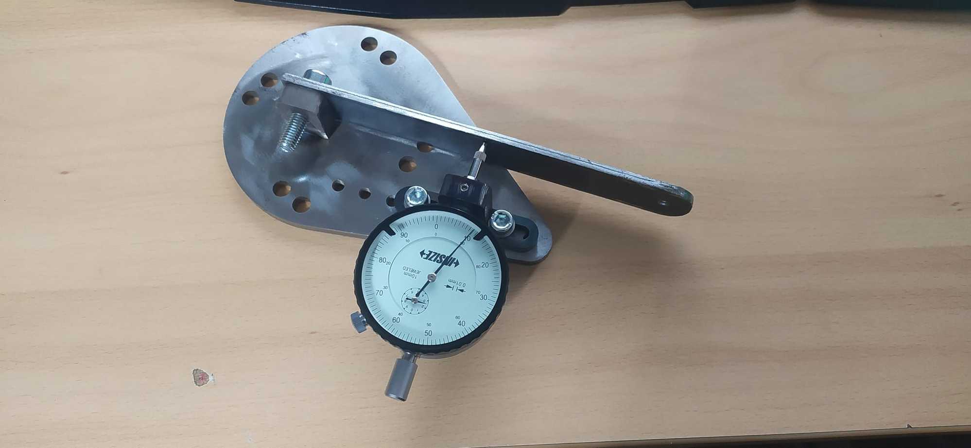

Speaking of diffs... covid self isolation and working from home finally gave me some time to finish the diff pinion bearing preload tool (measurement of bearing rolling tq).. works with the transfer pinion too with an adapter... will make adapters for the various diffs too.
