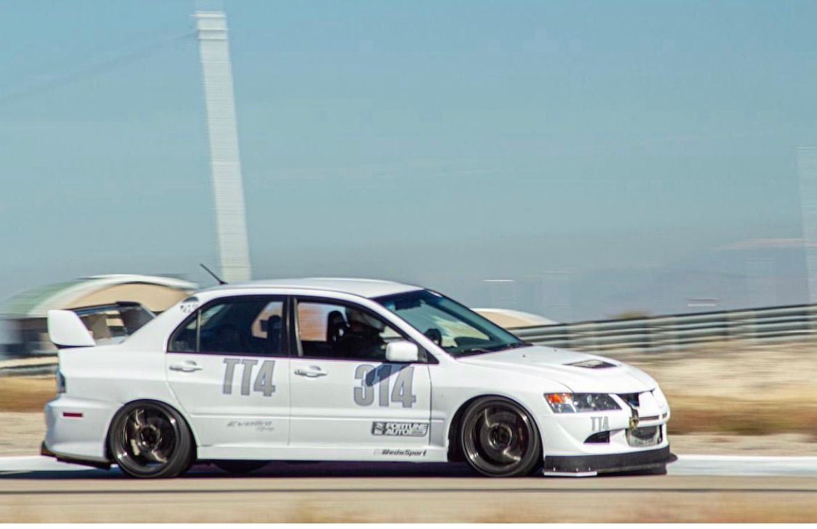

Consider running a lower ride height. I was apprehensive on the hill climb car to run it low as we run in some rough surfaces. After driving siluck2’s car at a lower height I decided to try it on the budget build tt car (all cars mentioned have SSB uprights front and rear). It was great on track at a low height!
