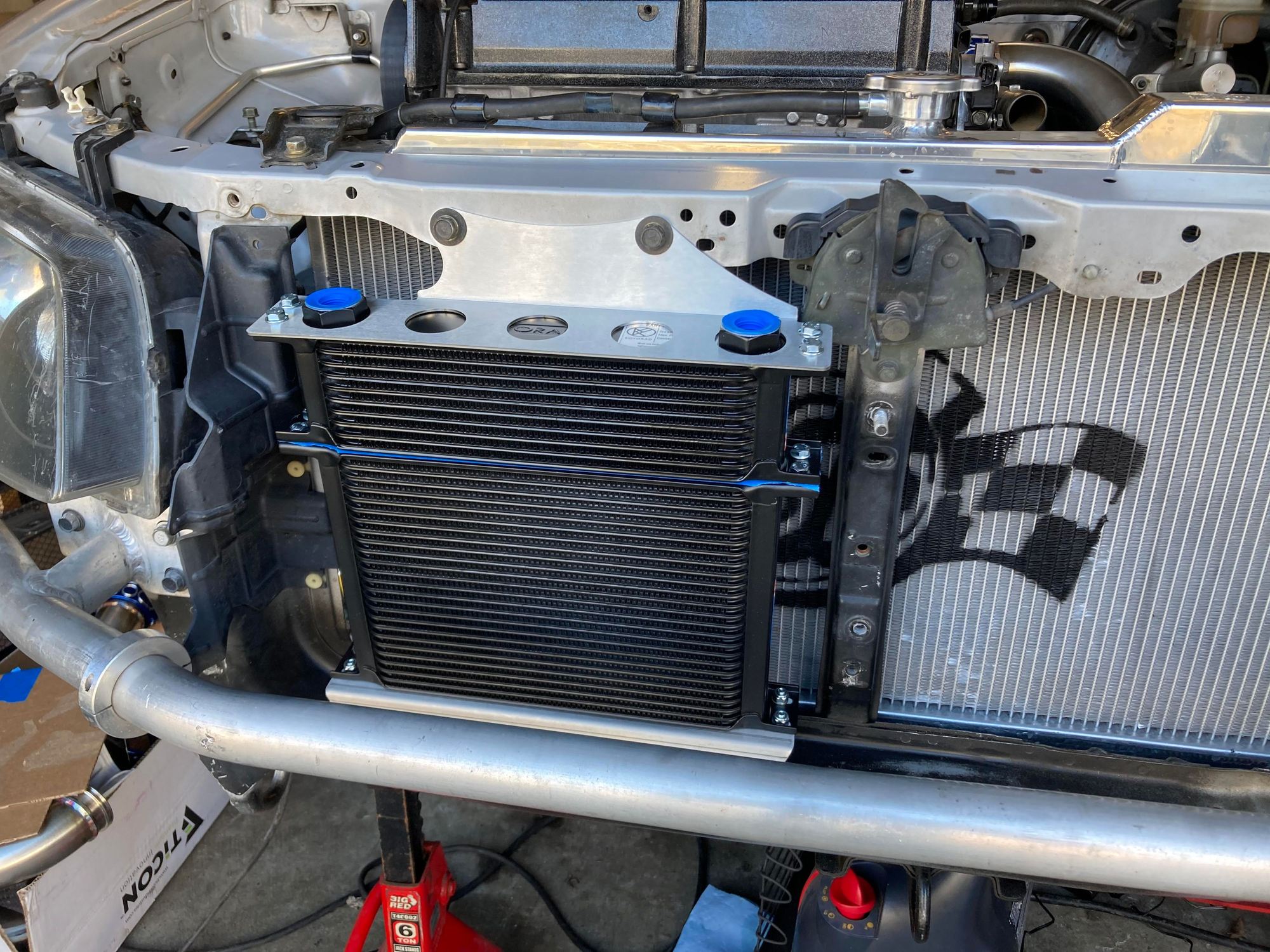

I finally got around to test fitting my oil cooler brackets for the center mount oil and power steering cooler combo I'm working on. Super happy with how it's coming along. Just need to run lines and then it's done and I'll be on to making a waterfall duct to direct airflow from the heat exchangers through the hood vent. Waterfall duct pictured is a rough design, still working on dimensions and clearing the turbo and manifold etc.
That is so nice.... it almost makes me wanna get rid of my AC

Ayoustin i do love your bullbar haha i need one of those for bowling people out the way
