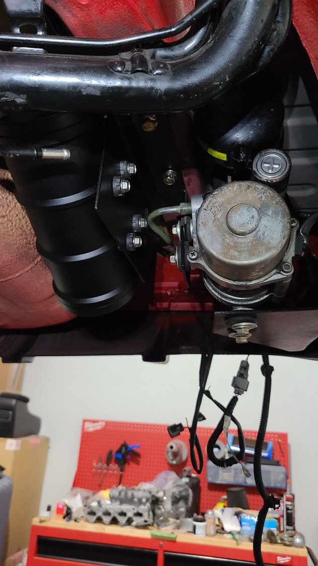

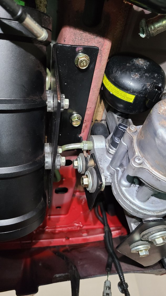

Just wanted to post up how I did my ACD line routing for the relocation since everyone has a different strategy. I wanted to keep it as much as possible to completely hardlines, no extra connections/fittings and try to make it look OEM. I kept it on the drivers side because the exhaust was causing me too much hassle with where I could place the ACD pump and I used the evap hard line on the driver's side (which I believe is the JDM acd line anyways) to go to the front. The reservoir is going in the stock JDM location. Everything is pretty tightly packaged in there with my surge tank but everything mocked up well together. I still have to secure the line with some hangers and straighten out some kinks / paint it so don't judge the finish quality.

Man, I'd really like to do that to make brake ducting easier. Just seems overwhelming right now. I'd hate to get half way in and mess up LOL
plus, I need my evap functional.

Just convert it to braided thats all we did.
