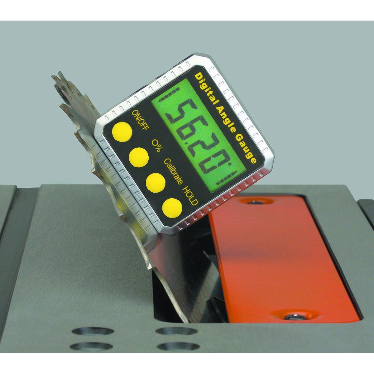

first thing, You should learn to do your alignments at home via strings it is far more accurate those laser machines are often not very accurate. Theres a reason professional motorsport teams use string line setups and set up hubs. For camber you can buy a builders square to measure cambers using Pythagoras. at 57cm high 1cm = 1 degree. this height works out pretty close to the height of your wheel and tyre
Why do you not have any Toe out on the front? Im not familiar with auto X setups so not sure if this is normal or not but for circuit you definitely want 1 - 2 mm toe out each side on the front. I run a little bit of toe in on the rear but a trick i used to use is 1mm toe out on the rear also really helps on throttle rotation.

no need for math
https://www.harborfreight.com/digita...&cid=go_social

Where are you sticking that thing while the wheels are on the car? Or are you using hub stands?

I have this random bar that fit exactly from top to bottom lip of the 18" wheel. its actually a bar I got from replacing the garage door opener.
you can also make one from shelving hardware
