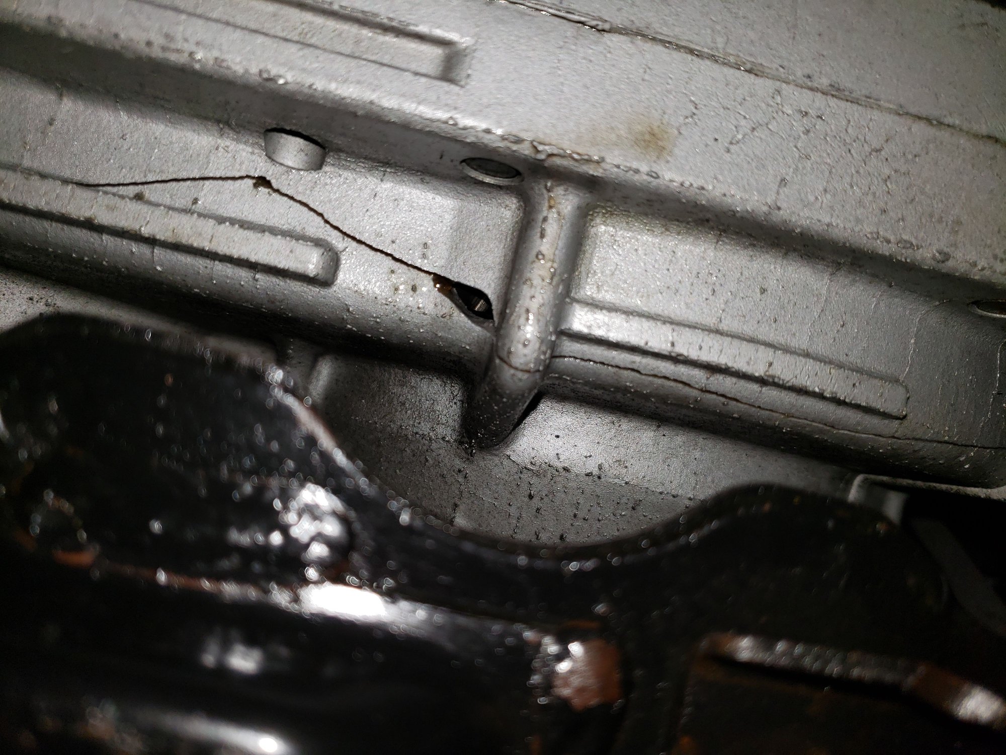

Hi gang. Will be getting this fixed. Somehow my clutch housing cracked and leaked fluid on an autox course
This is after 2.5 years since it was put together. 2kmi max
never hit anything. Shifts fine. I did a search and dint find many posts on this issue. Can you guys tell me is this is a common issue? Thanks

I've only seen transmissions break like that on very high torque cars on the launch. And by high torque in mean 600wtq+. And its not that common
