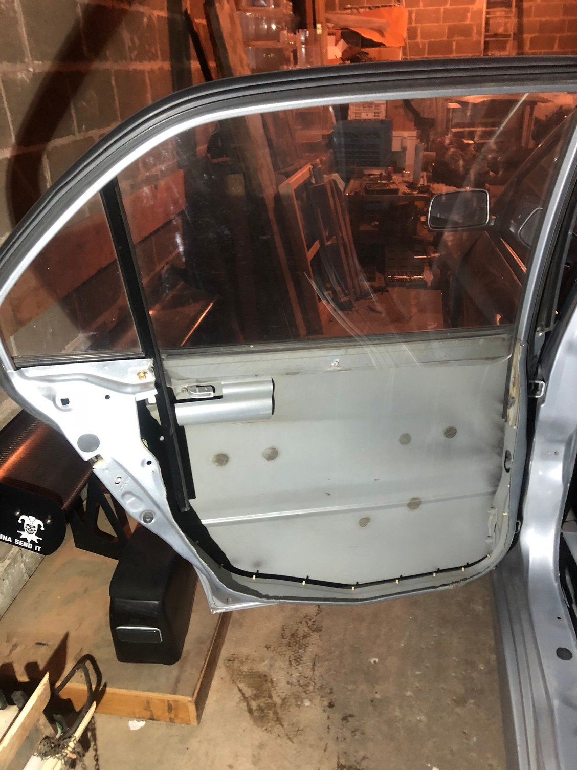

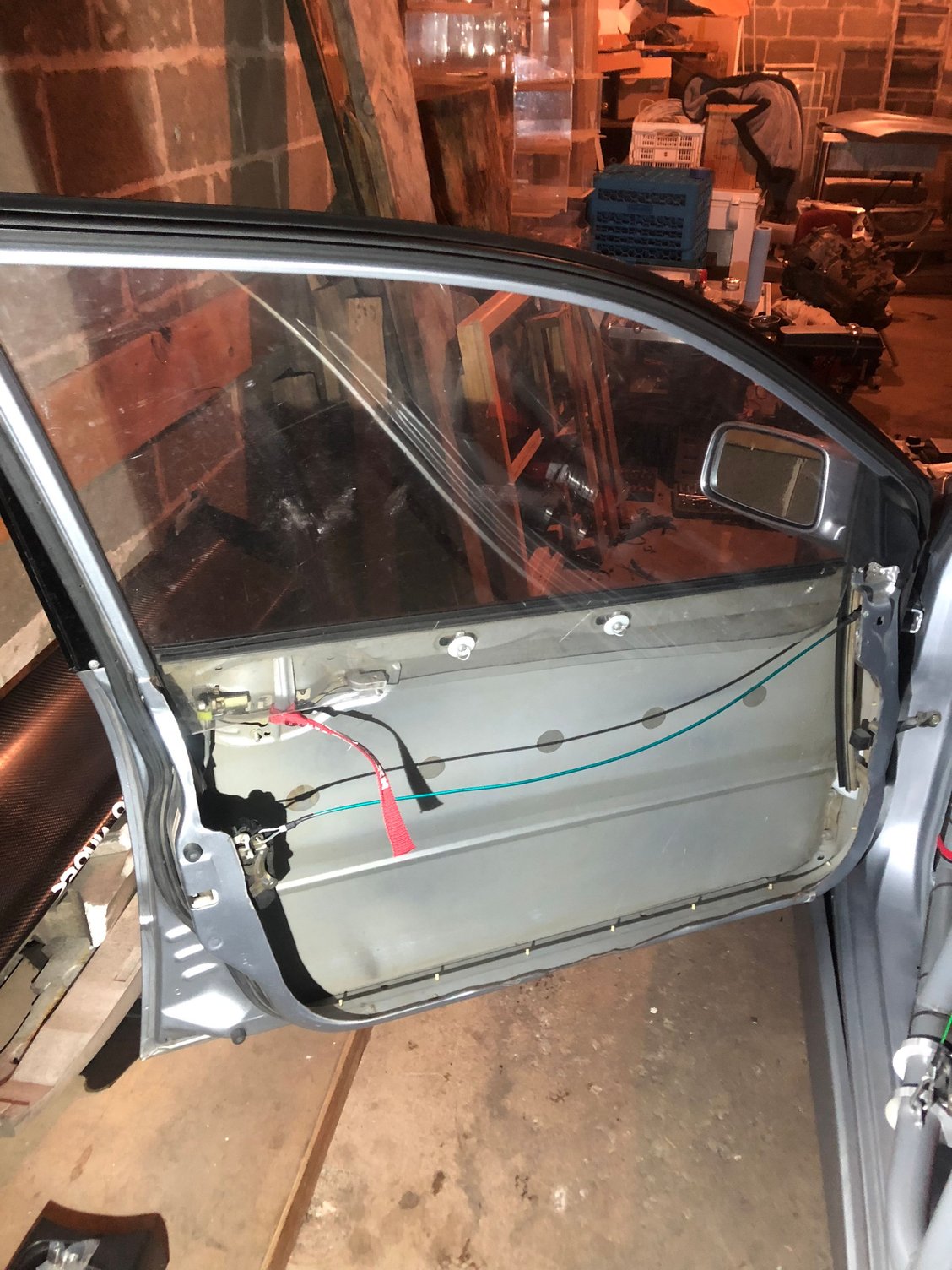

The absolute biggest thing to understand with weight reduction is how much vehicle occupant friendliness are you willing to give up? Getting an evo under 2900lbs and still having a vehicle as user friendly to drive around town as a stock evo would be exceptionally hard. Creating a ratty track car like mine, not anything extraordinary, you just have to be willing to give everything up.
I hardly ever even drive mine on the street (it still has lights and wipers to be legal) and when I do drive it, it's short distance. My car isn't weatherproof, it has no hvac, you can hear EVERY little noise it makes, the doors have no rigidity whatsoever (seriously, they get really floppy once you gut them and cut out the door bars), the only stuff underneath what's left of the dash is a fuse box, some wires, and the cage, the only wiring that goes aft of the dash is for the tail lights and fuel system stuff on the tank, Basically, if it doesn't help the car go around a racetrack faster, it's gone.

Do you still get to keep the rear door card/power windows with gutted door beam on rear door?

It depends how far you gut them. The only thing that remains of my door is the door skin and the latch mechanism, so for me, no. Keep in mind, I also have a cage with door bars. I would never gut doors this far without side impact protection built into the cage.
