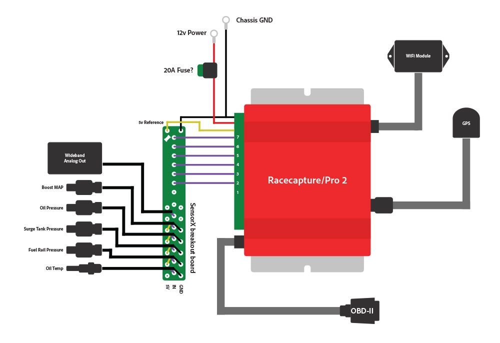

I've set up a bunch of sensors in my Evo 10 for my RaceCapture Pro setup. It's worked really well for monitoring/logging the car on track and street. I mapped it out visually here:
I've since added another pressure sensor to measure crank case pressure. I also of course log Ethanol % into the oem ECU. All the oem ECU logging and external sensors combine into the Racecapture logs.
You can see some of the data overlayed in this video:
If I do go aftermarket ECU, all the sensors are there and wired for it.

Wow…that’s a sweet setup for logging. I’ve stretched my Zeitronix stuff to its limits and that sort of setup would be the next logical step with the stock ECU, but for the fact that I’m now thinking standalone to have the safety intervention features.
