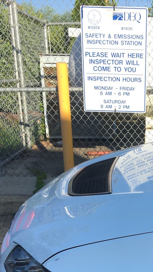

What are the limitations on standalone setup (I’m inclined to Haltech), if you want to preserve the ability to swap back and forth to stock ECU?
The photo below was taken this week. The new turbo kit raised eyebrows for sure (in addition to cage, race seats, etc.), but I passed.
