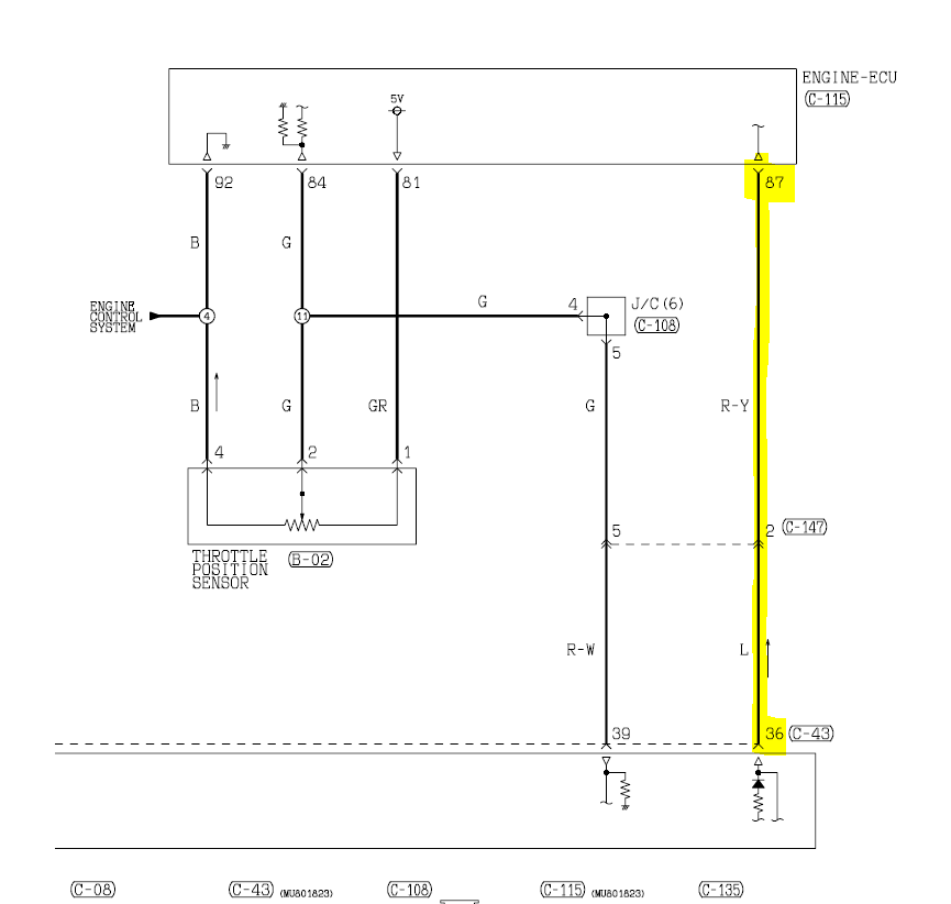

If you turn your ignition to full on and your ACD 3 lights dont come on after 30 seconds you good. I dont think this wire is much of a worry as long as you still have the ABS ecu. its when you get rid of both that it freaks out

Just refreshed myself with the wiring diagrams and pinouts etc.
Pin 87 on the ecu goes to pin 36 on the ACD computer and is listed as idle detection. I cant find any information about what this function is for. I dont have this pin connected anymore either and mine doesnt fault but it would be good to know its function. it seems to be an on/off input so it must either tell the acd ecu its idling or not but why it needs this information im not sure.
Luckily if you dont have AYC then you dont have the birdsnest of wheelspeed sensors where they ground through the ABS ECU rather than the ACD ECU and you dont have the sense pin 49 connecting the 2 together which causes all sorts of issues
