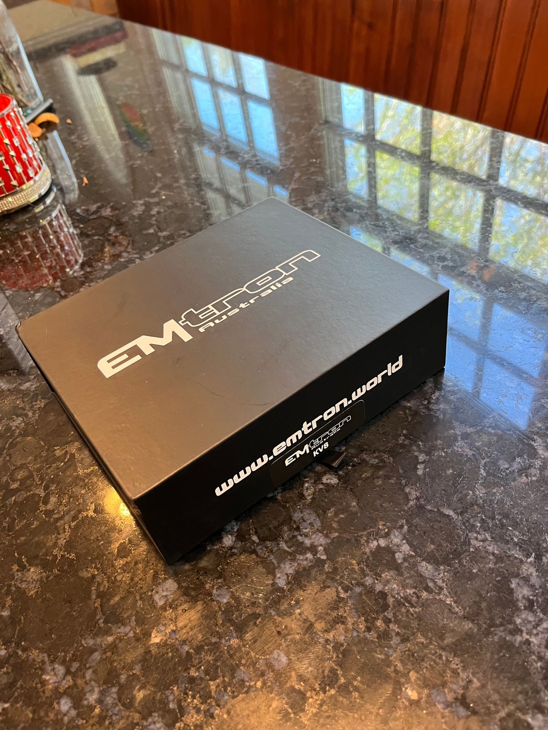

I'm the OP of this thread. DHL paid me a visit today Technology has come a long way during my Evo ownership. I started with an SAFC back in 2004!

Quote: I'm the OP of this thread. DHL paid me a visit today Technology has come a long way during my Evo ownership. I started with an SAFC back in 2004!
Congrats on getting your KV8. If you need a Evo 8 non-ACD base file I can send you a copy of the base file Emtron sent me.

Very keen to see how you find the emtron.
I like Motec logging and have done lots of coaching etc in sim racing and real world via motec but i helped a friend out with the tuning side the other day and found it quite horrible. granted it was an old ecu so not sure if that makes a difference but regardless will love to see how you find the emtron going forward

What did you not like about the software?

My impression is that the Motec M800 (what I assume you saw) is great once you know how to use it, because it's so flexible, but it's also intimidating. I think the newer Motec ECUs are easier to use, but less flexible. I didn't really consider Motec because the software pricing model was a big turnoff to me. I think Emtron is a bargain for what it is.
It will be a while before I get this up and running. My car is wired for stock ECU/flex fuel working with Zeitronix and Innovate add-ons, so I need to rewire all that, in addition to getting a harness together and mounting solution. Plus, I need to do it in such a way that I can flip back and forth with the stock ECU. I'm looking forward to the project though.
