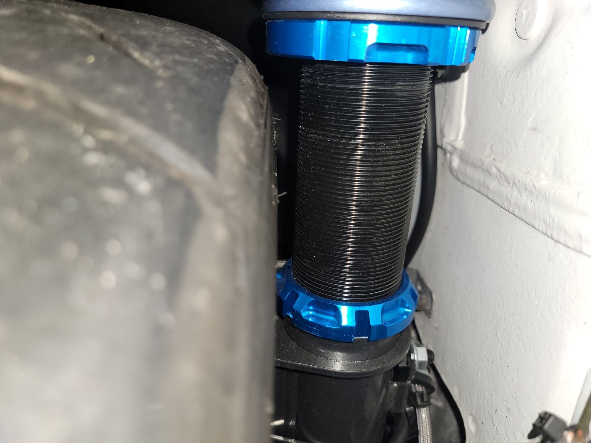

Indeed - running 6" springs up front is a must if you want to stuff some meat up front!
5" really, if you want to clear it with little spacer.
5" is pretty short for the front. Thats roughly 2.5" max travel and even with 800lb front springs I use a bit more than that. Rear 5" is fine because typically higher NF and lower MR.

I have 5" plus KW v3 helper springs (maybe as a 1.5" spacer). I havent raced with this set up tho
Is the helper spring at full expansion or do you have it squished somewhat?
on jack stands. (maximum camber from camber bolts). helper springs are squished to 33% shock travel
So many variables at play: Ride height, wheel/tire combos, camber settings, coilover design, etc. are all coming into play here.
On the front, I'm running arguably the widest wheel/tire combo you can fit on a stock fender/body evo. 18x11" +15 / 295 A052 and I haven't had any issues with the 6" spring on my old JRZ's or Ohlins. I have a set of Shaftworks dampers on the way so we'll see if this fits the mold as well!
Works well, no bottoming out on high curbs, 700 lbs front 900 rear. I attribute that also to the MCS valving. Rear has a 7" spring. Both have helpers. Without a spacer the 18x11 with 295 hoosier cleared but was a little close for comfort so I had a custom set of 8mm hubcentrics made and it lines up well.

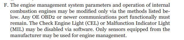

Random, odd, Street Touring question that came up from a conversation with a friend who runs in STS.
Is it legal to run a wideband 02 sensor in Street Touring? My first thought was, "Well, why not? It's simply a gauge."
After looking at the rules, here's what I found:
Under Street rules:
Under Street Touring Rules:

If the WBO2 isn't connected to the ECU it wouldn't be being used for engine management, right? If you were to add an IAT for SD or something along those lines it would be an additional sensor being used for engine management.
Thanks for the clarification. I feel like I was over thinking this!
