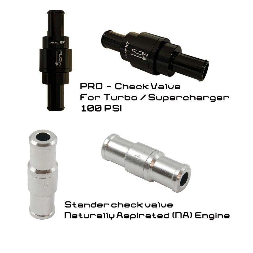

Originally Posted by RSMike
I haven't. It would need to be normally open and close with very little pressure (0.3psi?)
The turbo drain is covered when the engine is off, but I think you'll find that the oil level drops quite a lot when the engine is running.
So the turbo drain will be open, not covered by oil. You will see some of the drag racing and roll racing cars will smoke from the turbo under decel and/or brakes. This is likely from the oil pushing back into the turbo drain, which causes oil to bypass the oil seals into the turbine wheel section.
all of those coin type valves are normally open if mounted vertically.
I use the silver one below. its sprung. since I have hoses with oil queued up in them from oil separators, just their weight is enough to let the it drain down
