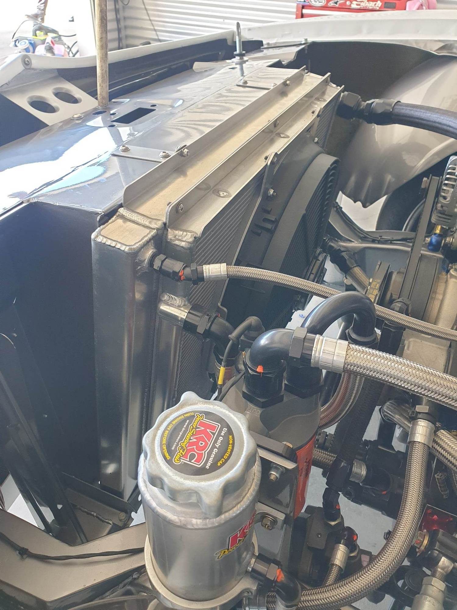

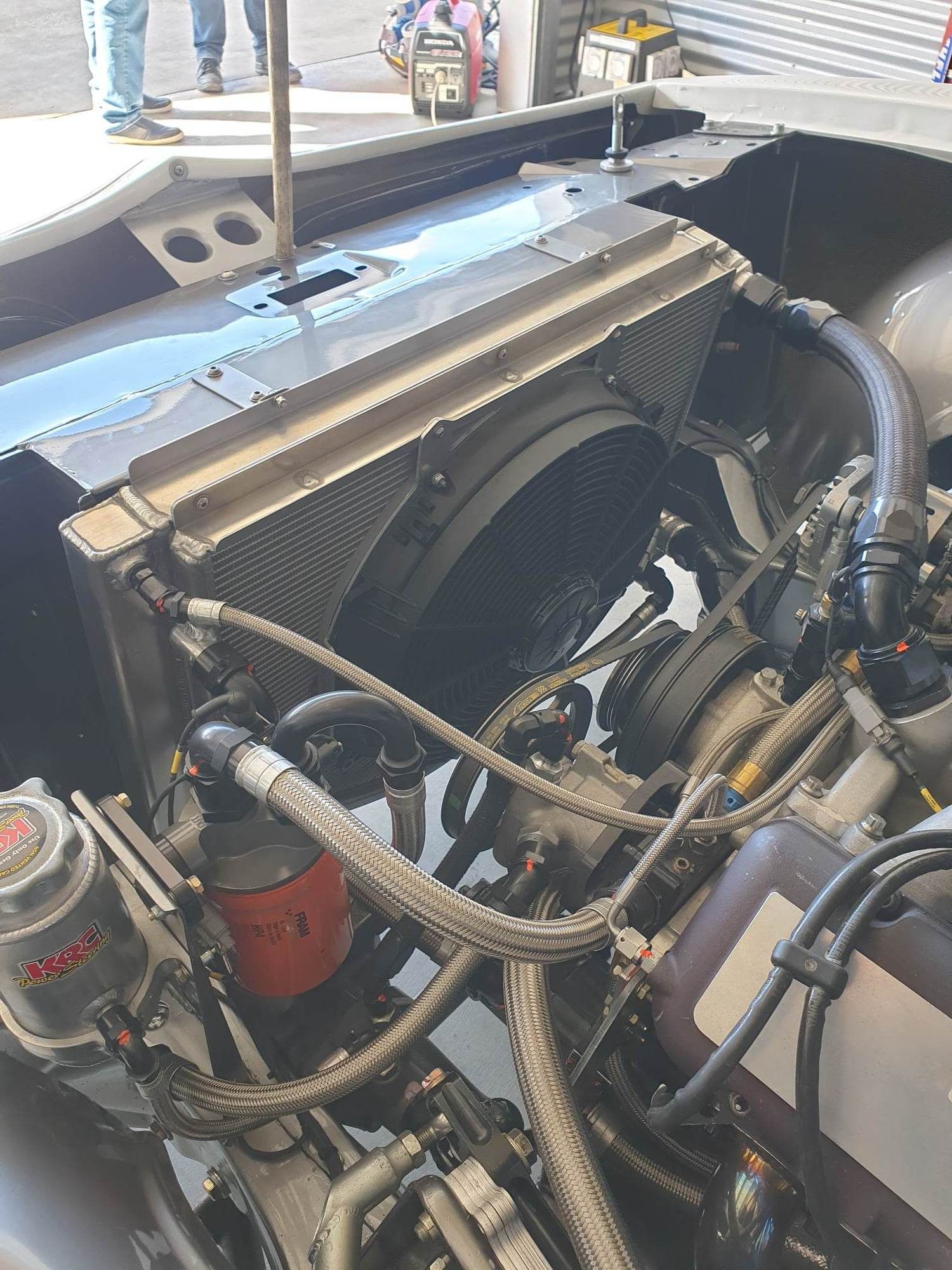

Here are some real-world pics of a Muscle car here in NZ.
Using a PWR radiator and oil cooler (tube/fin core) which is bolted together.
800+ whp from a Nascar engine, not seeing more than 90ºC oil temp for a 15minute race.
I'd love to make a setup like this for the Evo market, but I dont think people would pay $3000nzd for this setup.

From my perspective it seems like overkill to make the oil cooler the same dimesions as the radiator on the Evo. I was thinking of stacking the oil cooler at the top of the radiator core. This way you keep the same width and so not much of the original radiator core is lost. However now the oil cooler is drained to remove the radiator and vice versa.

The Evo has a large radiator, so they don't need matching size. I think Mike was more on the concept of stacking the coolers, not the matching size.
