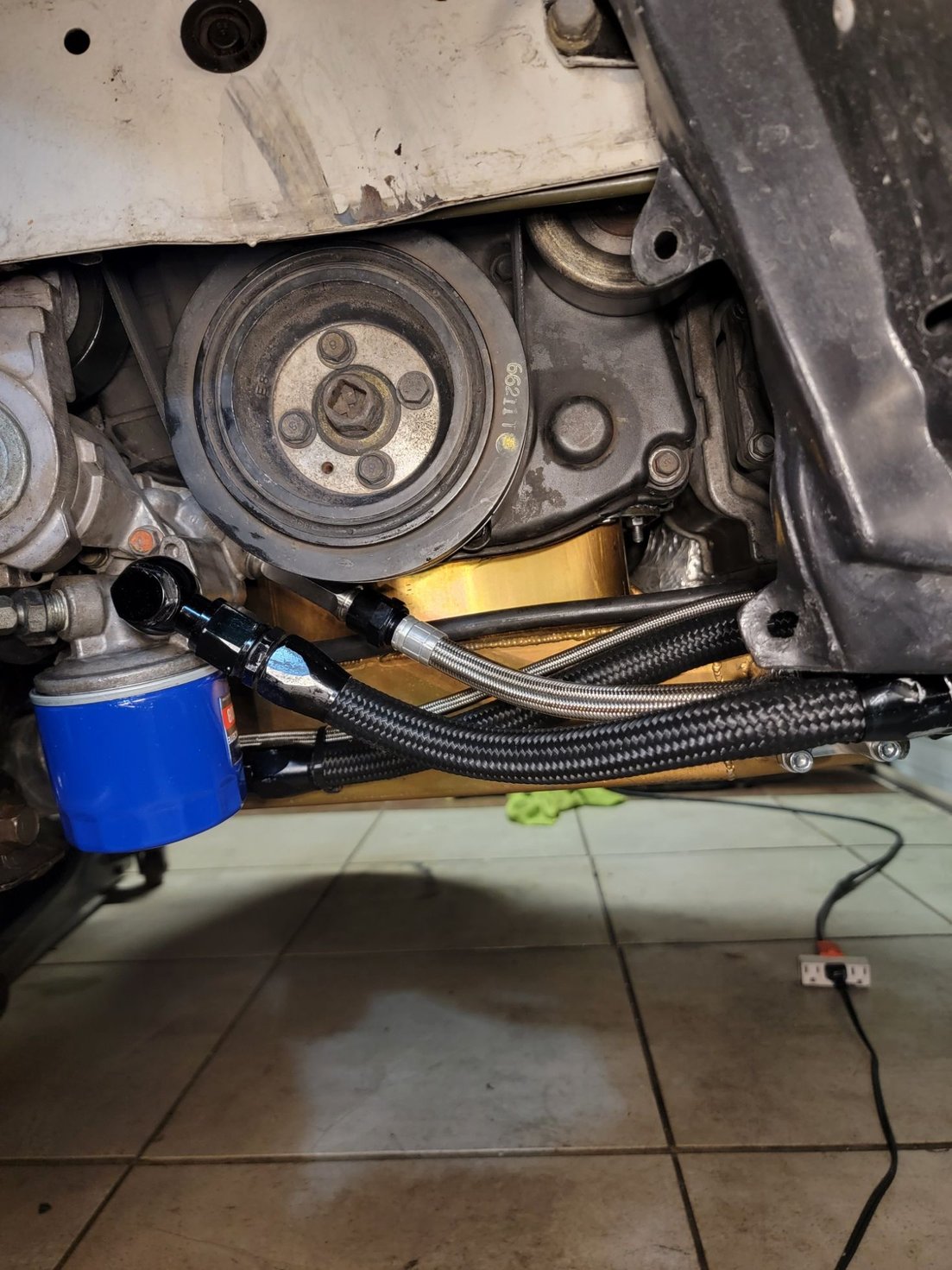

ooh i kinda needed that. my setrab oil cooler fitting is competing for space I ordered some AN fittings to see if I can straighten the lines a bit. not a big deal

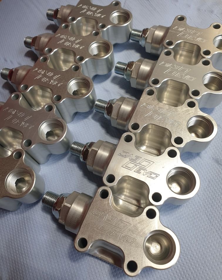

Originally Posted by RSMike
Had to wait 4 months for XRP to make these fittings!
Waiting only 4 months for something would be a dream come true in my industry right now.
Hows your ground clearance with that 10AN black line under the regulator?
Do you have any space to route it above the reg?
its low and actually ziptie my bottom cover on that hose BUT I was in a rush to get the car ready for the season opener. I just got AN fittings today and will now try rerouting

ok done

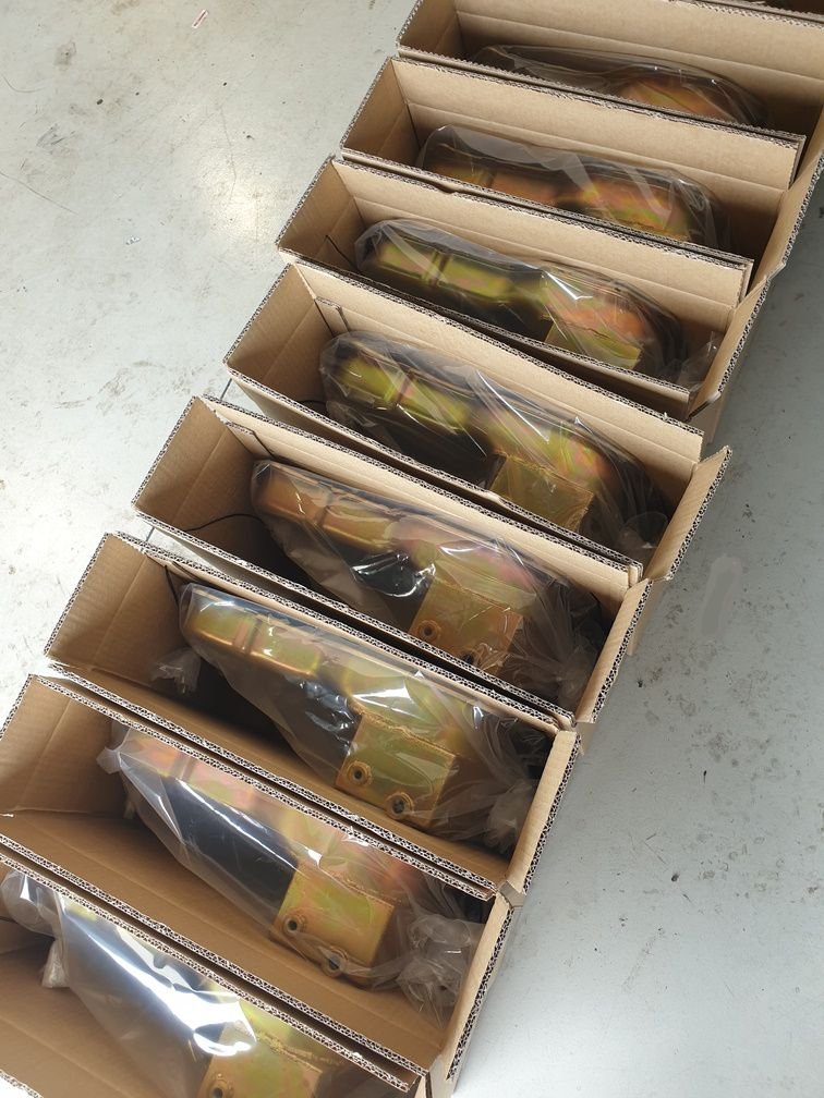

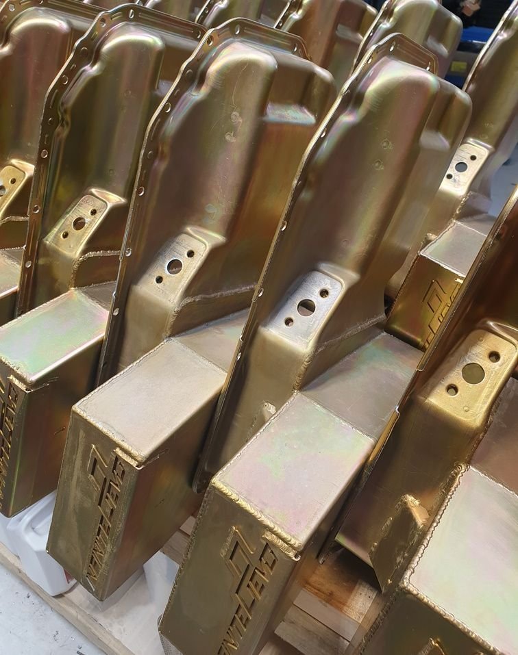

A new batch of 26 Infinite Evo oil pans is now finished, with 10 available for immediate shipment.
Serial numbers 51 to 60 are boxed up and ready to go.
Thinking about making serial number #100 free! It will be a huge milestone for the project.
