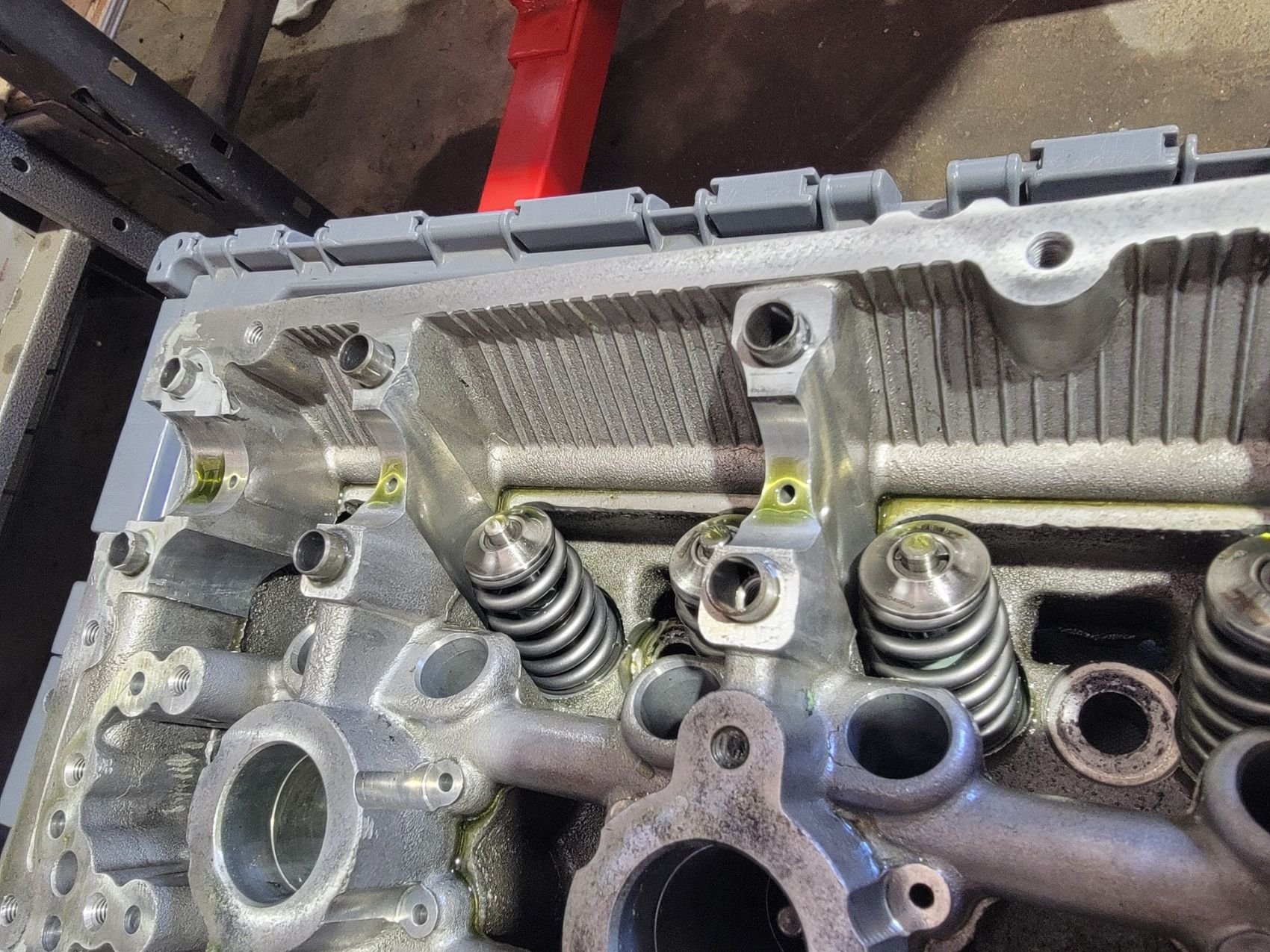

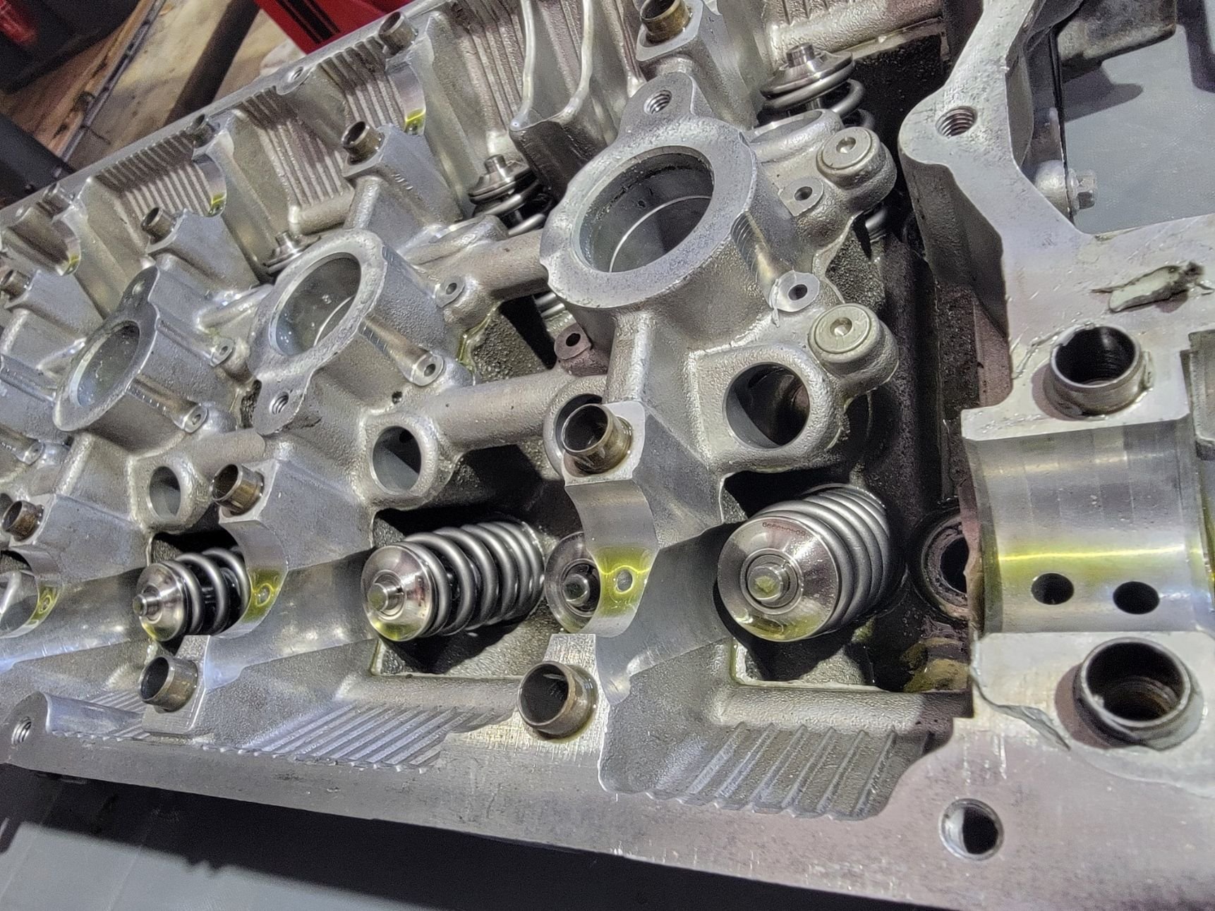

I also had normal oil pressures while idling and slight revving after the knock started. I had to test if its the transmission again by pressing the clutch while idling. when I got the car home I removed the valve cover to see if my new cams are "worn down" or if a rocker flew off or if a lifter died. the oil is very clean up there, no scratches on the cams. nothing out of place

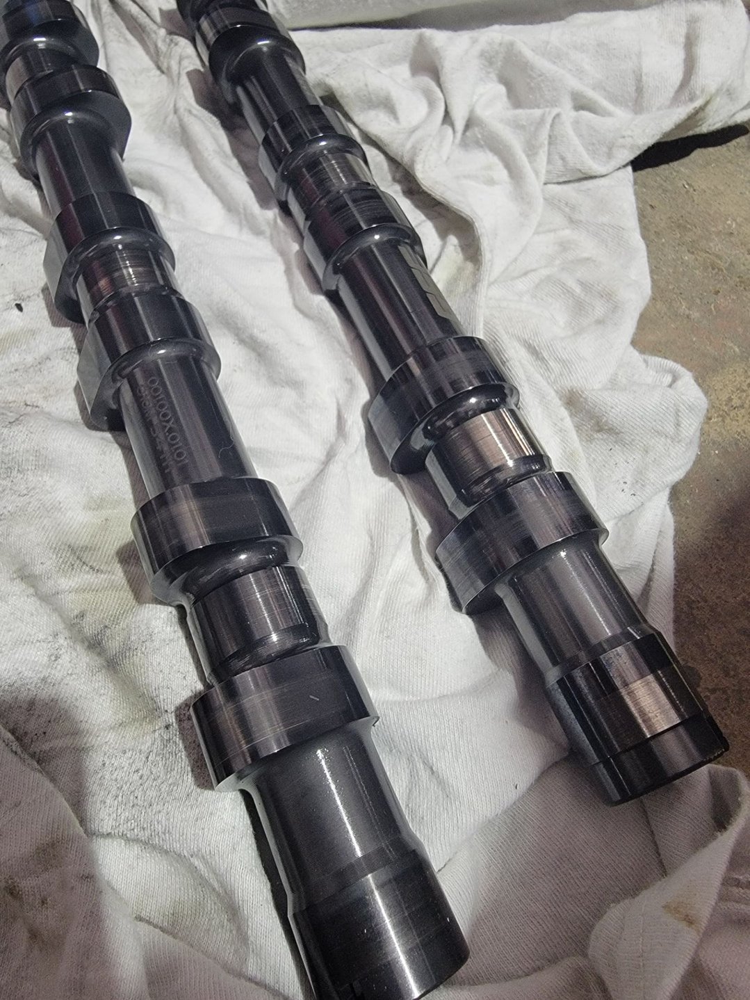

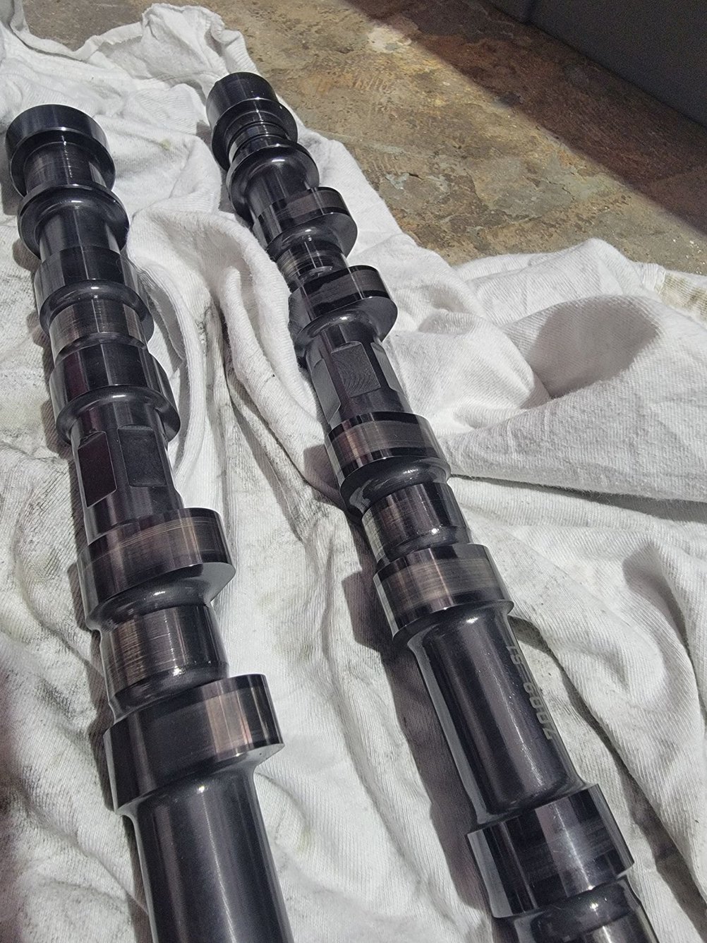

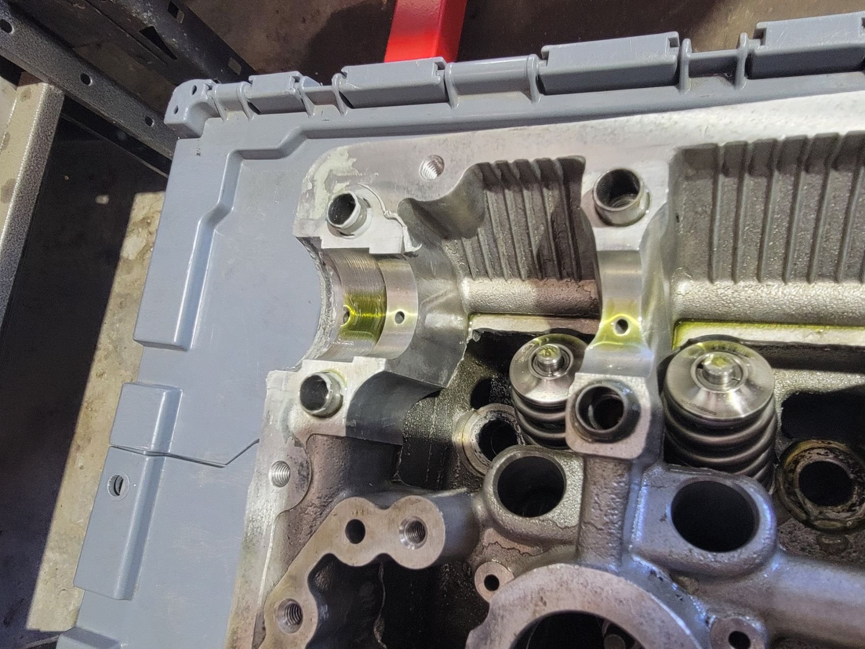

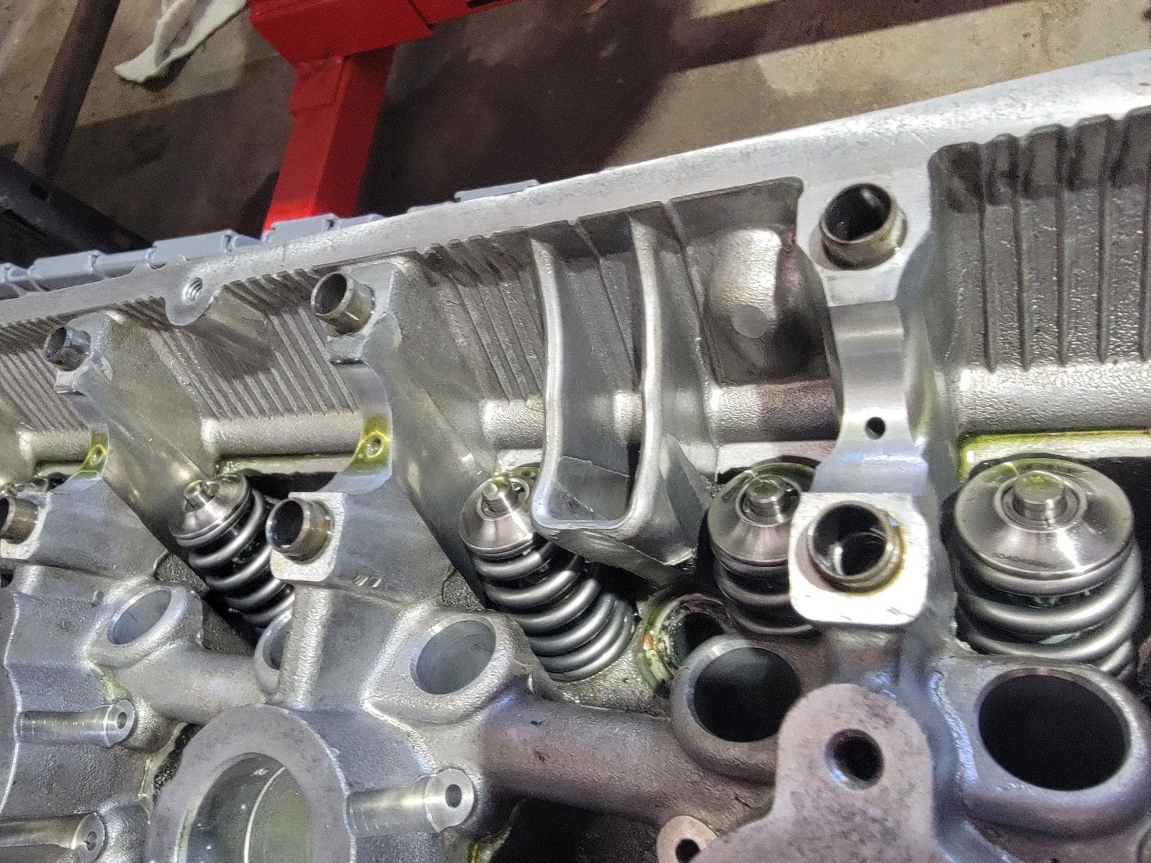

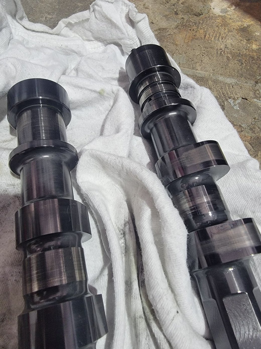

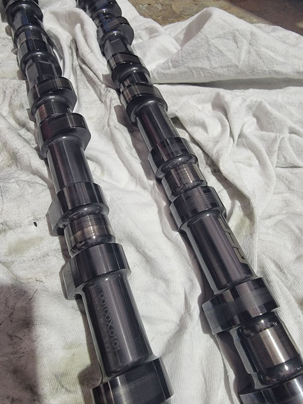

Both pump housings and gears. Camshafts, and the camshaft journals in the head, piston skirts. Anything that is an oil lubricated wear surface...

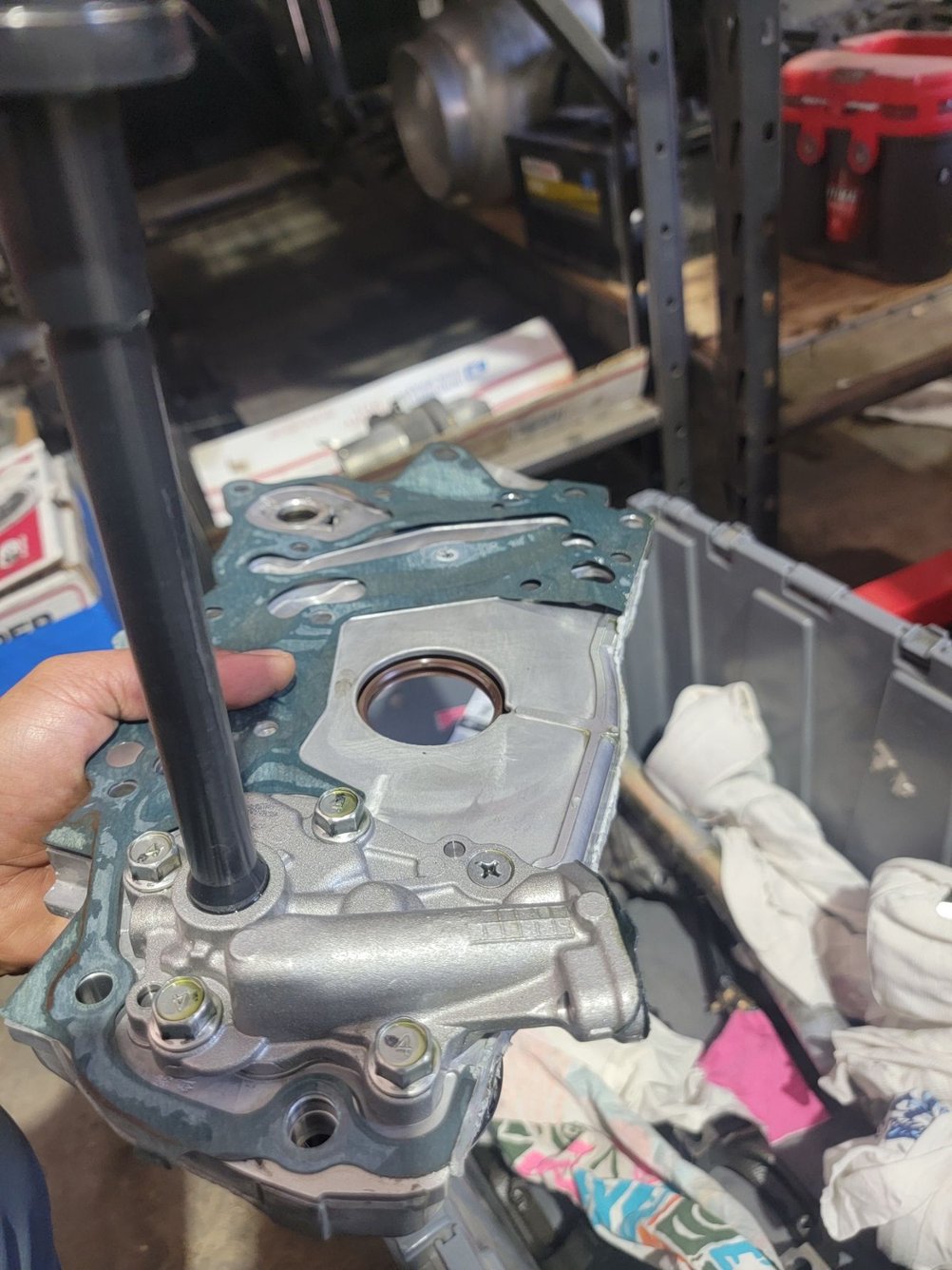

I think what Sean might be getting at, if you had a bearing burn up from lack of oil and it was because of oil pressure loss then you'd certainly see it in more places. 8k rpm will definitely put the rod bearings near the top of loaded components but the first place that you'd see wear is the pump housing because the gears are spiral cut creating side loading.

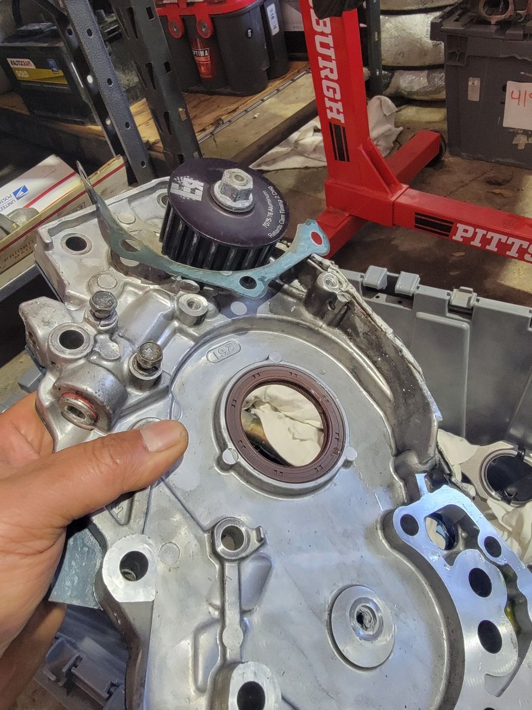

OK thanks. It is weird my previous motor didnt have this much damage even after driving it around about 1 minute to get back to the grid and also driving it around my block to try to figure it out before getting this engine rebuilt. Anyone for/against the ER pump pulley? I have to confirm if it was installed or not.

The ER oil pump gear is a good mod. Slows the pump down instead of relying on the regulator to bypass oil.
All of my race engines get one if they aren't dry sump.

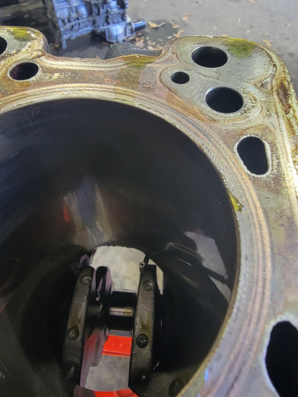

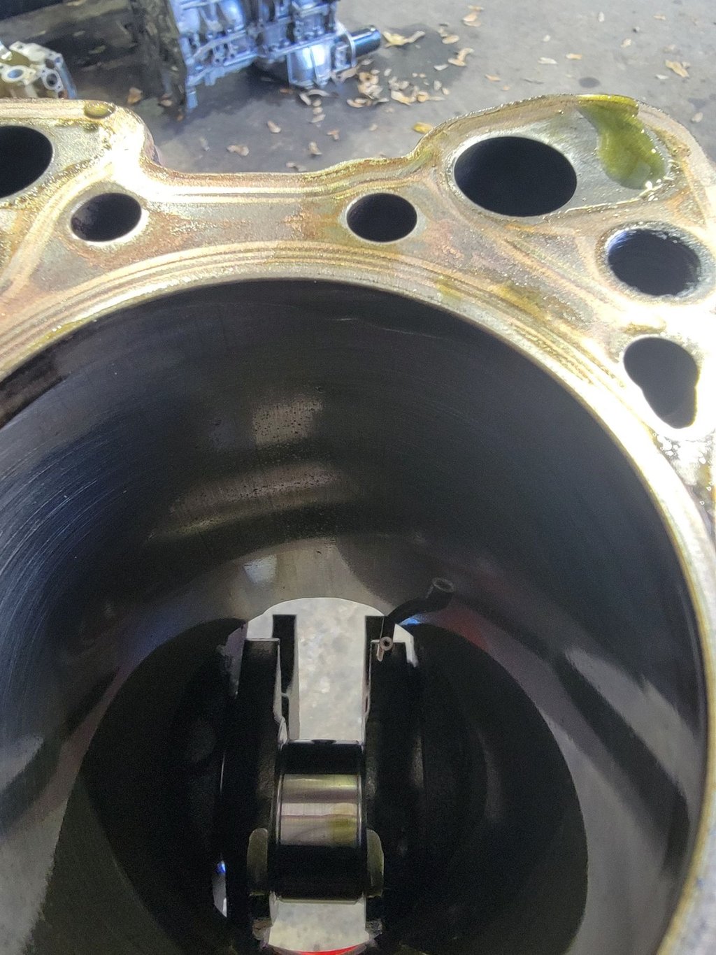

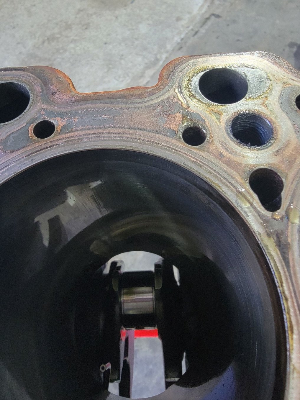

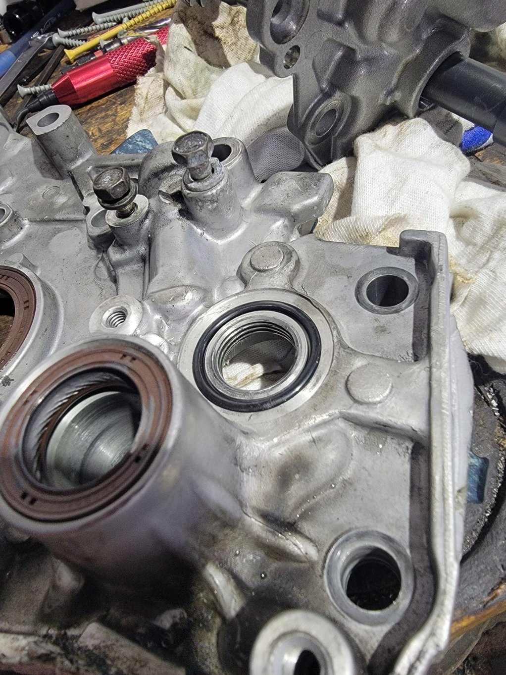

Apologies I forgot to take pics of the piston skirts and crankshaft. everything still has oil and I didnt clean them in order to have the best view of the condition of the surfaces. the block was on the rotisserie/stand with the crank shaft so flipping it around to take pics was a bit of effort. It still have plenty of oil flowing down after flipping it. the bearing surfaces on the crank looks like the least-worst bearing on those rods

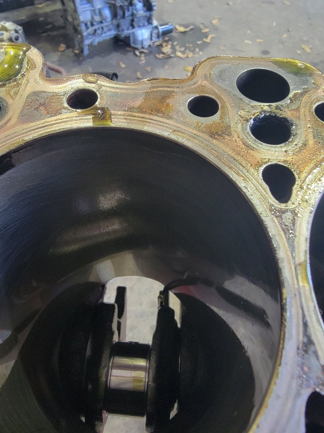

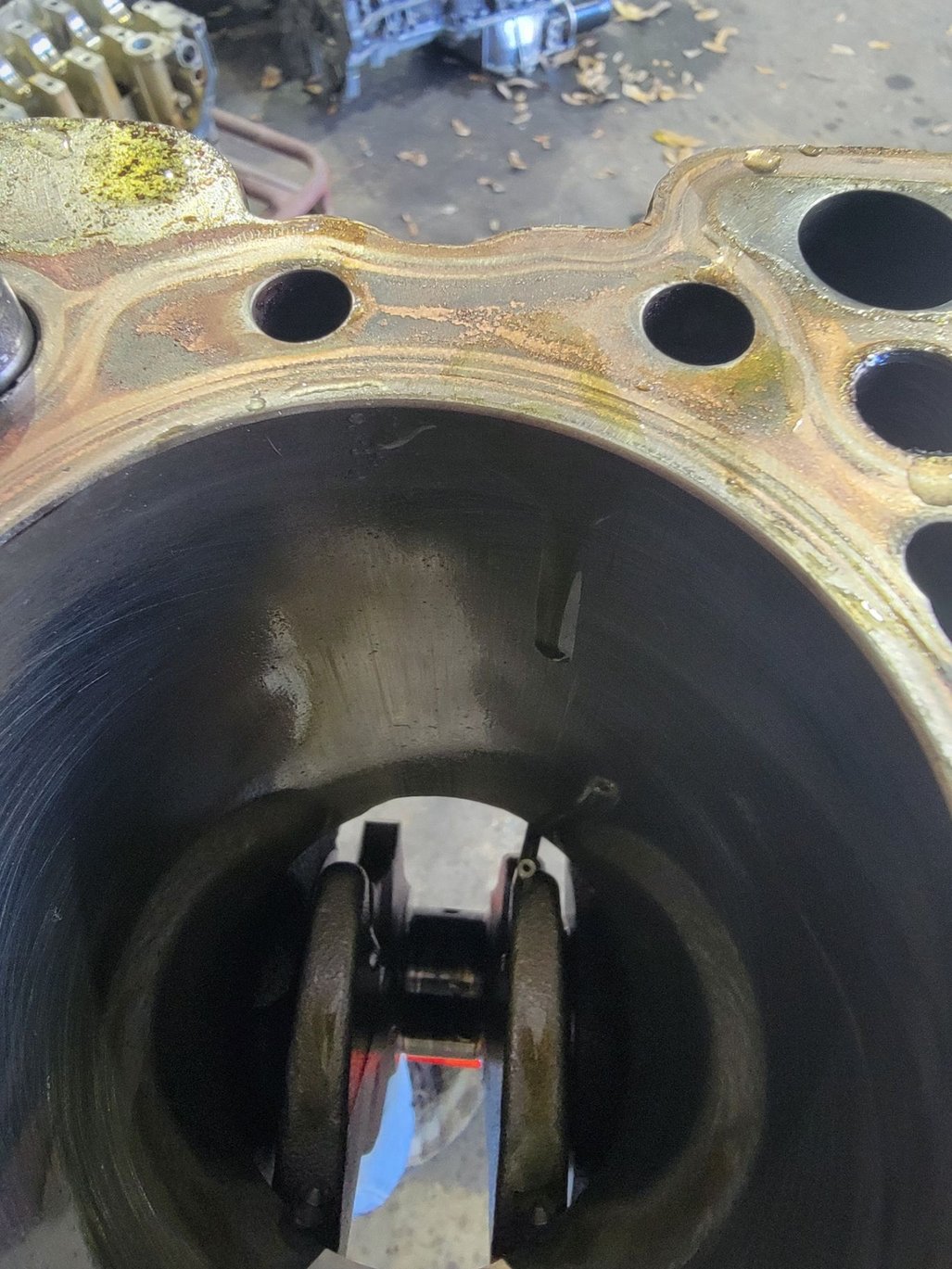

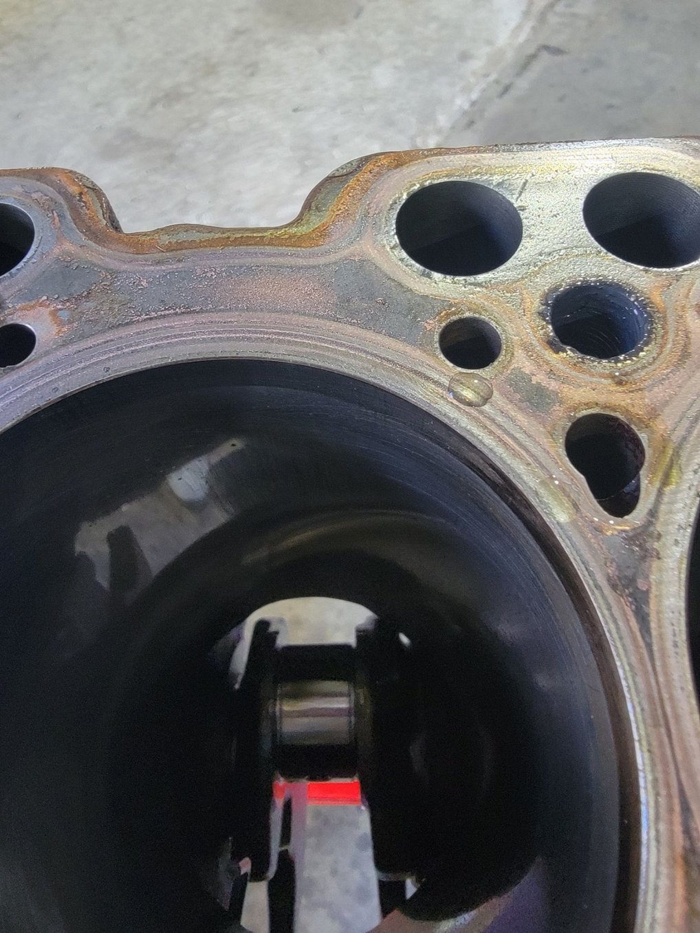

I should have cleaned it first. but this is still good, no damage on the cylinder walls and piston skirt

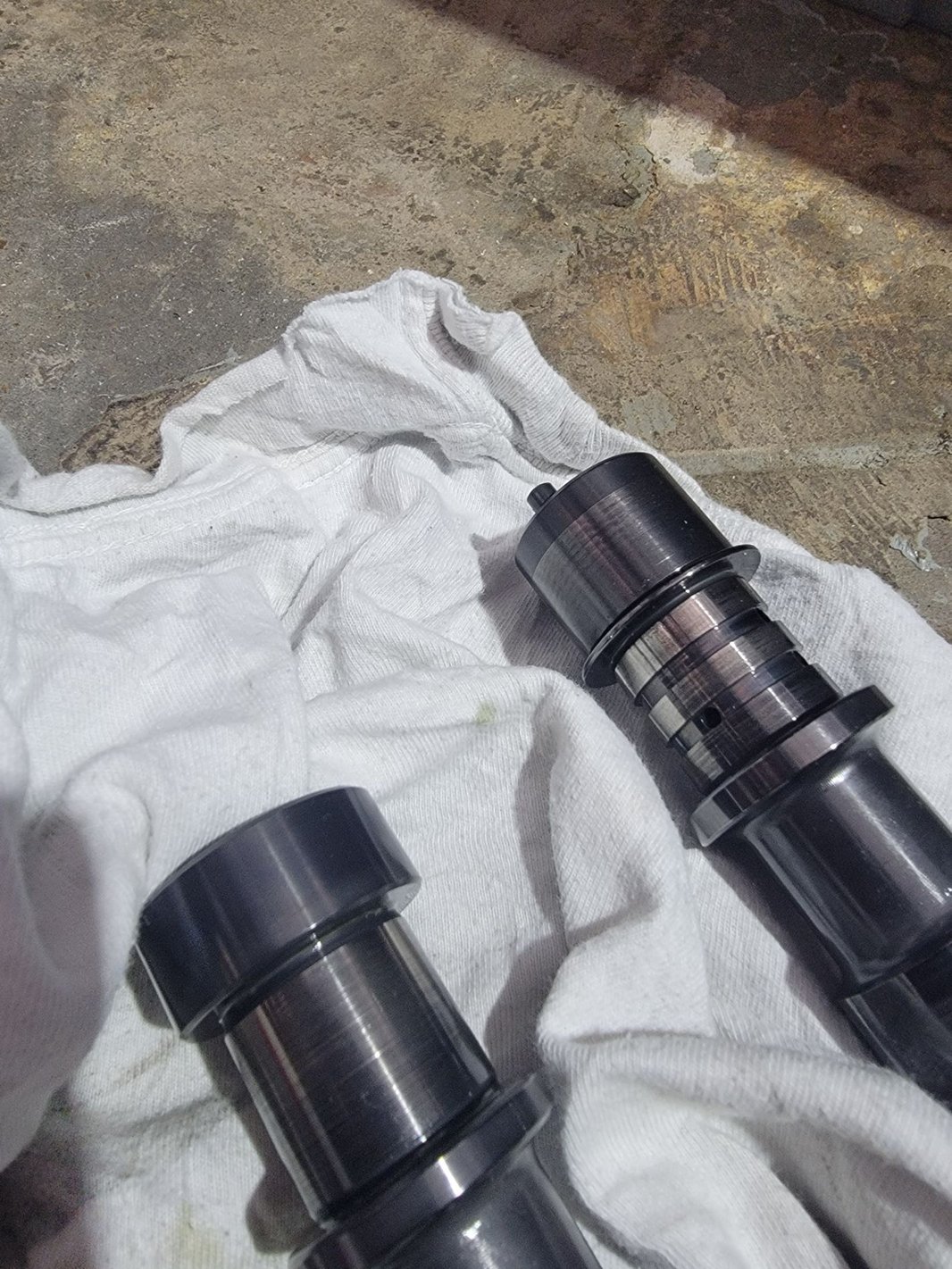

not sure if this is reusable

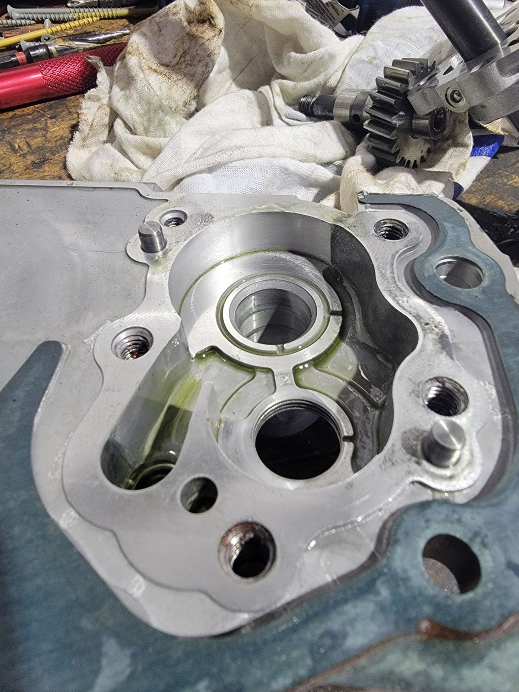

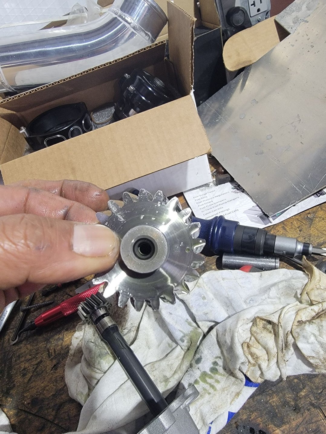

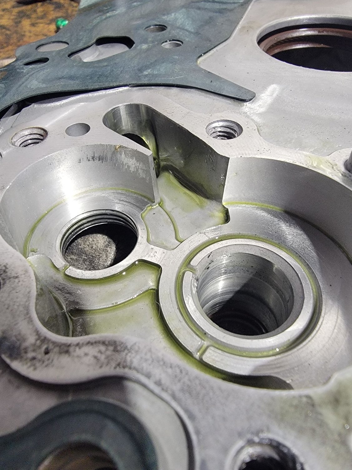

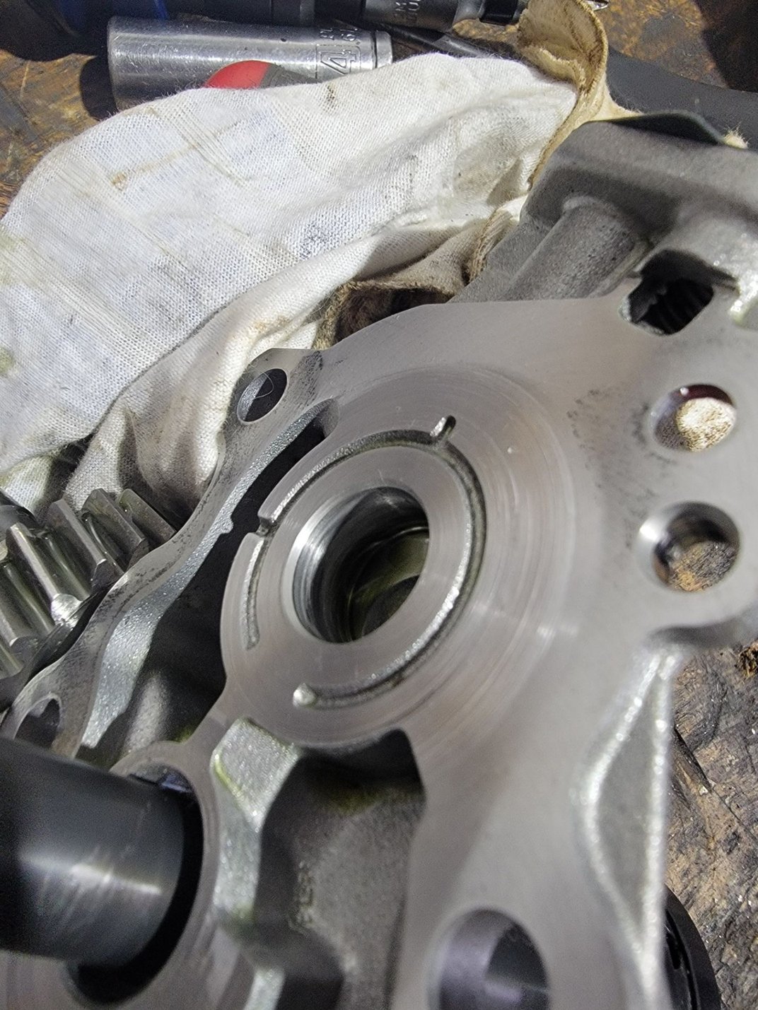

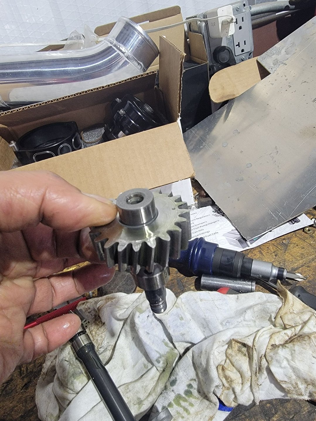

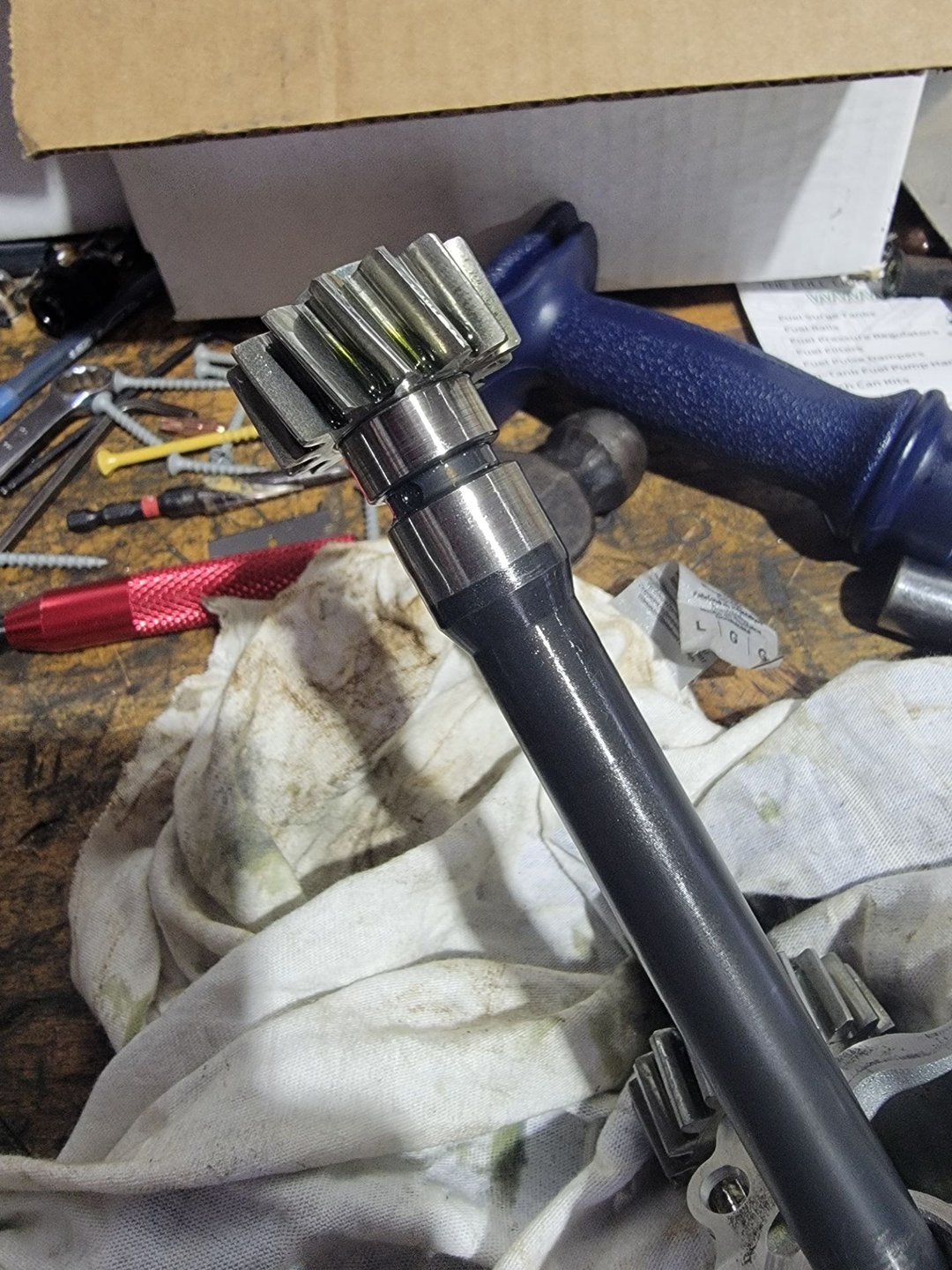

The oil pump was still assembled for some reason. i turned it and it feels like some vacuum - meaning it doesnt free wheel when you spin it. no shaft play, no friction
the pic looks bad but its just the oil dripping and reflection. It looks fine aside from metal bits scratching the housing wall. I can take pics again later
