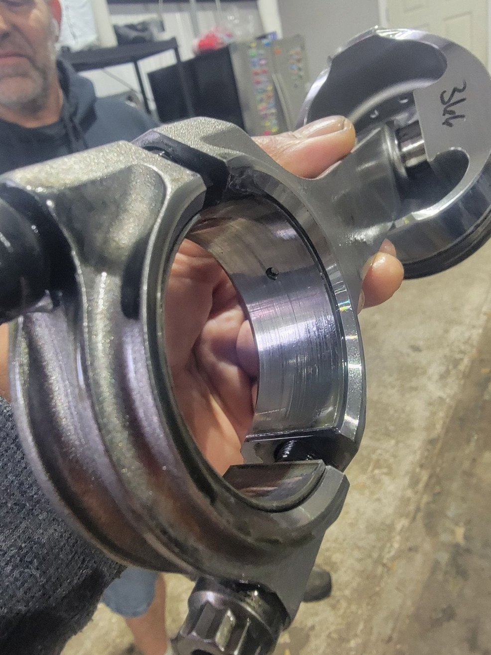

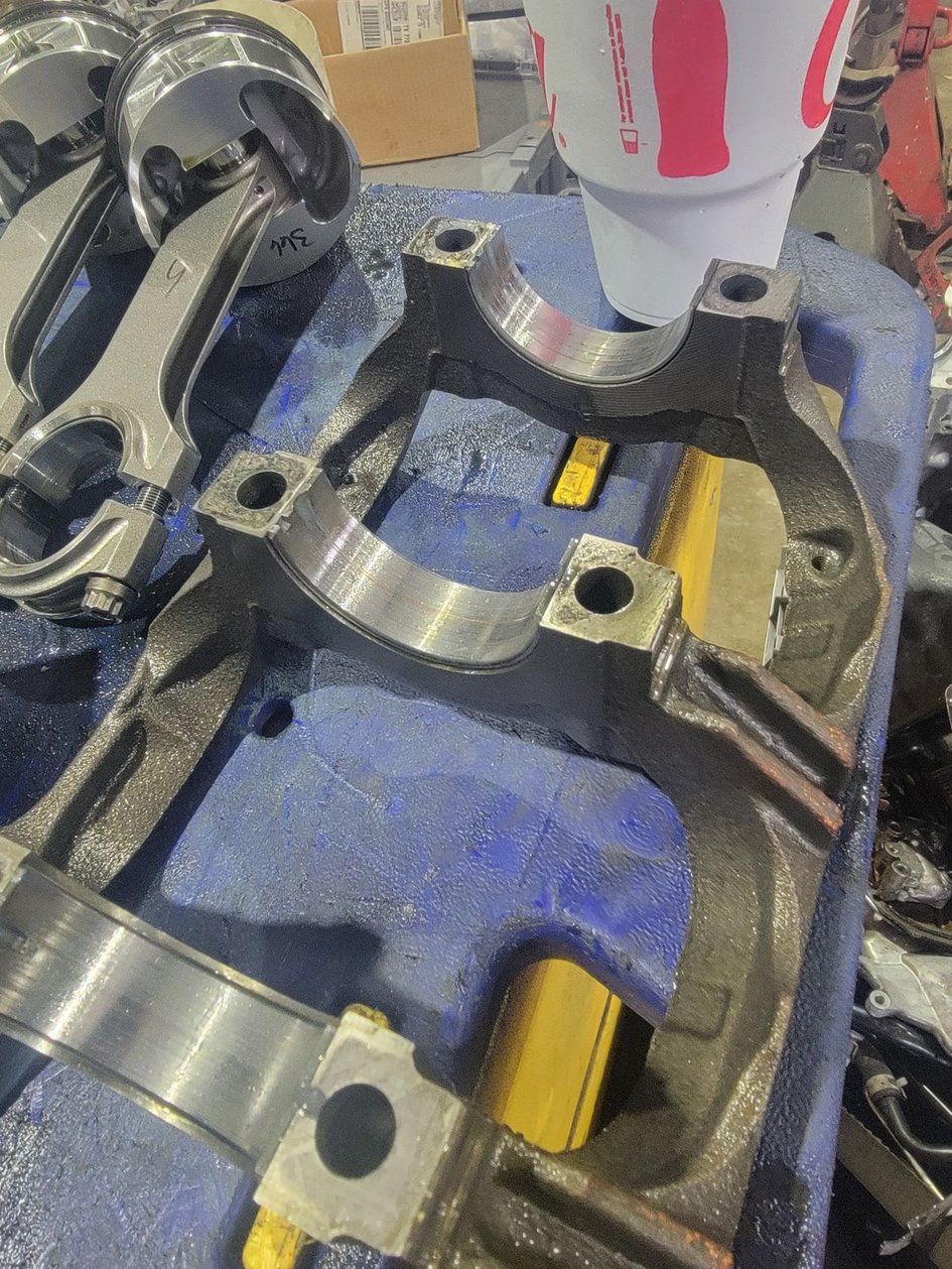

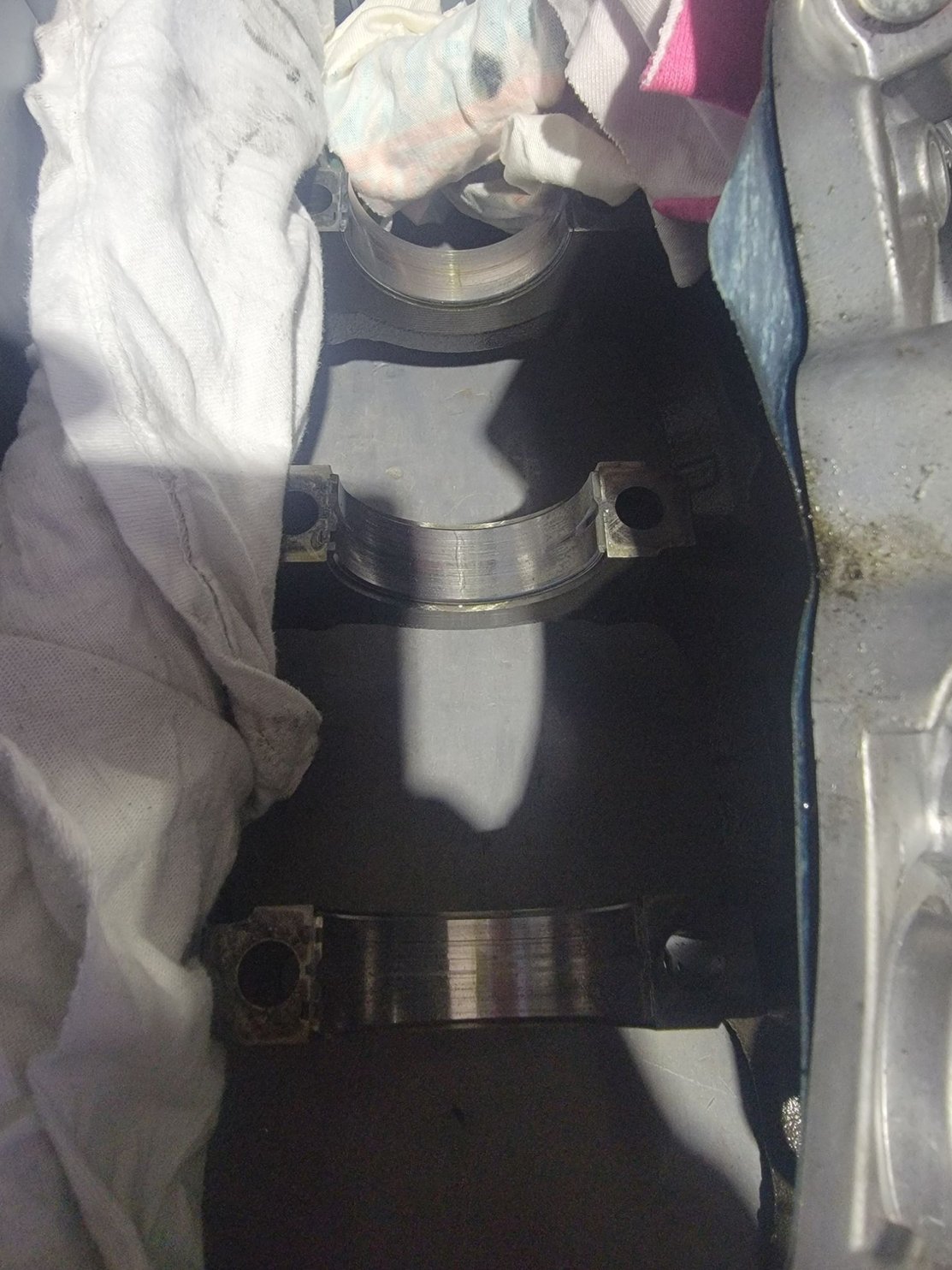

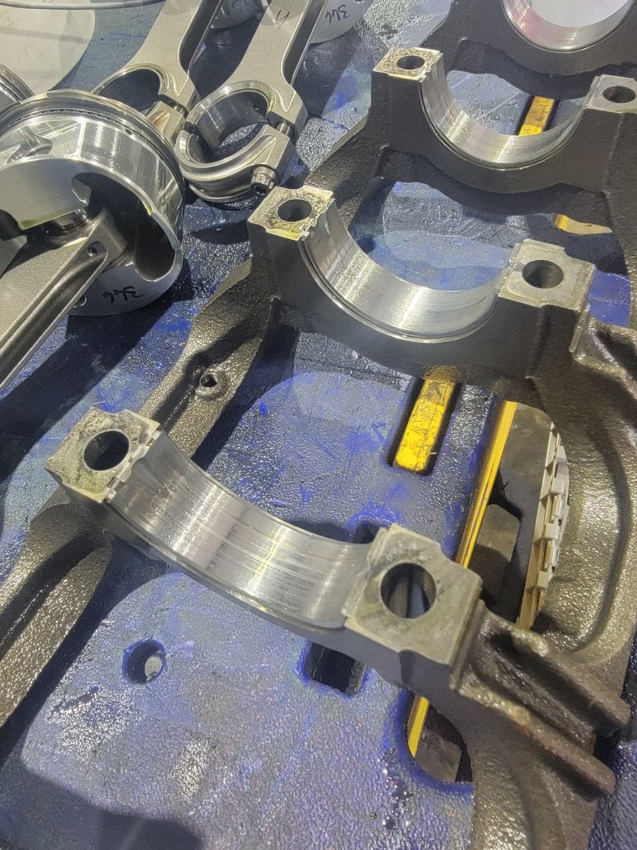

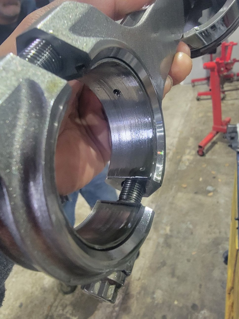

So I went to visit the shop today. I asked about clearances and he said "2.5" ... I dont know what that means and I dont know if I asked the question correctly.
As it turned out all the bearings are scratched up, quite evenly except for #1. It just so happened that the #1 made the rod knock sound
I just checked the "backed up by data" it seems there's no data above 7800rpm (which is understandable). well that sucks, i may have fallen for eye candy again
The engine builder said he has not seen this type of design where the oil pressure regulator is relieving on the side of the pan, speculating maybe some aeration or just oil flow patterns made by the rubbery gates is actually going/pushing away from the oil pickup and out of that small compartment at certain rpm/oil pressure. Nobody knows. There's no data. No trash talking, all speculation.
We're going to try to rebuild. No warranty even if I use the OE oil pan/regulator. Fine, i bet this autocross business and no logging is a liability. I told him I'd keep using the IE oil pan, we'll see if it happens again even with a lower rev limit. While driving home, I'm wavering a little about that. The issue is repeatable and hard to ignore.. There's got to be some science there. Statistics?
Stupid me is thinking I should have a 2.4l project on the side, I just thought that has more headroom for reliability & improvement. I dont know anything. Downtime sucks.

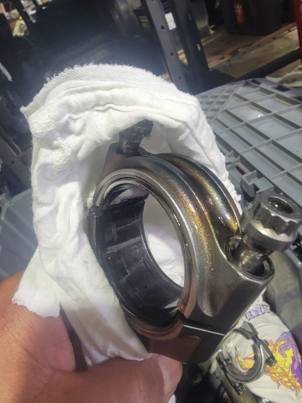

It seems more than 1 cap is burnt. i just noticed it now and didnt inspect all of them

Jesus that thing got wrecked. Every bearing is hurt.
Need pictures of the oil pump...

Those bearings are beat. Might be contaminated oil or bearing tolerances are way off.
