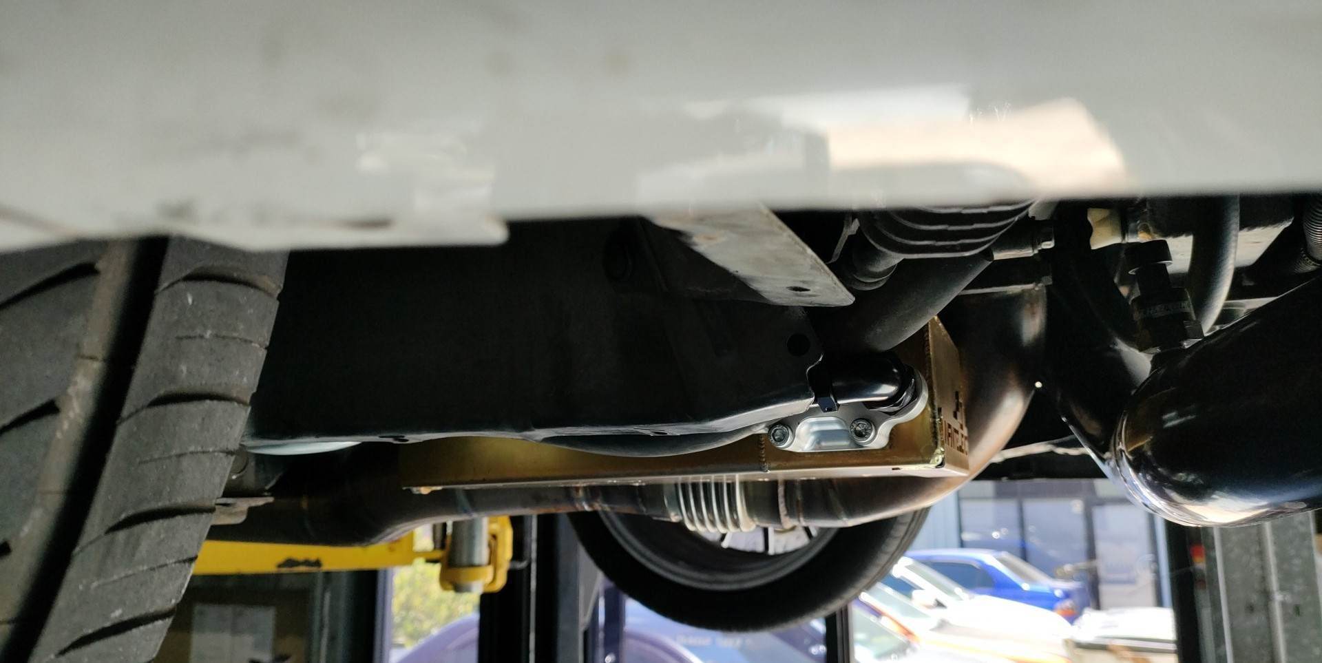

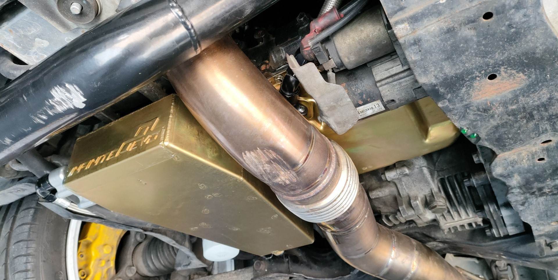

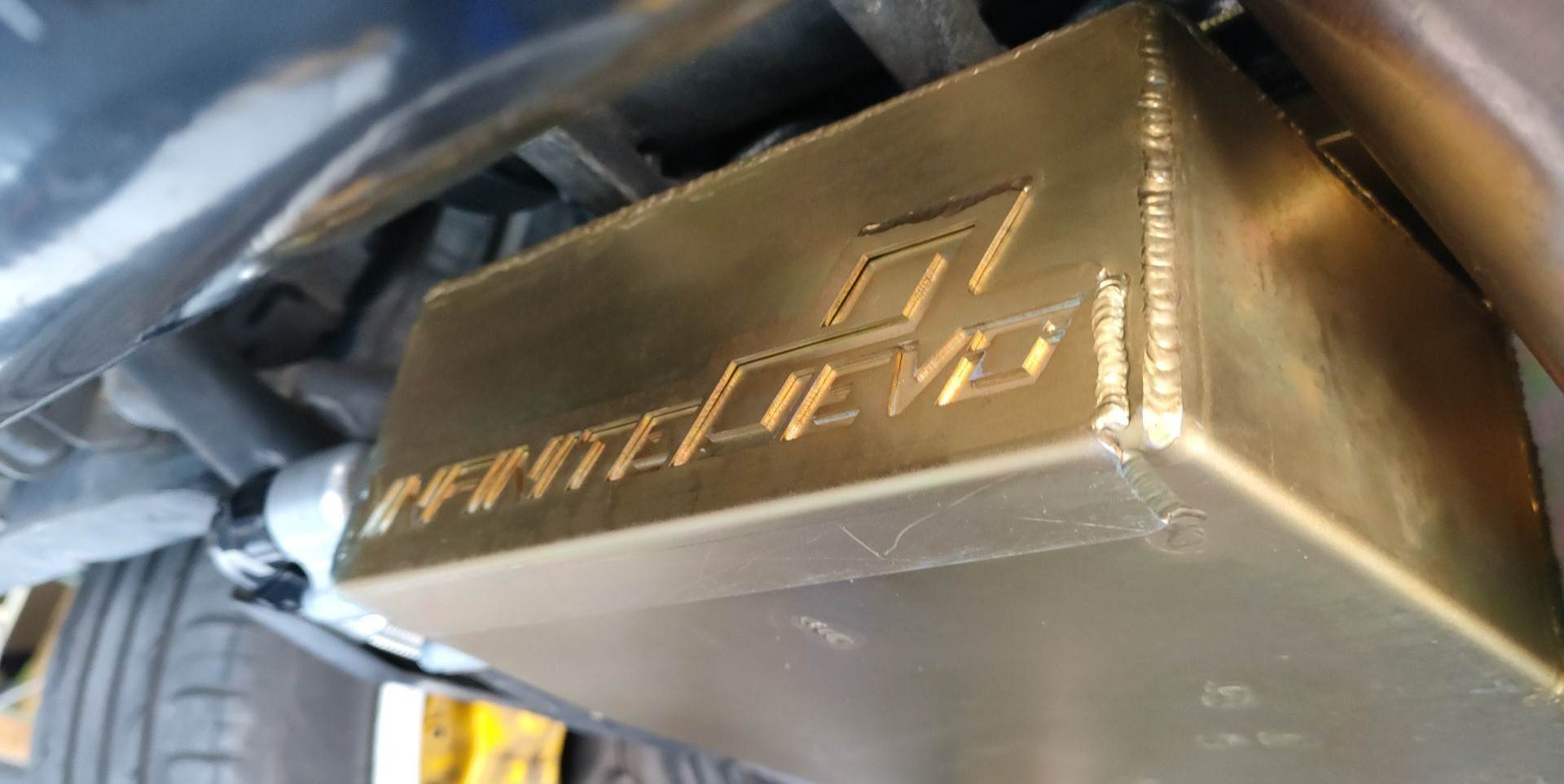

Some installed pics on a car with OEM oil cooler and lines. The lines do need some **very** slight tweaking, but they do work and fit.
This car has 3.5" exhaust.
Pics from Benchmark Solutions in Australia

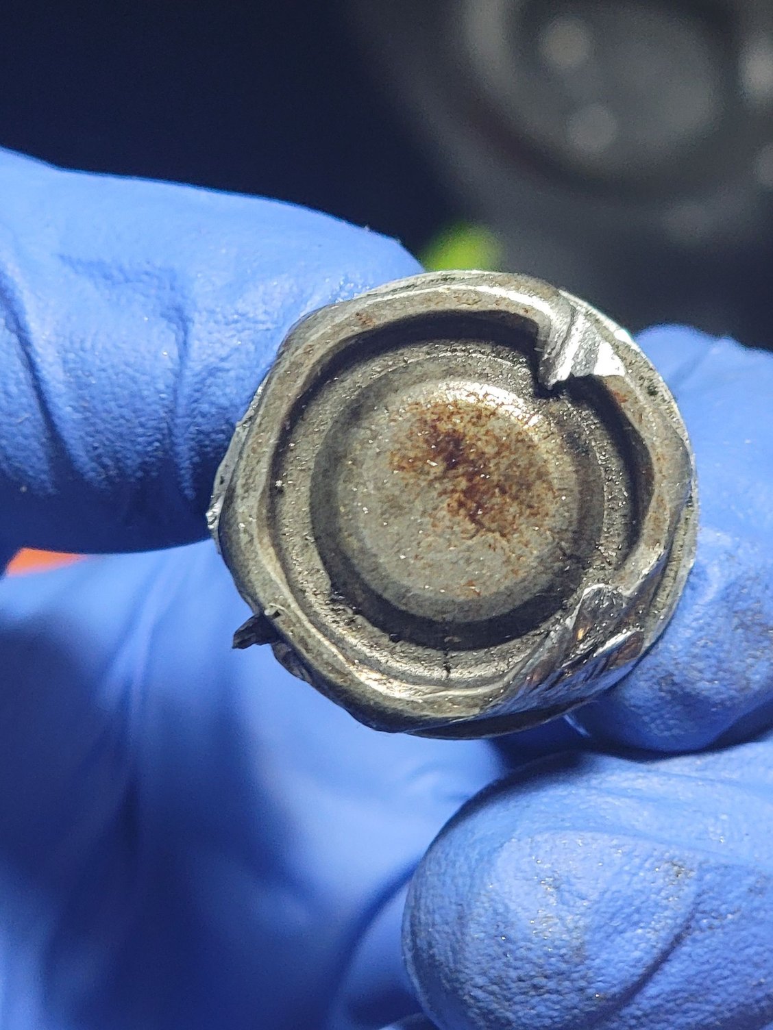

Originally Posted by Bee-Raddd
Theres always a tool if your creative enough haha.
It's called a 'cold chisel' for me (not recommending of course). F that thermostat.

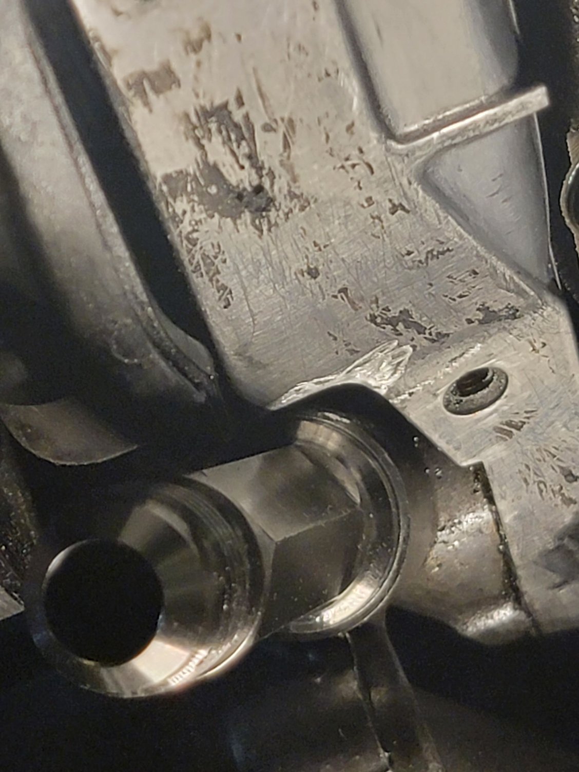

Happy to report, my stiff fingers got it done and the the oil pan is in.
Need to make a little adjustment to my 10AN oil cooler line. Also, I had to grind a corner from my front cover/oil pump

Yeah, that bypass valve is tought to get out.

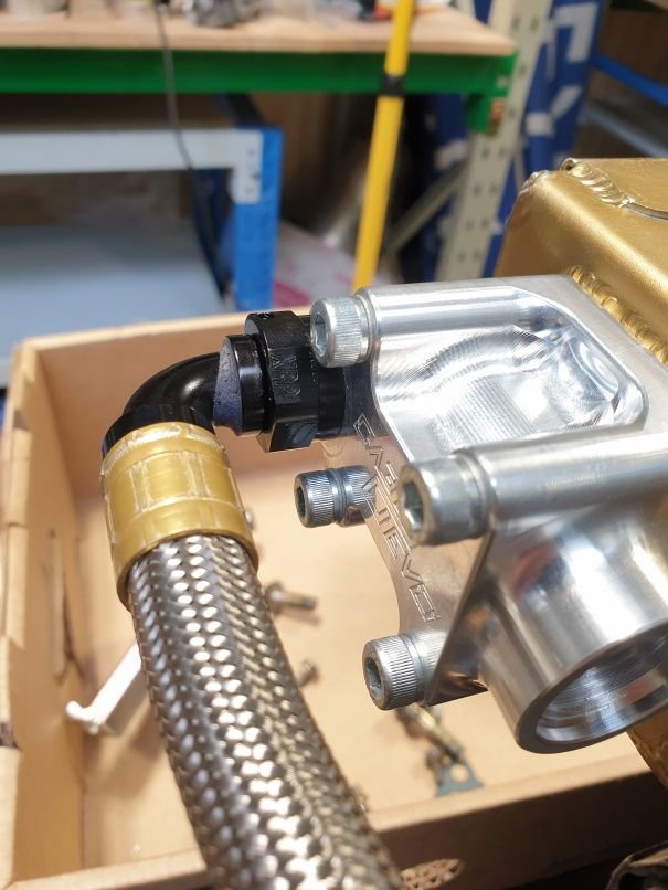

New XRP 8AN male ORB fitting going directly into the regulator body. This eliminates a fitting and allows for a tighter oil line (closer to engine).
Had to wait 4 months for XRP to make these fittings!
