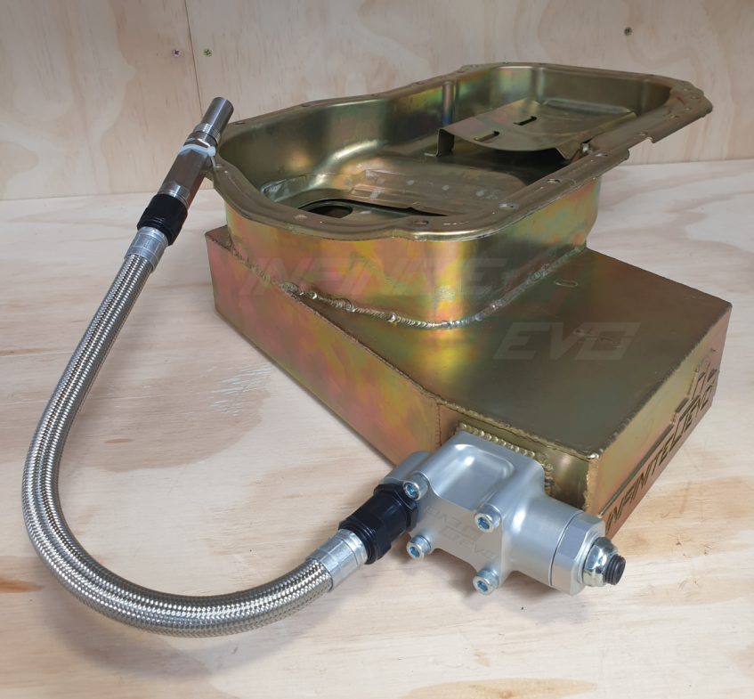

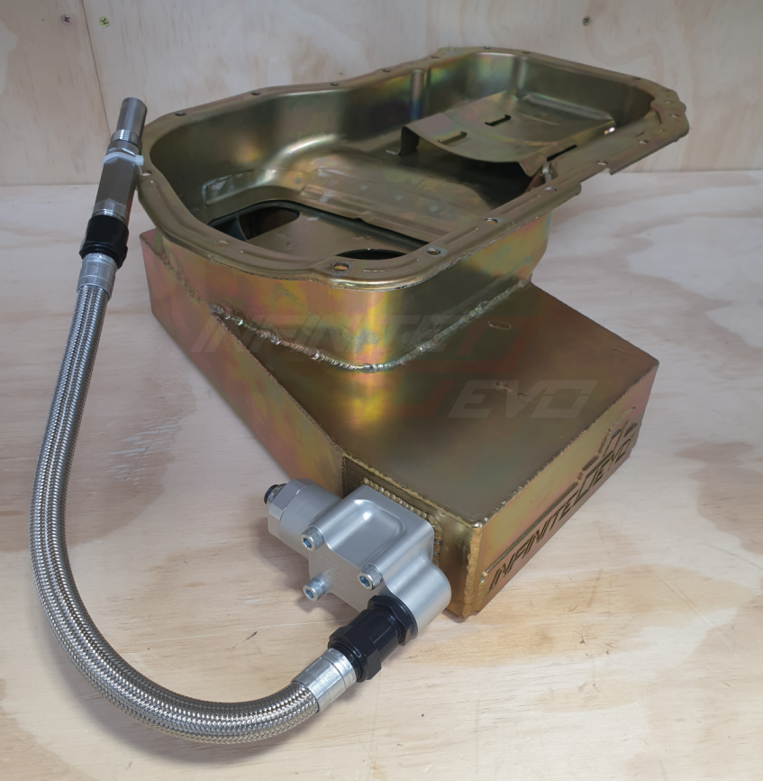

Here are a couple of pics with the regulator, to give people an idea of the final product.
The regulator can be mounted in either direction, depending on fitment and requirements.
The fitting at the end of the braided hose goes into the oil filter housing.

Old Mar 9, 2022 | 09:30 PM
  #34
ViciousLSD's Avatar
Joined: Oct 2011
Posts: 3,858
Likes: 600
From: Houston
Will it fit with AC?
Old Mar 9, 2022 | 11:28 PM
  #35
RSMike's Avatar
Joined: Jul 2009
Posts: 2,276
Likes: 372
From: New Zealand
100% yes !

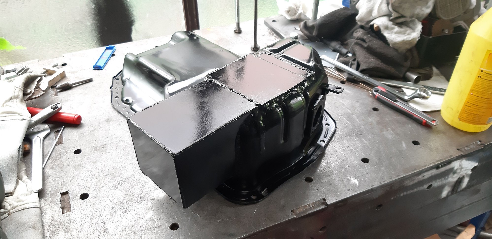

Originally Posted by RSMike
And we've worked it around the OEM pickup, so that doesn't get modified either.
If you knew what I went though when I made my pan you would understand why I got a chuckle out of this comment.
Long story. Ignore me lol
