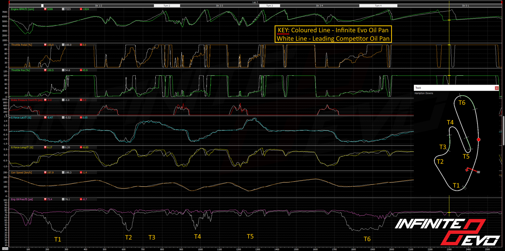

Thanks for your patience guys.
We've finally done a true back-to-back test with our pan against the "leading competitor" unit.
Same car, same tyres, same oil, same oil level, same driver, etc.
No changes were made to the car between runs. They were 6 days apart.
Massive gains on all right-hand corners, with a huge reduction in oil surge.
There is still a little surge on the last corner (T6) as it's over 8-seconds long. But only dipping to ~63psi (not ~35psi).
**Oil pressure sensor is in the mains gallery, not the oil filter housing. Oil filter housing will read 10-12psi higher.
I'm extremely happy with the results, there is now another option rather than going straight to dry-sump for the Evo platform.

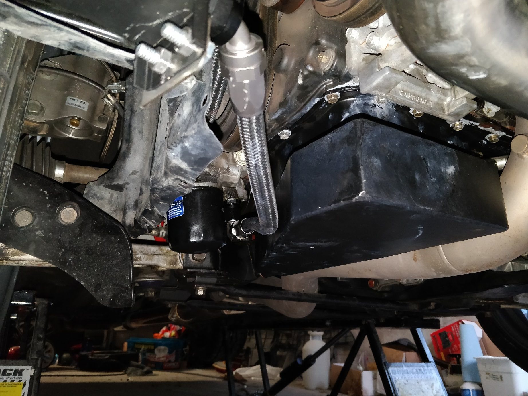

clearance to downpipe still the same? and i've already got racefab's modified pickup (and no stock pickup) will it still work, or do I need to grab a stock oil pickup

Yup clearance is similar, should be slightly more with ours. I'm running a 3.5" exhaust on our shop Evo 6.
But it does stick out ~110mm forward from the standard oil pan position.
So around another 60mm over the Racefab unit.
Lower intercooler piping (LICP) would be the only potential issue. But I think it'll work with most kits. As most kits keep the LICP close to the underside of the radiator.
Yes you'll need an OEM Evo 9 oil pump pickup. Part number MD343947.

shouldn't be any clearance issue to LICP, here's a pic of my racefab, LICP in the upper right of the picture.
def in for a few pics of the pan installed.
