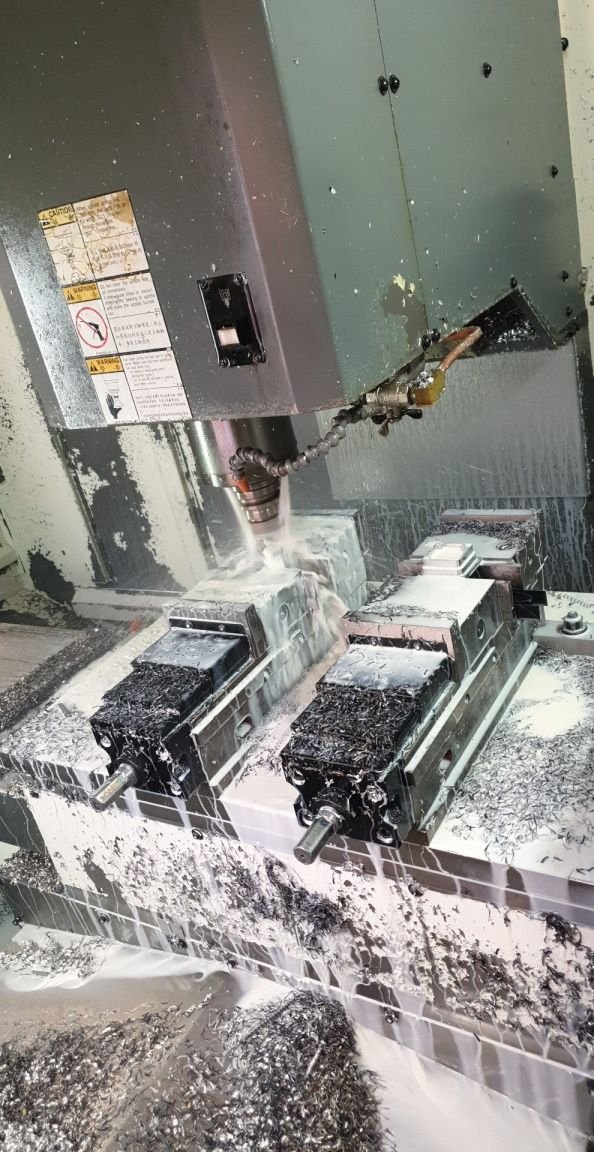

2 pieces of steel loaded into the machine vices, ready to go
CNC working it's magic

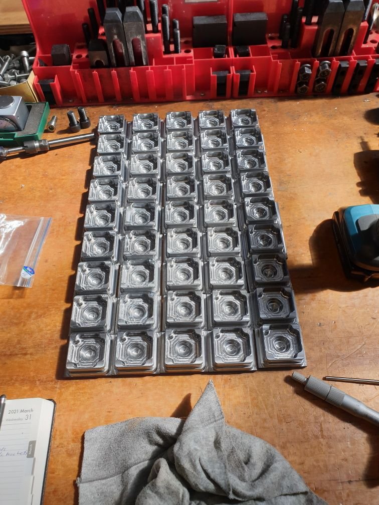

Tetris anyone?
45 bases finished op.1 in the CNC machine

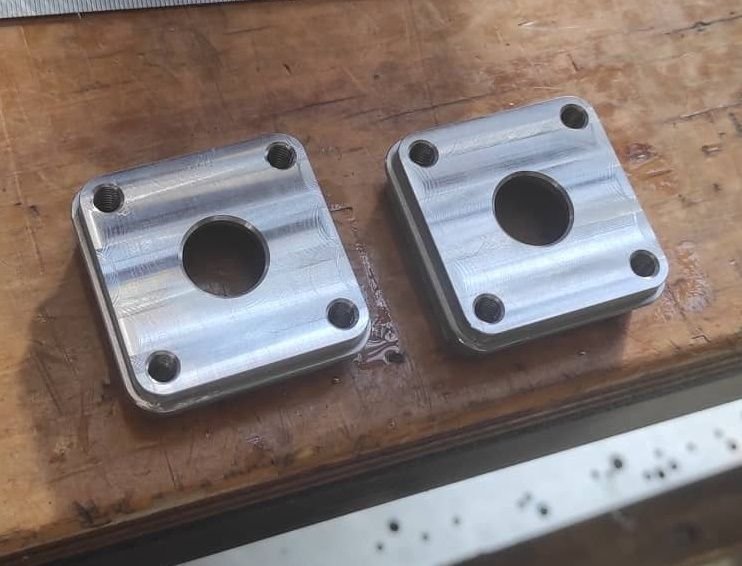

This is what they will look like after Op.2 has been completed. It's ready to weld into the oil pan.

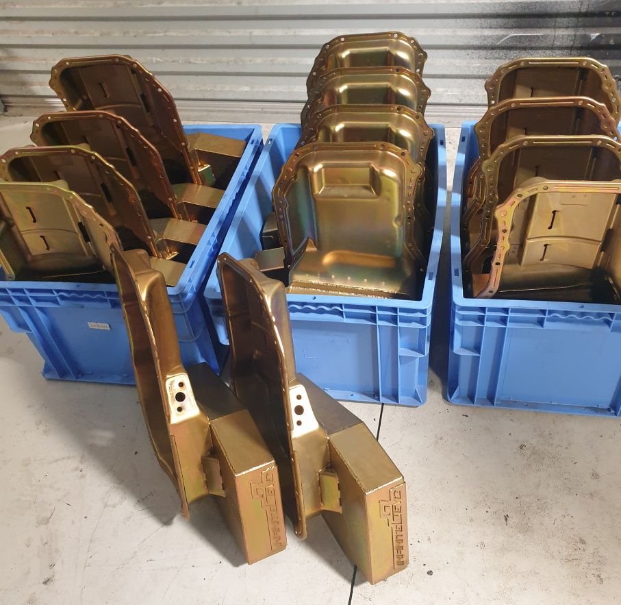

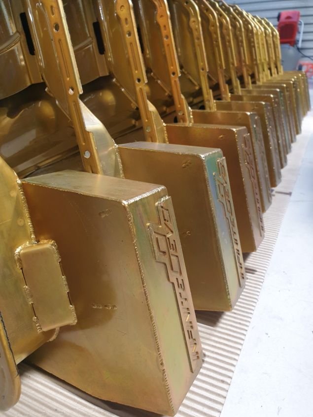

We got some pans back from the zinc plater today also. These get blown out and then coated with a lubricant to prevent corrosion during shipping.

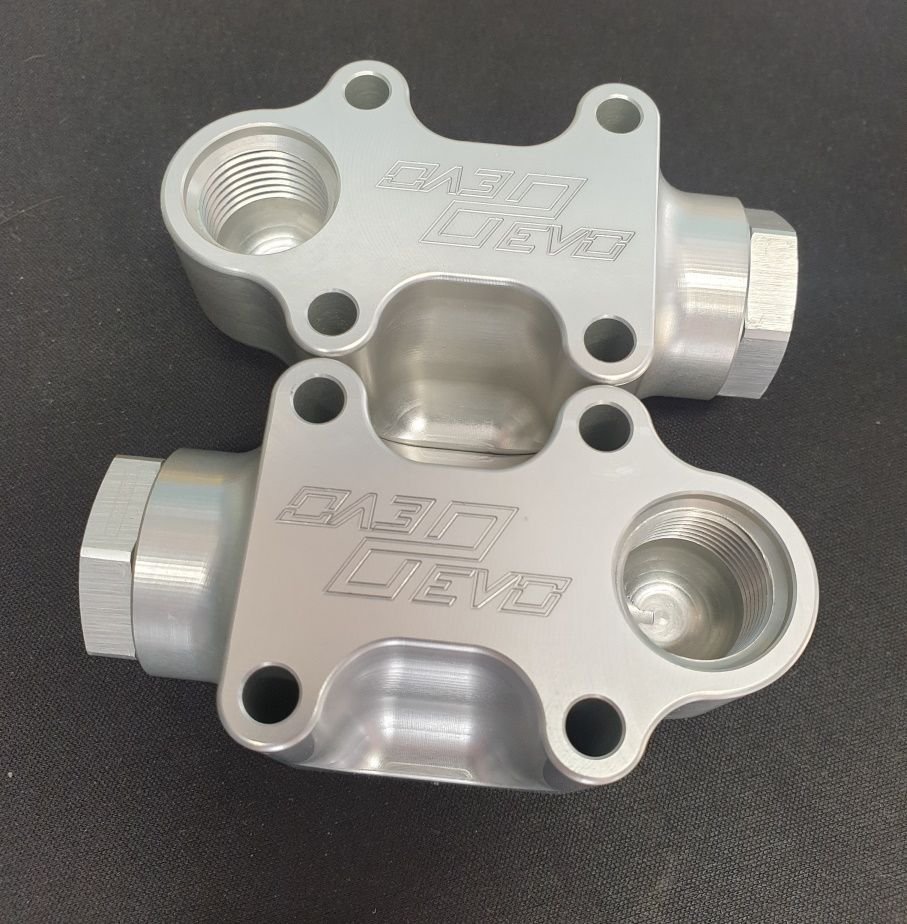

Regulators are back from Natural anodise also. This helps to keep the regulator looking good for years to come.
This is revision 4 of the Regulator!
