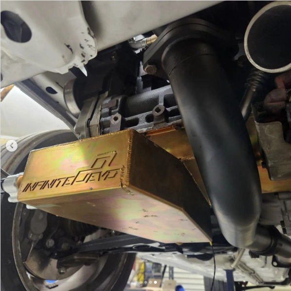

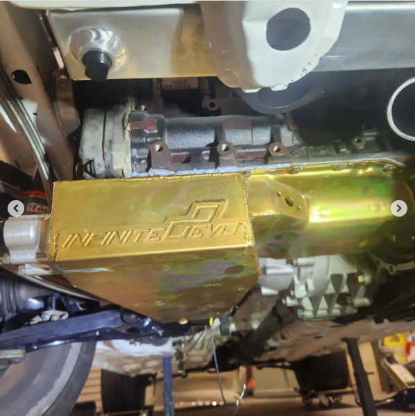

Some more pics of customer's installs - this one from "Shardieracingevo6" on Instagram, in Australia
All oil pan kits come with instructions and decals/stickers
Good exhaust clearance!
