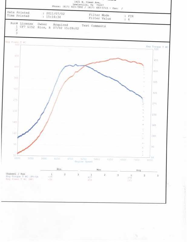

so here are the results from last week on the dyno!
we dynoed rodericks evo first on saturday.
FP red, E85, bolt ons, 30psi spike tapering to 26 because the aeromotive 340 pump couldn't keep up.
made 458/427
second on the dyno was quincy. we are trying to get back the power hes had in the car, so this gave us an idea of where we are at now, and we upgraded the injectors to 1450cc so that we can make 500+ which the car is capable of on E85.
420whp/358ftlb on 93 oct @29psi. it has the revolover 264 cams which i have never liked, so we are going to throw some kelford 280 cams he got ahold on to test the difference.
third on the dyno was a car i have been working on for a customer for two weeks. he brought it to me because it was way down on power from where it should be after being tuned by another local tuner. originally it made 360~whp and 342ftlb. i knew something was up because it was a 2.3L, and every bolt on possible with a bigger turbo with meth injection and AEM ECU. after getting to work on it, we took the methanol injection kit off, put FIC 1650cc injectors on it, patched his UICP, put the stock ecu back on with speed density, and got to work. right away i still knew something was amiss. we quickly realize the wastegate spring on the AMS turbo kit is a 6psi spring, for a max of 22psi. replacing it with two springs for a 20psi wastegate pressure we were able to run the boost we wanted. second, the car still felt slugish. i check the timing and realize the gears are setup for a DSM. they are about 4deg advanced. i moved them back into time and went to work with the speed density tune!
after it made 471whp 482ftlb at30 psi. he still wants 600whp though, so we are going to make some changes (turbo) and get him to his goal!
