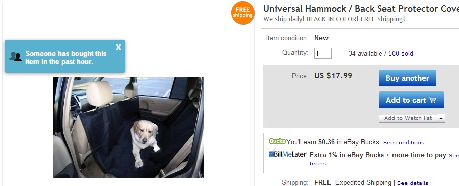

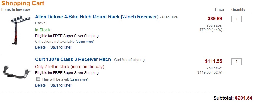

Just ordered a hitch and bike rack.
and a dog hammock
