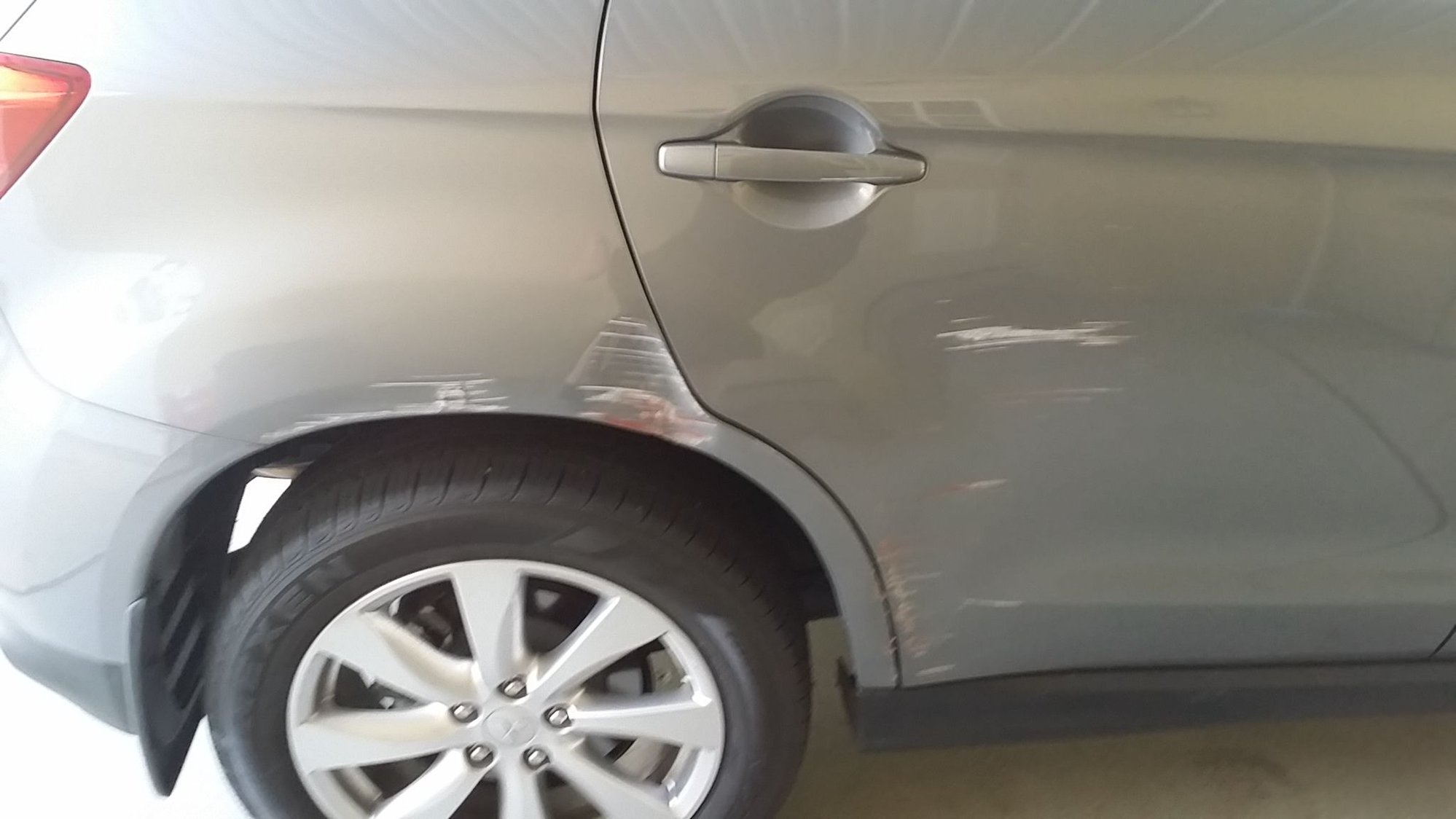

before:

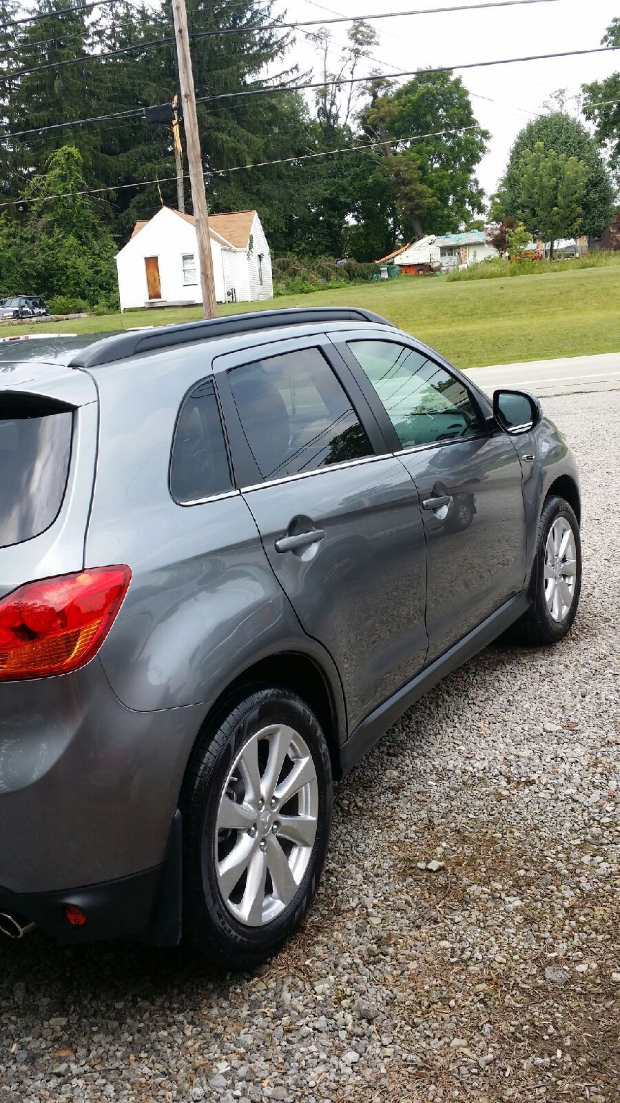

after:
$795. im glad to have friends that are bodymen and plumbers!

Firstly,
Glad to hear you're back in the fold.
But, I'm sure you found a way to managed "the suffering" with that 268hp.
Now -
That repair looks quite good at this angle. How's it look straight on (like the before perspective.)
But, that price seems steep for a "friend's favor".
Factory match paint by the pint is only $55-75 max if you go with PPG. Plus, a pint of clear coat. I can't imagine it using that much paint to begin with... Even if you hit it with 5 coats of pigment.
Guess, I don't need to ask about his labor/hour.

it looks like it was never damaged.
:huh: that would be at least a $1500 job anywhere else. i wasnt taking a brand new car to MAACO for the $299 special. those werent scratches that could be buffed out.

Oh dear god..
why?
There is absolutely no need to grind down to bare sheet metal and repair like that for just those 1 & half dings.
PDR costs $90.
Then prep, prime and paint (of costs I mentioned above) to just those original areas of blemish.
Granted if you bake the paint in the oven for a hour, it'll cost $200 or so. Still wouldn't cost half the price of your friend's. (And, no I'm not talking about letting Maaaaco do it.)
But, NO for $1500.. when there's no structural damage, just some warpage in the sheet metal.
Okay look, I'm not trying to ruin your holiday weekend.
But, please next time get a few more quotes when it comes to body work.

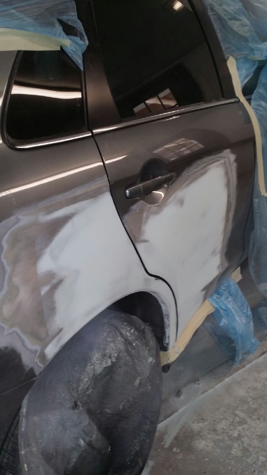

I have no doubt the prep that went into that repair will last. It looks good.
But, was it necessary? Please compare the original photo of damages and the photo of the "repair area".
It grew! There's about a 4" tall dent right about the wheel arch right at the door seam, now compared to the 2nd photo - they've prepped & feather all the way up to the belt line and then some.
It's charging the customer more "work-hours" for something that could have been done more efficiently and without grinding off SO much of the original factory e-coat, primer, and pigment...
Plus, there's no photos of the dent(s) being pulled back out.
Just a large area that's already "filled" with plastic(bondo) and primer-ed.
In fact, I can see a fairly distinct area where the filler is thicker right at the area where the original dent is located.

i don't think the "before" photo clearly shows how bad it was - i guess the photo looks like some minor scrapes. angle of the photo and color of the car don't help my case. in reality, it was the OS vs. a concrete block wall. it already *was* down to bare metal before any repairs! its feathered so it *blends* in and doesn't look like a repair. you would never know anything was ever wrong with it.
perhaps body work is cheaper in Dallas with illegal, err... i mean, undocumented workers, but i can assure you i got a screaming bargain. i had a similar, but slightly worse accident in a previous car when an old lady sideswiped me while i was parked. it was well over $3000 (didn't have to pay for that one, though )

As far as going down to bare metal ...bondo doesn't like to stick to paint as well as "properly " sanded metal . I very seldom use a bondo over painted surfaces , spot putty yes.
