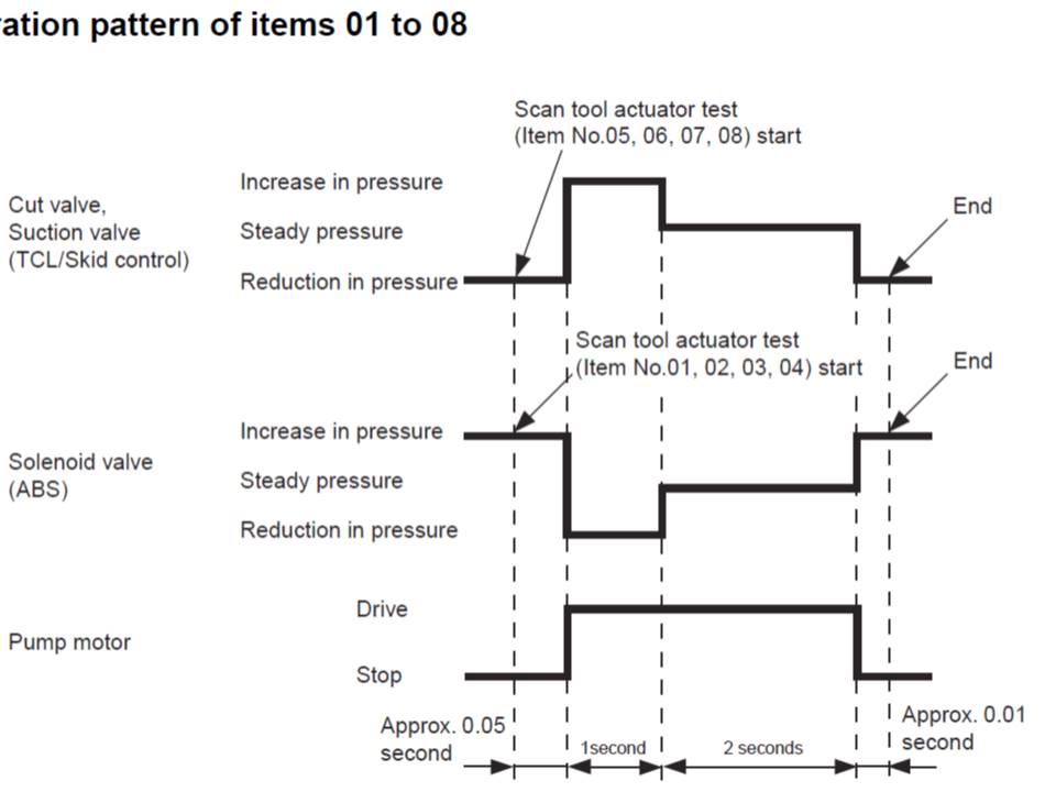

UPDATE: Disregard my question, it could have not happened because the system went to a fail-safe mode.
Great idea EXCEPT - "When ASC-ECU is disabled due to the fail-safe
function, the actuator test cannot be performed." And it is in fail-safe mode.
ASC is off and the dash switch won't turn it on due to failsafe. Everything right now seems to point to the ASC-ECU and possible the hydraulic portion. C2200 and C1200
