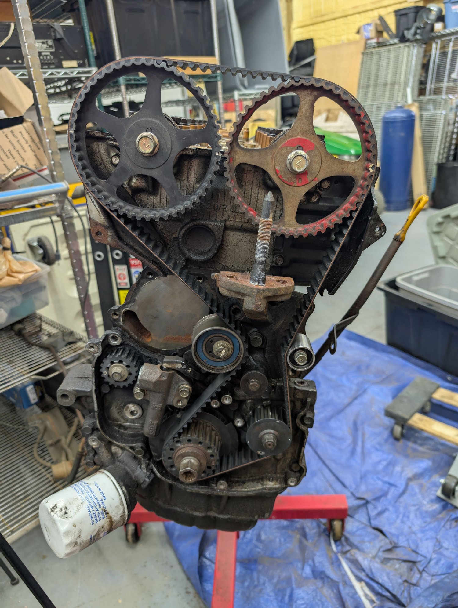

UPADTE: Got it figured out
Alright so after trial and error here are some my findings on how to get this long block timed with evo parts.
**The goal of this is to be able to use adjustable cam gears and fluidampr, as well as a better timing belt.**
Ignore these cam gears, they are dsm gears i had laying around.
I'm also doing a balance shaft delete, so I didn't mess with any of that, but it looks like you could use the all evo stuff here as well.
Everything with teeth needs swapped out with evo ones. oil pump,crank, and cams.
Use the JS tensioner and tensioner arm, but evo tensioner pulley.
For the belt, use a Neon SRT-4 belt. I plan to use the gates racing version with the kevlar reinforcement.
Use the idler pulley from an EJ subaru. part number in picture. (the EJ idler uses and m8 bolt vs the JS m10. The trick here is to install a thread adapter in the block m10x1.25 to m8x1.25. Use red locktite)
Amazon Amazon
The timing marks on the valve cover won't line up with evo cam gears. but my plan is to degree the cams anyway. if i find a good way to make new timing marks, i'll update the thread. it will be a while until i fully build this engine, just wanted to give my findings on the timing components.
