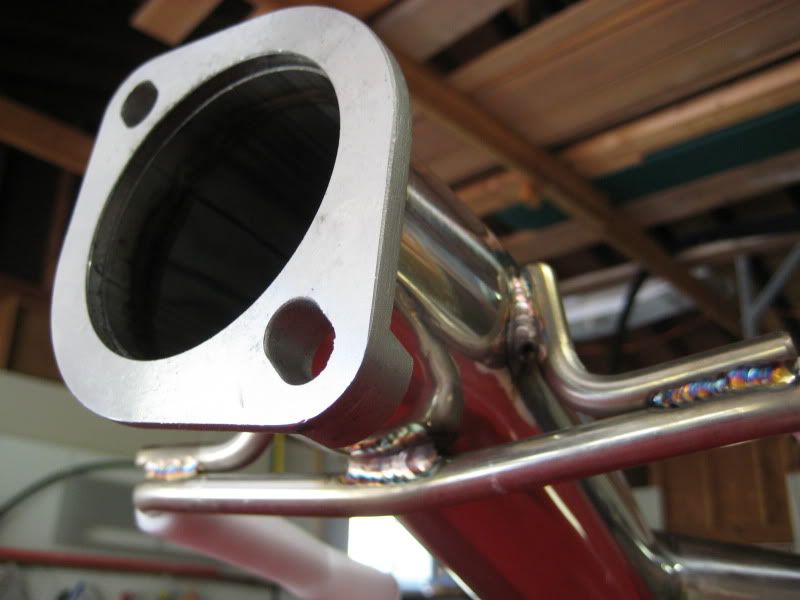

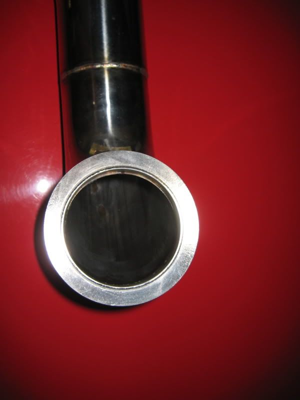

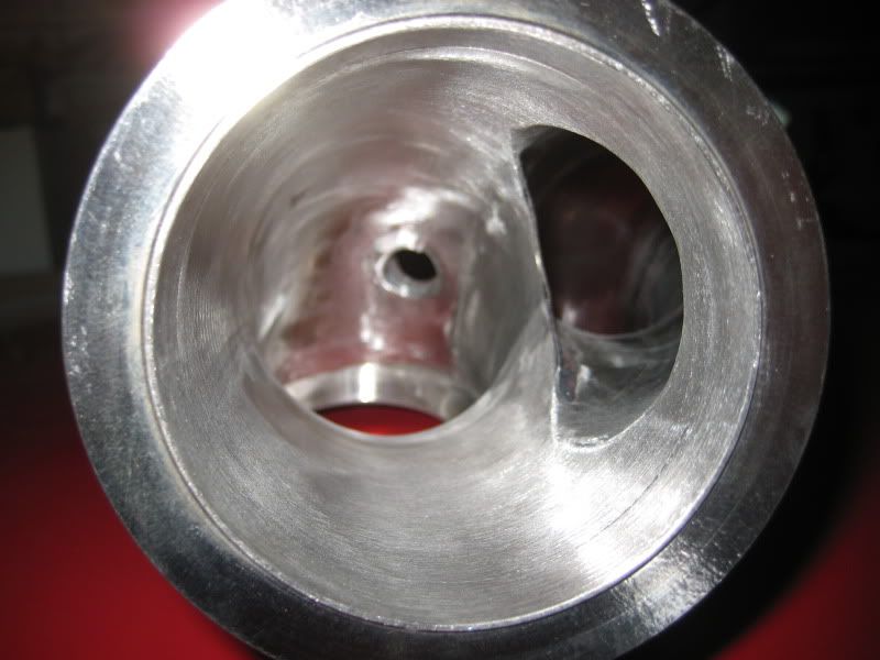

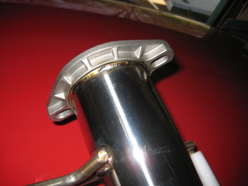

Things are getting moving. I'm finally starting to collect all the parts that are going on the car when it's down for the new motor. This year's upgrade list has kept growing and growing as I think of new things that I "need" to make the car faster.

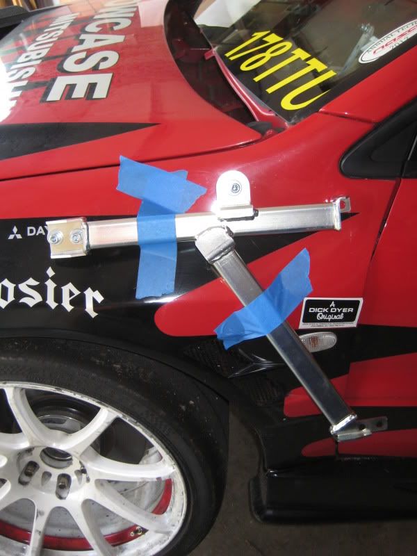

Here are some Nagisa front fender braces that will be going on to stiffen up the chassis a bit:
Hmmm . . .they didn't come with mounting instructions so I winged it. It doesn't seem to be stiffening the front up at all. Maybe I'm mouning it wrong. . .

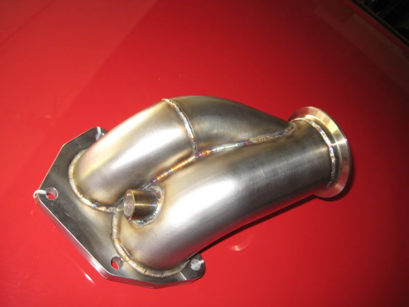

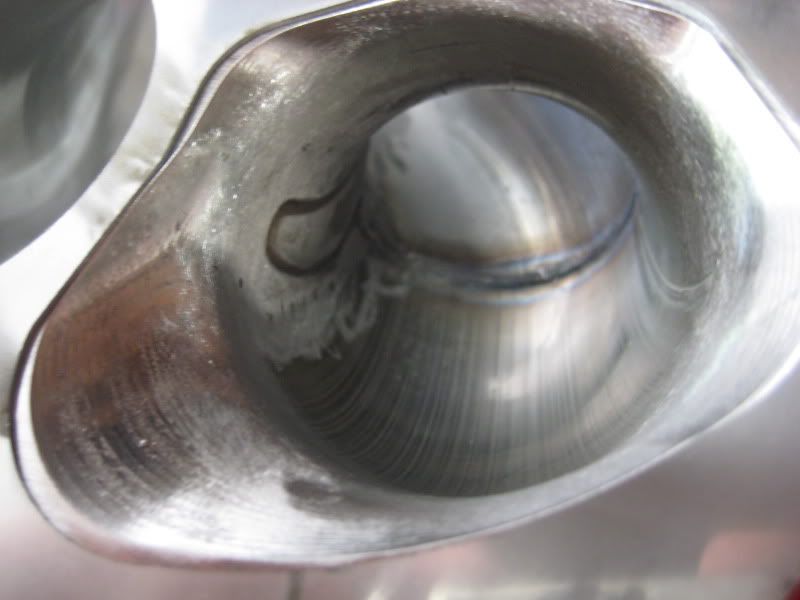

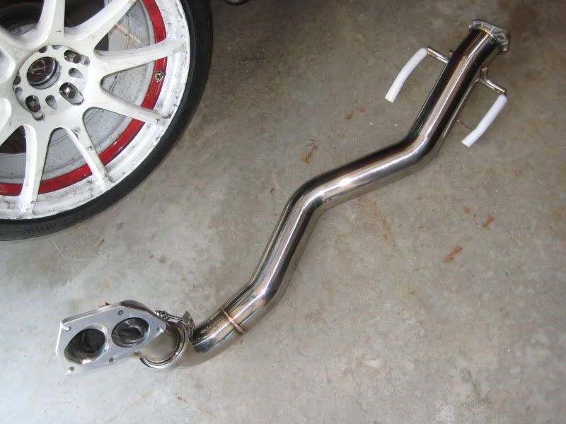

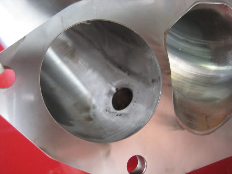

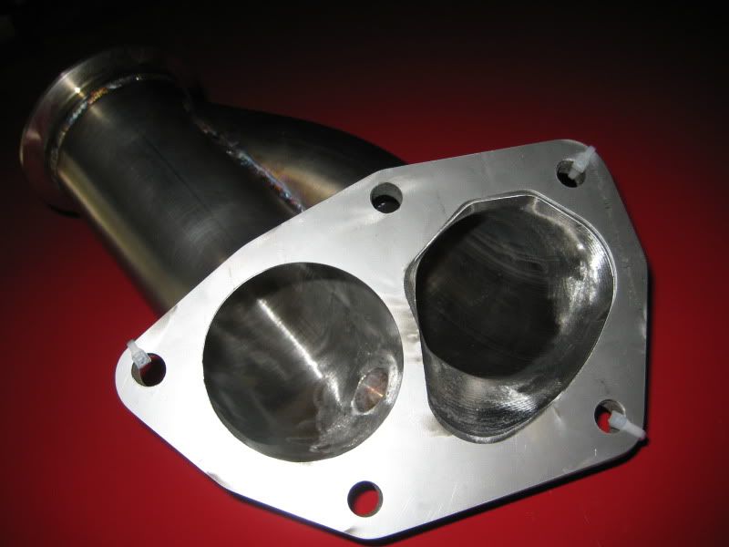

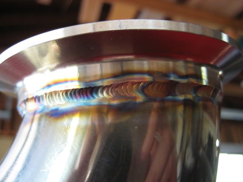

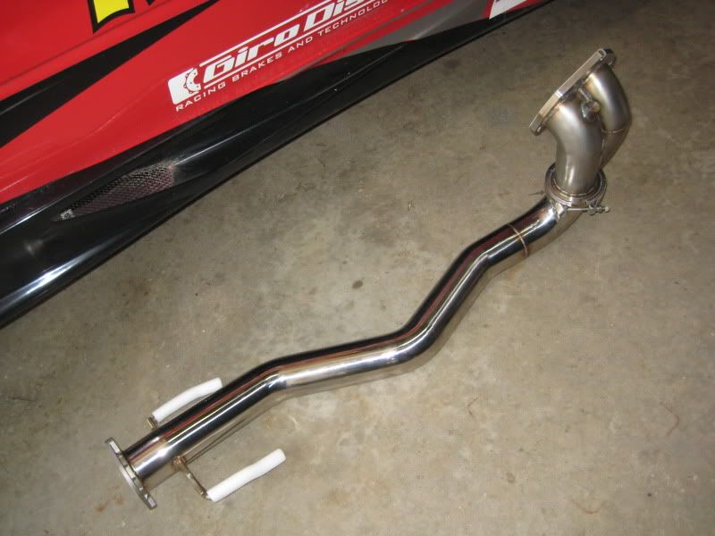

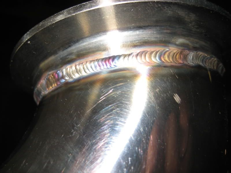

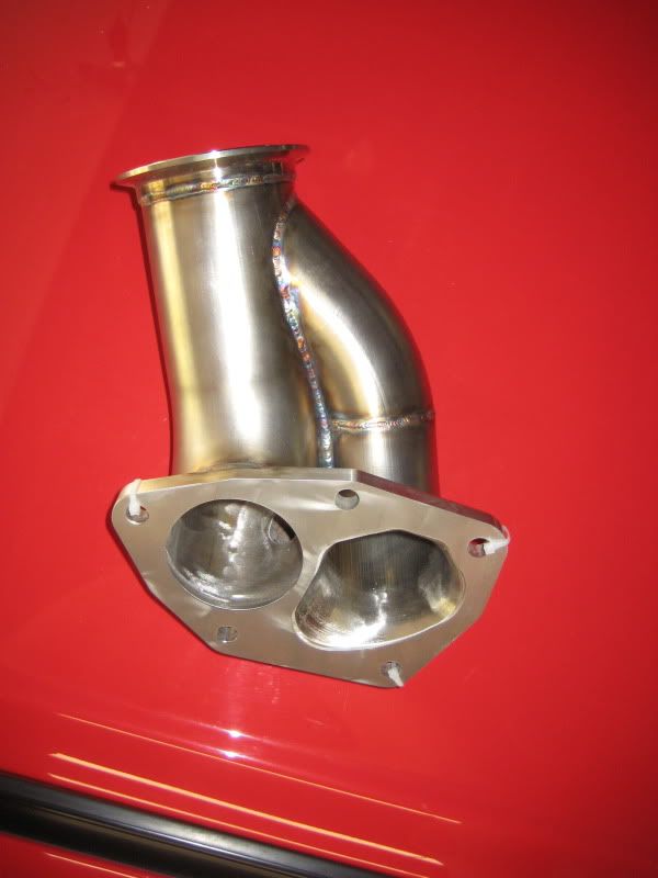

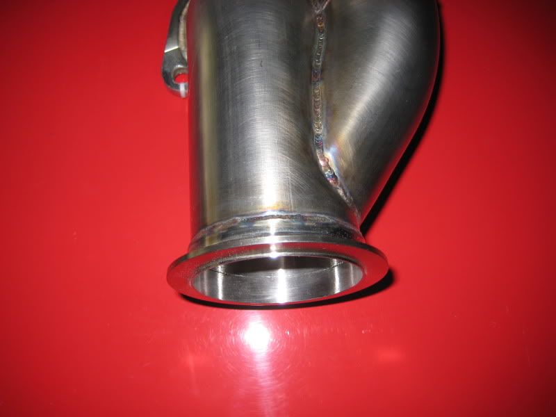

My new CBRD V-Band downpipe/O2 housing combo:
The exhaust components are now on their way to way to Swain to get coated in Swain's White Lightning exhaust coating. I will be testing the CBRD V-band O2 housing and downpipe vs. the stupidly expensive WORKS units I have been using over the past 6 years. The WORKS exhuast pieces have worked very well and made great power, so it's going be tough for the CBRD units to top. We'll soon see what happens, and Chad knows I'll be honest with the results.
