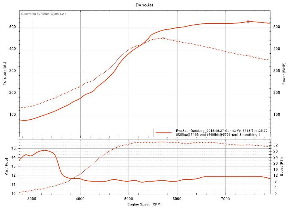

Heres a update for you guys wanting to know more about Nick's progress. Last night we did final touches, but i know theres more in the car yet.
I know a EF4 can run more then 32psi out of the top end, so I sent Nick on a chase again to find some bugs. I suspect something funky with the wastegate actuator.
90% WGDC and we only got 32psi uptop. I also asked him to leak test the car again also just for reassurance.
Heres what we got now which is basically done, but if i can get the boost up, the car should make more power then this. quite a bit more.

So he is making 525HP 449tq on a built block with a MAP EF4 @34lbs of boost? That seems awfully low. Does this not have any timing in it?
