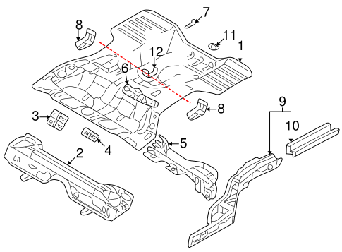

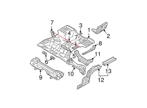

I know it's been a while since this build started and I know that it's been months since anything was posted(hope everything's ok), but I was wondering if anyone has considered using the outlander rear floor pan to safely use the outlander rear suspension? Earlier into this thread there were concerns for the outlander rear suspension tearing off if it was just welded on to the stock floor. I found diagrams of the lancer rear floor and the outlander rear floor. I think they look pretty similar. Doncarbone did mention the option of using the outlander floor in his thread. This is the lancer floor.
This is the outlander floor.
What do y'all make of this? The site I got the outlander diagram from has the floor for sale at ~$300. Might cost a little less if you went to a junkyard. If these can swap out, then this may open a huge door of opportunity of an awd swap for the lancer community. Credits to doncarbone for initially finding this info.

You likely could use the complete Outlander rear floorpan. If you're going to go through the trouble though I would recommend just using a complete Evo 5-9 rear floor pan. The Evo suspension is designed for motorsports and will yield a better handling car with much more aftermarket support for stuff like swaybars and bushings.
